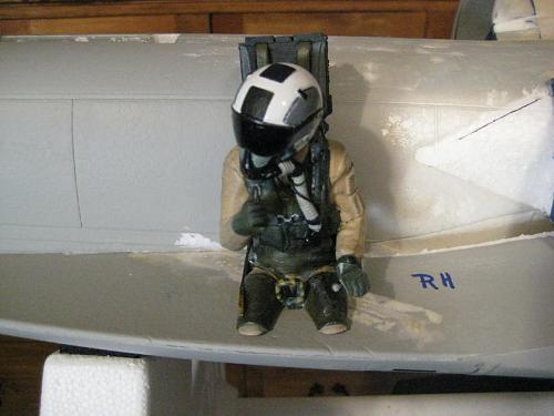

                                  If you writing about Max Grueter's https://www.cgtrader.com/maxgrueter & https://www.thingiverse.com/thing:1761697 work on cdtrader; I have purchased a few of his designs and those are great. I have used his Jet Pilot body on both my F-4 and F-18. Very scalable and simple to mod. I have his RAF and Mustang pilots and the B-17 Crush Cap heads. Anyway, well worth the price of admission IMHO. Best, LB

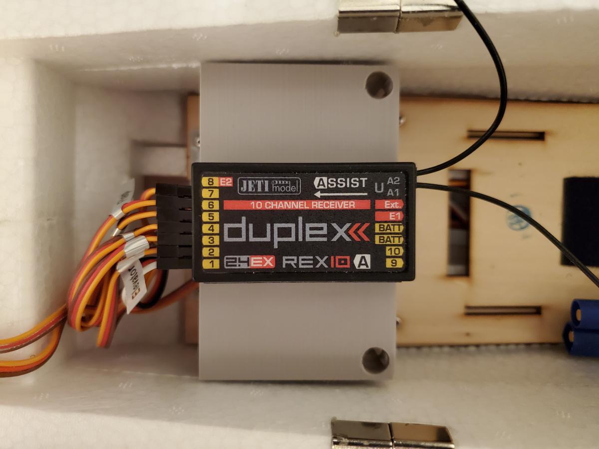

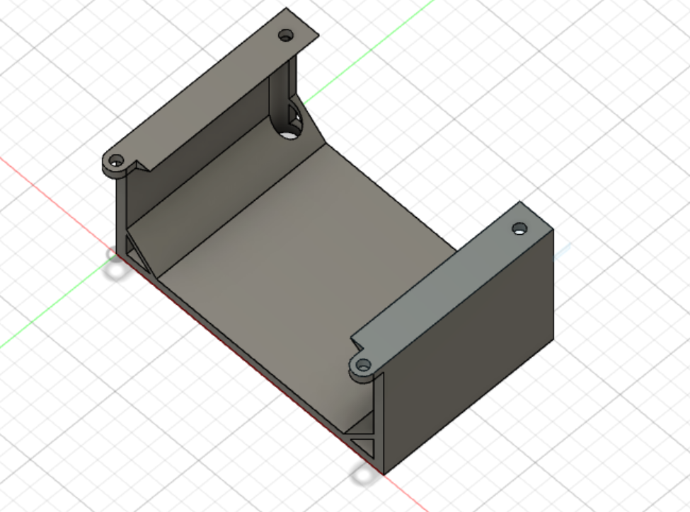

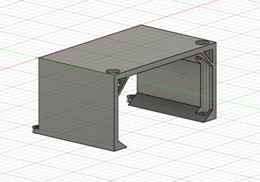

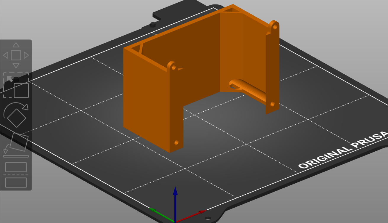

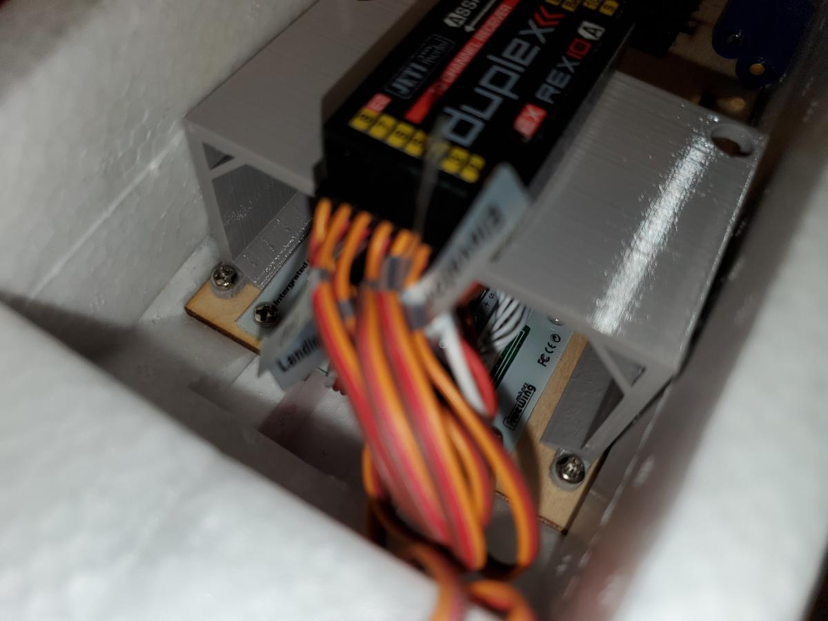

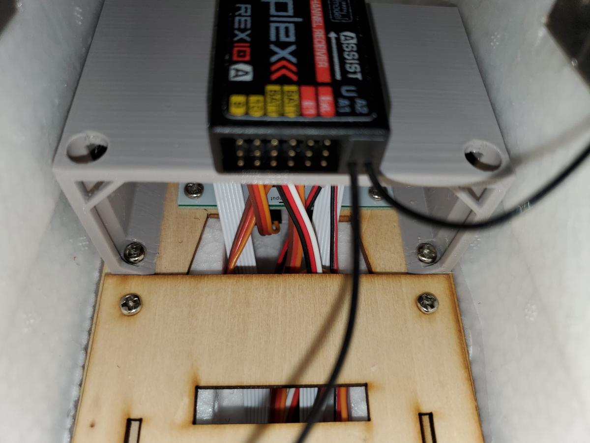

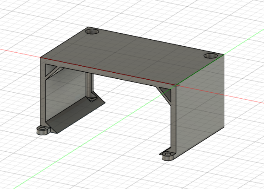

                                      I started working on a Receiver and/or Gyro Platform (there's room for both) yesterday just for fun and I used the Freewing Avanti S as a test bed. Since I'm still new to 3D design and printing, fun random custom designs are great practice for me.
                                      I designed it to be secured with four screws and therefore easily removable, and it uses the same size screws that the battery tray uses. The rear of the platform sits against the front of the battery tray lip for a bit of added security. The unit sits over the control board, so it cleans up the look and the wiring reaches rather easily. The rear screw holes allow easy access with a screwdriver from the top cutouts.
                                      I printed and installed the platform this morning, and it fits well in the Avanti. I haven't checked for fitment in other aircraft, but it would obviously depend upon the battery compartment dimensions and location of various components.
                                      I'm not sure if anyone would even want this available to them , but if so, I can consider uploading it to Thingiverse or another site for download. An alternative RX/Gyro platform isn't difficult to design, but if it saves people time by printing mine then that's a positive thing.

                                        T-CAT, great work, Sir. You have me thinking about a better arrangement for the F-18. I would like to move all the PnP items lower in the groove and move the battery tray aft and use the battery better for CG. I just dislike the idea of adding 'dead weight' to achieve proper CG. Possibly some type of threaded adjustable tray where the battery is fixed to the tray and only the tray is moved. Could be reinventing the wheel, however. Best, LB

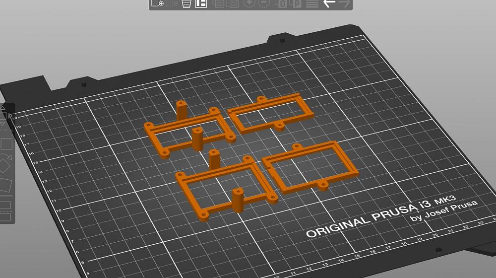

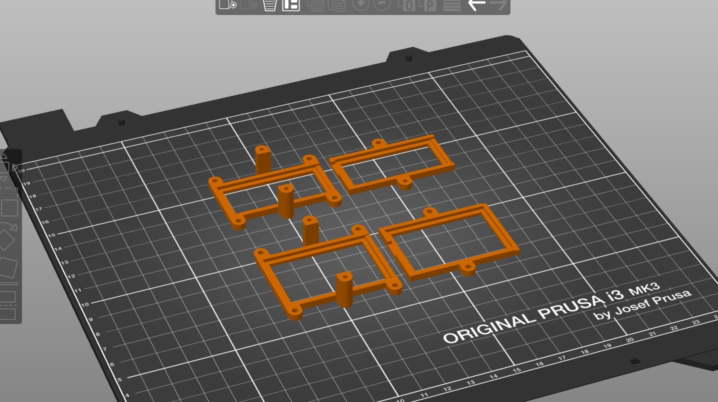

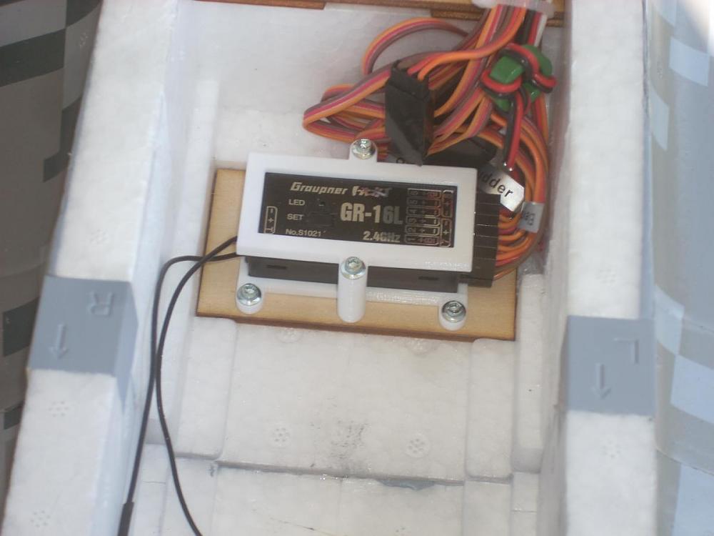

                                          I did something similar for my Graupner receivers. And the new Mig even has a wood tray already glued into the forward section so it was easy to secure. I made these mainly for my turbines, but works good for the foamies too!
