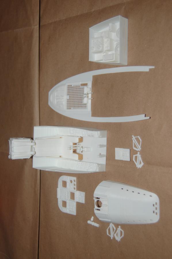

                        • Finally got my parts in. I still need to order the Canopy Bow files. The HUD set to the upper left did not fit the coaming. The pieces that are above it did.The base ejection seat sits on a flat base; slightly different than the one in thread. That's no biggy though. It can be built up to be even with the control panels. The 1/10th scale JHH pilot is too big. I 'm in the market for a 1/11th/ 1/12th scale full body jet pilot. Anybody know where I can get one from? Anyway, overall the cockpit set is sweet and would be a nice addition to your jet. I'll post some pic's when I get it together. Can I get the exact page in Thingeeverse where I can find additional weapons for Freewing Jets?
                          • Originally posted by Dustman View Post
                            Finally got my parts in. I still need to order the Canopy Bow files. The HUD set to the upper left did not fit the coaming. The pieces that are above it did.The base ejection seat sits on a flat base; slightly different than the one in thread. That's no biggy though. It can be built up to be even with the control panels. The 1/10th scale JHH pilot is to big. I 'm in the market for a 1/11th/ 1/12th scale full body jet pilot. Anybody know where I can get one from? Anyway, overall the cockpit set is sweet and would be a nice addition to your jet. I'll post some pic's when I get it together. Can I get the exact page in Thingeeverse where I can find additional weapons for Freewing Jets?

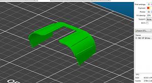

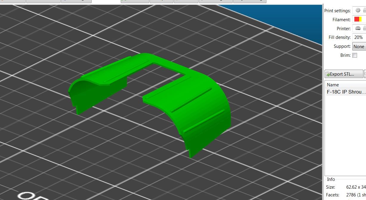

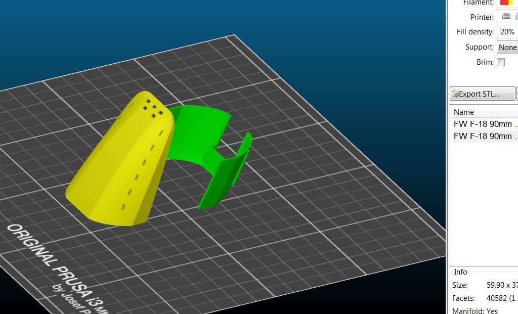

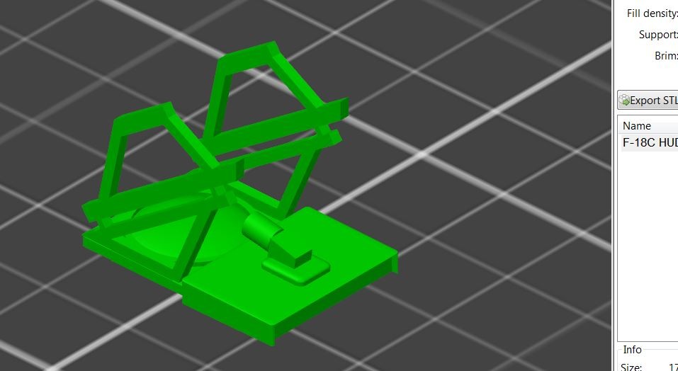

                            DM, The Full Coaming/Shroud you have printed is Radar-Guy's design and has it's own HUD that I believe it is in his file set. The shroud I designed is the forward (HUD) portion only as I am going to cut the OEM to fit my design. It would appear you have both HUD sets and Radar-Guy's shroud. The ejection seat was a full height design with the bottom and was then 'cut' in Prusa slic3r to fit in the 'cockpit tub to canopy height' with a small margin of error. If you build it up too much, you'll find it hits the bottom of the canopy glass. In "Thingiverse" search Freewing F-16 and Freewing F-4, you get the idea, and you should be able to find the ordinance you need. Those might need to be 'scaled' up or down to get the match for Freewing F-18C. Not sure. Best, LB
                            Click image for larger version  Name:	F18 Shroud Capture.JPG Views:	0 Size:	121.7 KB ID:	220952Click image for larger version  Name:	HUD 3.JPG Views:	0 Size:	54.7 KB ID:	220953
                            • Don't know what I am doing wrong while in Thingeeverse. When type in Freewing f18 I get the home page with artist to follow halfway down the page. Also, LB are you going to do a file for the OEM shroud/ coaming you are for your HUD? I'll have a pic for you in a couple of days on how the parts fit. It difficult for me to see how DD coaming over the instrument panel from your picture in the previous thread. The files listed below are the remaining files for now I need DD to do for me. For some reason I was not able to get the GBU 38 file to load. A message came up saying it exceeded the limit by1.91 MB. for file size. The one file I can't find right now I would also like is the center pylon by DD.

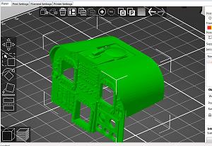

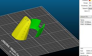

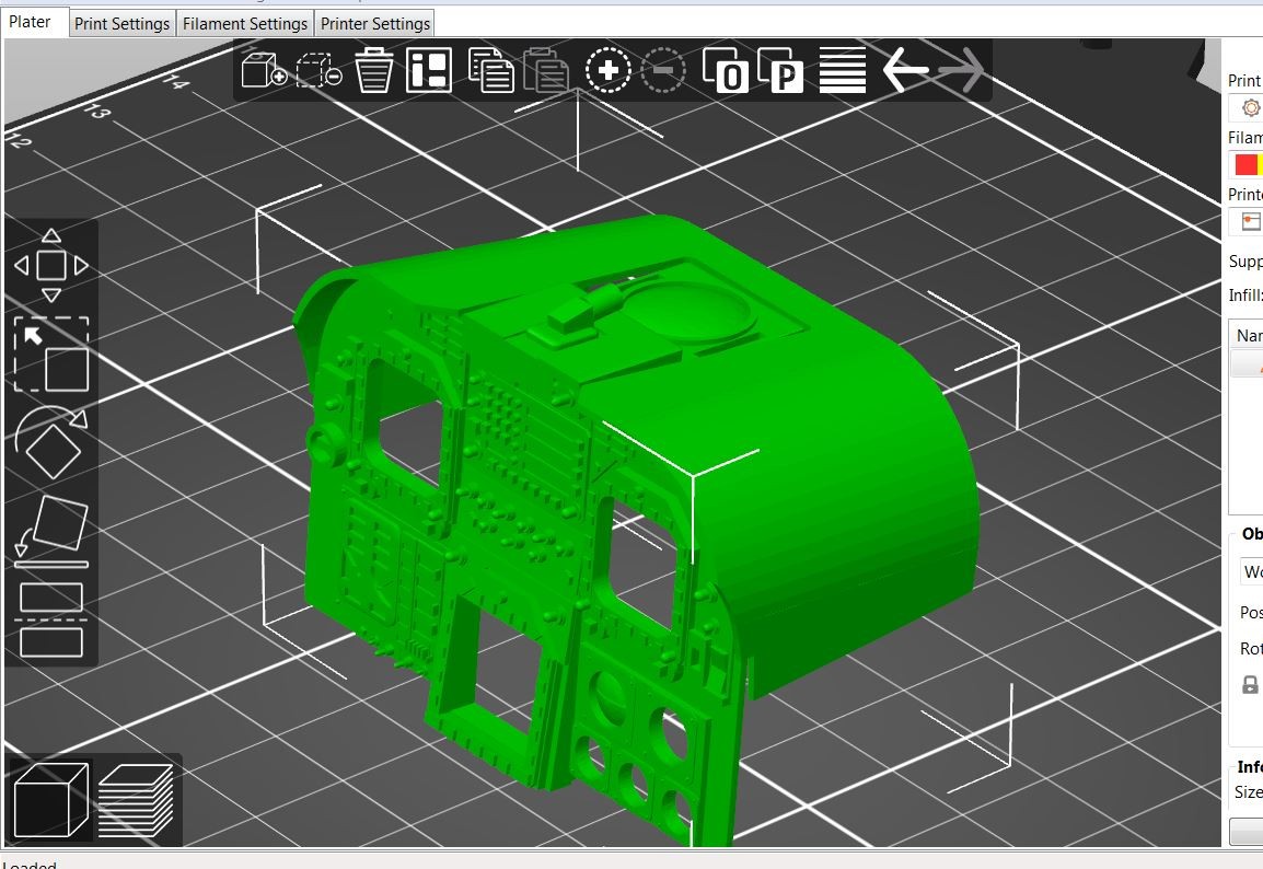

                              • Dustman, Here are some screen captures that might help you. Remember that Radar-Guy's Shroud/Coaming requires that you cut off the foam forward of the IP. RG's HUD Assembly fits his Shroud/Coaming as does his Forward IP. If you printed my version of the HUD and Forward IP, these will not fit RG's Shroud. My IP Shroud requires the use of the OEM Shroud, though it is cut back to match the 3DP Shroud. Best, LB
                                Click image for larger version  Name:	Capture Franks Shroud.JPG Views:	0 Size:	108.4 KB ID:	221454Click image for larger version  Name:	Capture for picture HUD to Shroud.JPG Views:	0 Size:	184.1 KB ID:	221455Click image for larger version  Name:	Capture IP and Shroud.JPG Views:	0 Size:	114.2 KB ID:	221456
