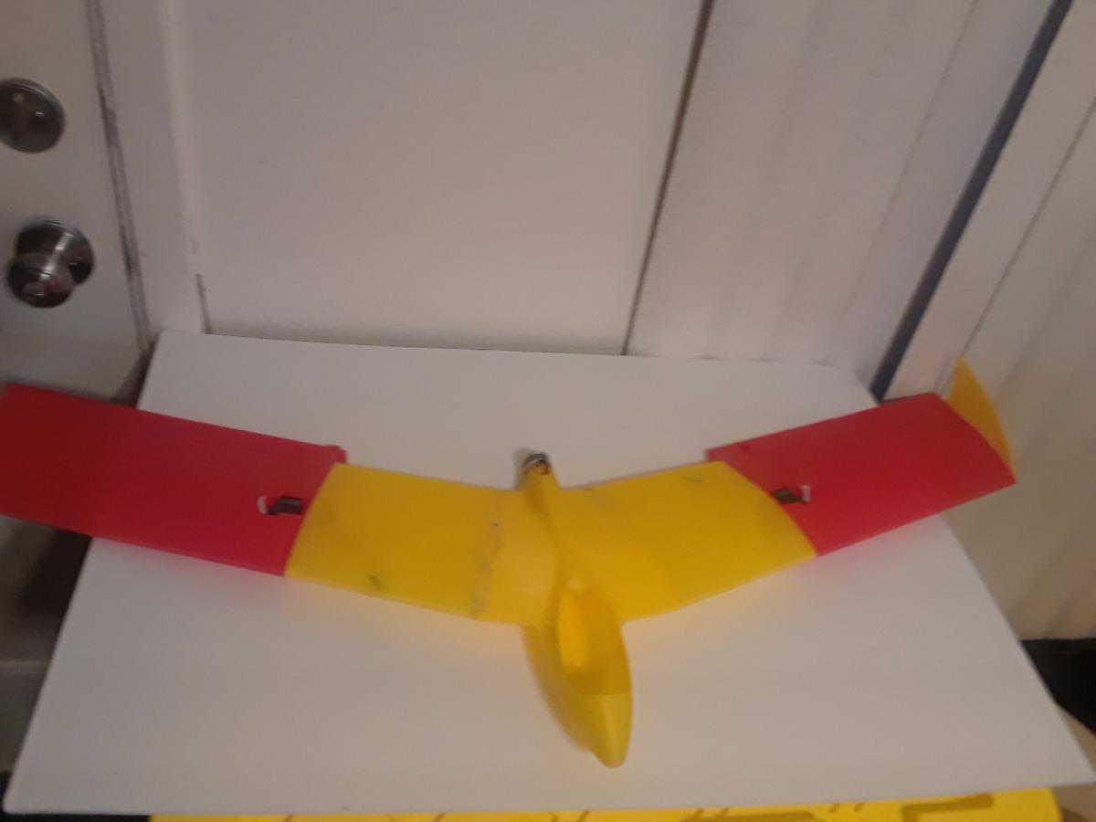

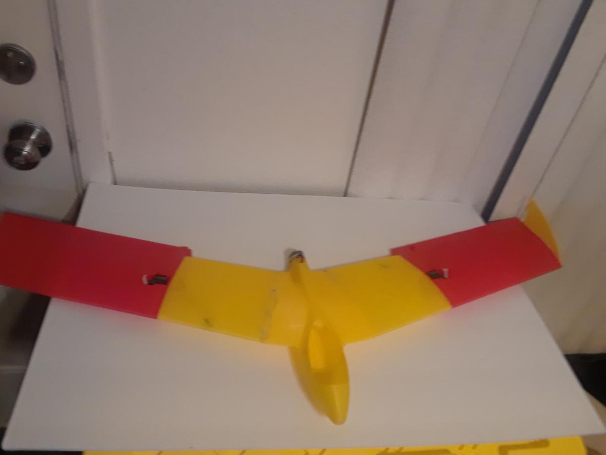

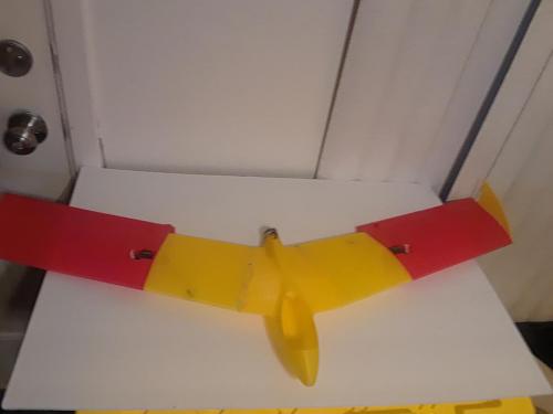

                            Click image for larger version  Name:	20190507_202052.jpg Views:	0 Size:	40.0 KB ID:	193451
                            Using Ender 3, not the Pro, with a glass bed and some of the recommended 3D printed bits for filament guide, cable chains, fan cover and knobs n the Z axis and extruder.
                            (the only really important change from stock out of box is the glass bed)
                            Well, its not the Mig, but I printed a flying wing from thingiverse using Inland PLA (which I find works well but others say is useless)
                            All settings in Cura:
                            I pushed temp up to 215C, 60C first layer for print bed, then 50C. 0.8 layer height, slowed it down to 30 printing speed, told it the line width is .5 with a .4 nozzle, to push more PLA out and get really good layer adhesion with the thin layers printed hot. Fan speed recommended in the Thingiverse instructions is ZERO I had issues with that and went to 30.
                            Some parts wanted 1 top/bottom layer at 0.12mm layer height and I used 2 at .08mm
                            Ailerons for the model failed and needed 3 top/bottom layers to make them work. Pretty stiff ailerons at 3 layers + 20% Tri-hex (triangles and hexagons) infill.
                            Canopy failed due to an issue with feeding filament. Got some dirt in the nozzle. And hasn't been retried yet. I have the printer doing a 36 hr print of a dice tower for tabletop RPG at the moment.
                            You can see some blue n wing to fuselage joints. That's tape that got stuck with the CA. It will buff ff with a rag dampened with acetone.
                            Experiment printing a couple of the catapult gliders and other small aircraft off of Thingiverse. When you can get the eagle to fly well while looking like its wings flap you have the printer set up right.
