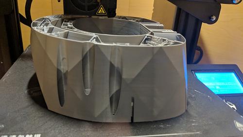

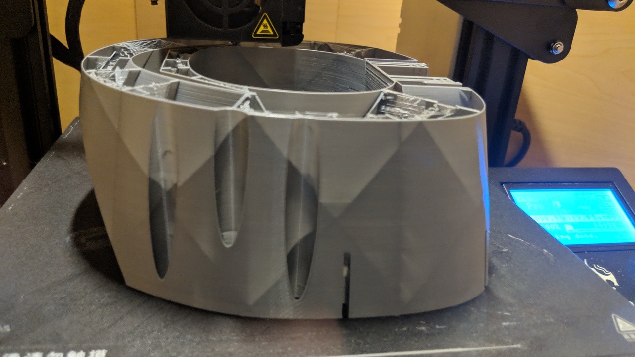

                  Back to printing my Sabre. PLA+

                    RCJD, Those are beautiful parts, sir. Best, LB
                      #530
                      Yes indeed, im in the process of testing filacube filaments. They call it PLA2 so prints much hotter than PLA (225 vs 210), and took me a little while to finally get the printer calibrated for it. Dropping the retraction distance and Speeding up the retraction a bit as well. The results are so much smoother and cleaner.

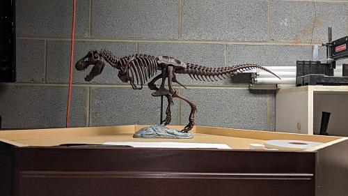

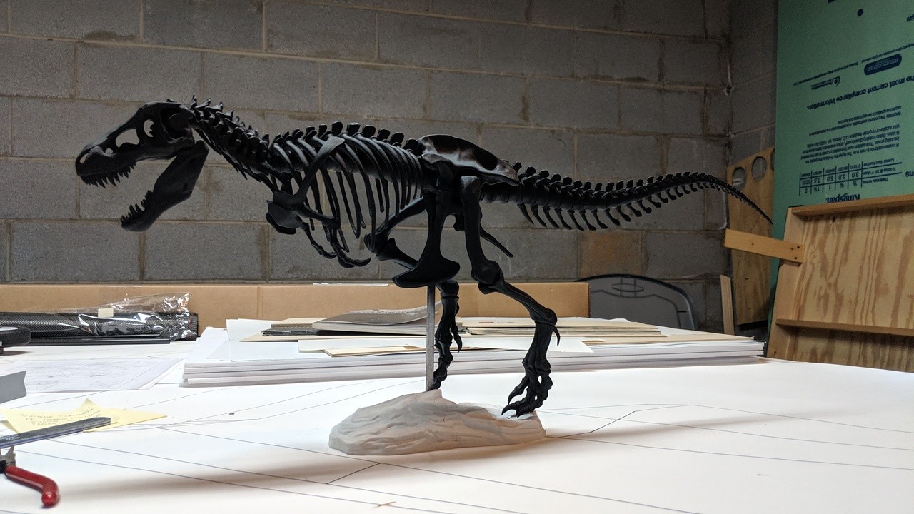

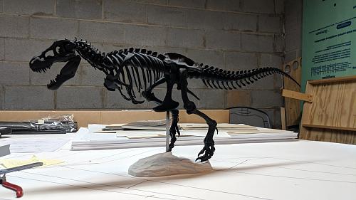

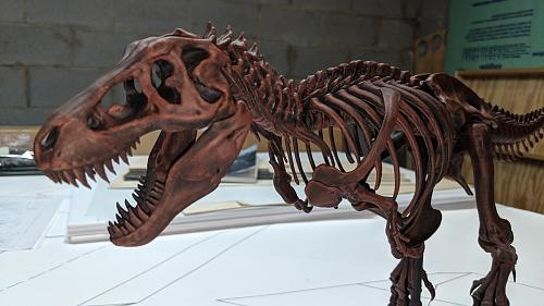

                        Not a plane but still 3D printed. Downloaded from Thingiverse and printed in white PLA. I am now in the process of painting it. The thing is almost 24" long.

                          :Cool:Love it!

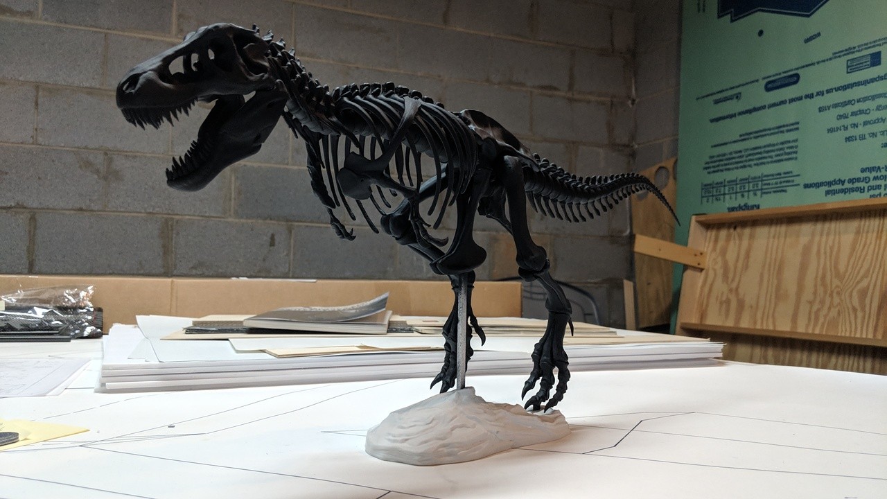

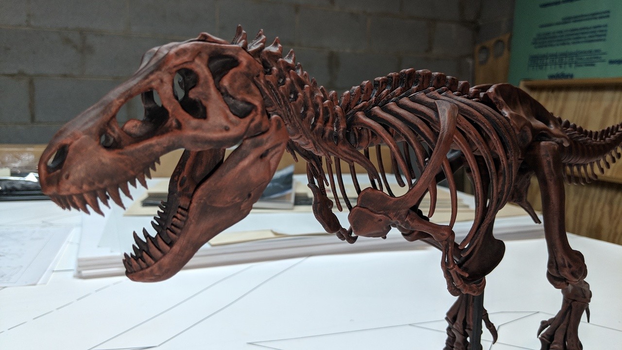

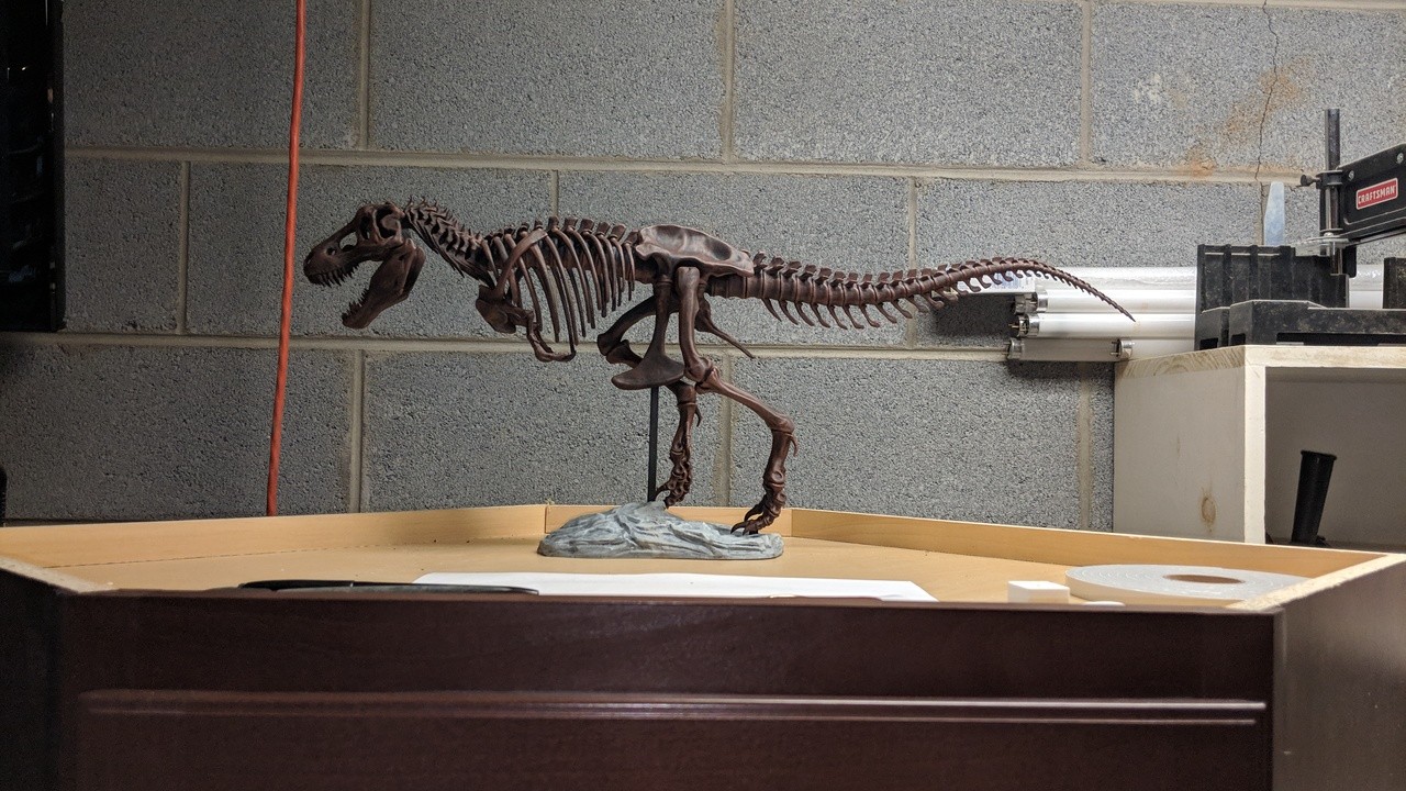

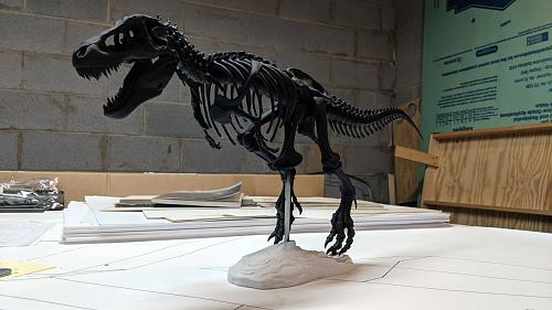

                            All done... I like how it turned out.

                              I can see why you would print that RCDinoDude. That's really cool.

                                    I've been eyeing that file on Thingiverse for a while, yours looks killer, as expected. What did you use to bond the parts together?

                                      For PLA I am gluing things together with the cheap super glue gel from Harbor Freight. The joints are stronger than the PLA.
                                      The brand of the PLA my matter... They are not equal. Even the natural vs various colors within the "Inland" brand I have been using makes a difference in flexibility and strength.
                                      White is weakest stiffest and a "Dragon's Egg" print will shatter if dropped. The natural is the most flexible and seems strongest so far and the "Dragon's Egg" printed with the same settings will bounce.
                                      I haven't done the T-Rex skeleton, but I have been doing a lot of "minis" for tabletop games that will have similar needs if printed in the same material.
                                        #539
                                        Yes, like fhhuber said, I just used CA and a little accelerator to glue it together. I got an Ender 3 Pro and the prints came out very nice with minimal clean up. It is a very good looking model and I was super stoked when I found the files. It was one if those get to know my new printer projects.
