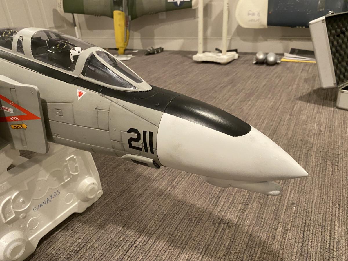

    Well, feeling just a bit "snakebit" with my F-4s these days. I had one, got abut 22 flights on it until I let it get away from me a bit and took it out too far on downwind leg. Got disoriented because I couldn't see it all that clearly, and apparently got it too slow and stalled it turning final approach leg. Totally my fault. Lawn darted it.
    I harvested all the innards of the crashed plane into an ARF Plus plane, same markings. On the maiden, it was flying well, but I got it a bit low turning final leg, "goosed" it a bit to make sure I had enough speed, and looked like it would be a normal landing. Wrong! About 5 feet above the approach end of the runway, it stalled and snapped to the right, landing pretty hard. Nothing damaged on the gear, ESC, all that stuff, but did tear the forward fuselage badly near the cockpit.
    I took it home and repaired it. You probably wouldn't notice it got damaged and repaired, now. However, because of the damage to the fuselage and some crushing of the foam on one side. when I put it together, I knew it was slightly "bent" and would now have to be retrimmed to its new state of being.
    Got a few flights in, including two today. Thank goodness for Flight Modes in my Spektrum transmitter, as I had a lot of trimming to do in all configurations in the 3 minutes I could keep it up flying. Now, although the flight control surfaces (mostly ailerons) show that it is "bent," it still flies pretty well. I think it will be a keeper for the time being, maybe eventually load everything into another ARF Plus someday. But for now, I think it flies well enough to use it as my F-4 trainer and get better flying it.
    A couple pics taken from my local flying field this morning after the flights.
