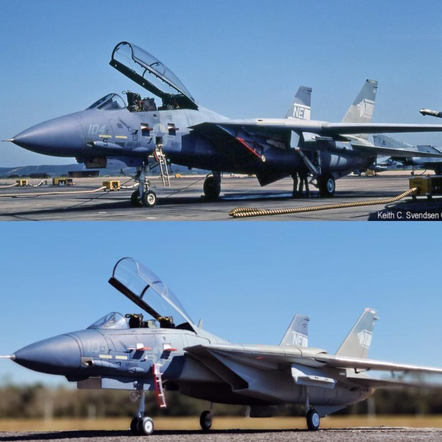

  • krakenreleaser
    Some still shots along with some of the full scale reference photos
  • krakenreleaser
    Just wrapped up our latest project on the Freewing twin 80mm edf F-14 Tomcat. This one was painted after the VF-1 "Wolfpack" F-14 A Tomcat featuring this unique Ferris paint scheme. We haven't seen any model, remote control or static display, in this awesome livery. BuNo 161290, NE 104, circa March 1983. Big thanks to Keith Svensden for snapping the original photos so we could recreate this beauty. There are only a handful of pics of plane out there, so we are super excited to bring this one back to life. 3d printed nozzles, wheel hubs, and pilots were added to customize the look and keep it true with the F-14 A model. Big shout out to T-cat (wheel hubs), the RC Geek (missle plyons) and chrisk83 (nozzles) for the 3d stl files. We also upgraded the power system with the mig 29 fans and escs, so it should rip. Painted two cockpits: one for flying and one with the canopy up for static display. Led twin afterburner kit by Gooniac.
    Maiden this weekend.
    Paint tutorial video below:
