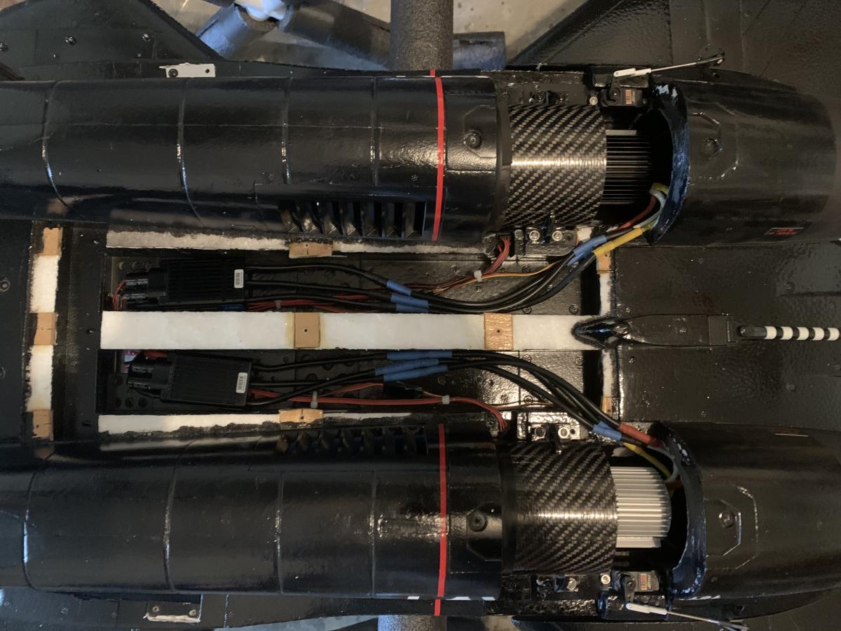

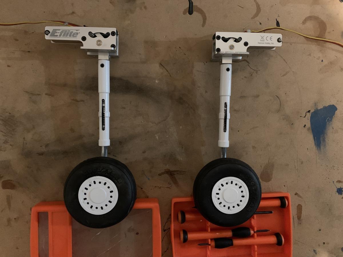

    Originally posted by Gvasiloff
    Just installed a new power system and landing gear. Out with the FMS 2100kv units and in with some Jetfan V3 fans and HET 700-68-2250kv motors. Controlling them are Hobbywing 120a ESCs with 150a burst capacity. These motors are a combined ~350g heavier than the FMS units. I'm coming out a touch tail heavy even with my heaviest batteries (~800g/ea) ALL the way forward! I know it can be flown like this though.
    I also installed the E-Flite 25-46 90 degree retracts with the trunnions drilled out to accept the 5.1mm pins from the stock struts. I added Robart 2.75" rubber wheels and RC Geek 3D printed hub caps. They look amazing!
    GV, great upgrades and modifications to your Tomcat. Best, LB
