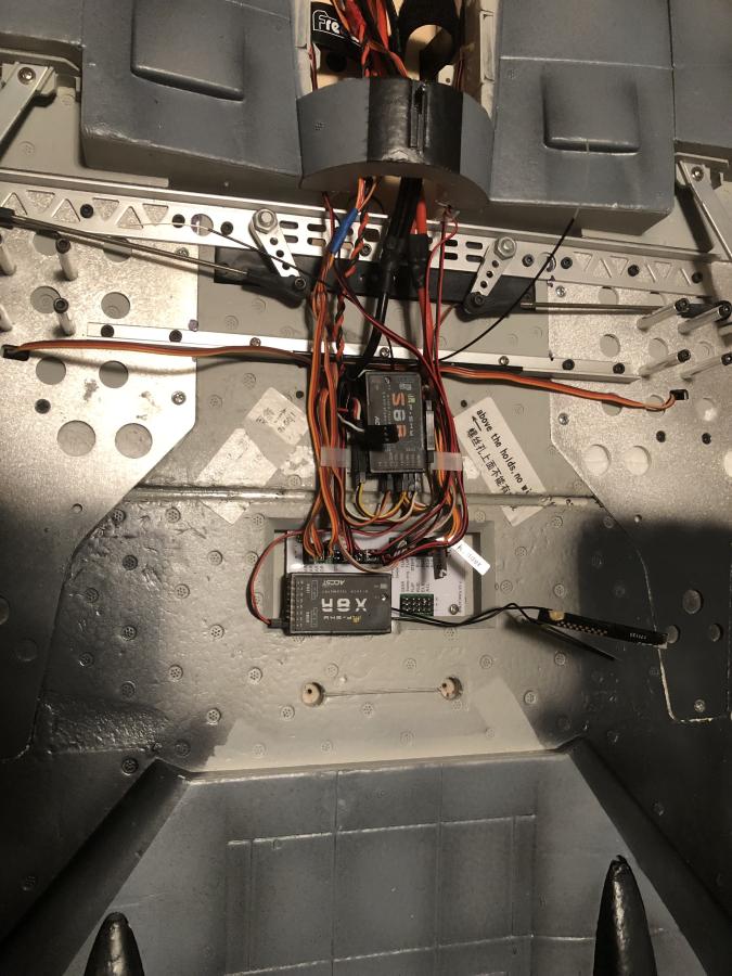

    Thanks for the pics. There is a wire slot in the front half of the fuse. I will continue that slot all the way back to the SW box. I bought the F-18 nose strut because its the same only better on piece construction.After I paint it white I can install the front retract and LED and finish up my wiring from the front section. at that point I can permanently affix my antenna's and do some range testing to make sure I don't have any dual RX interference.

    I made tunnels from the wing sweep mech area through to the nose to clean up wires in the battery area... Top pics are my second F-14, lower is my first.

    Anyway, I started my wire management and rx placement.
    since the belly pan is not used for the ESC’s anymore, I can use that space for wire chase firebooty system. The on / off switch for the firebooty is in between the Phoenix rails.
    I’m waiting for some connectors to show up. I’m going to make tow wire harnesses for the wing servos and lights. This will make changing them out easier and help me keep them out of the way. It will be two 6 wire connectors per wing. +,-, Ail sig, flip sig, and the led+-.
    I still need to mount and run the front retract and led.
    getting close, that’s for sure.

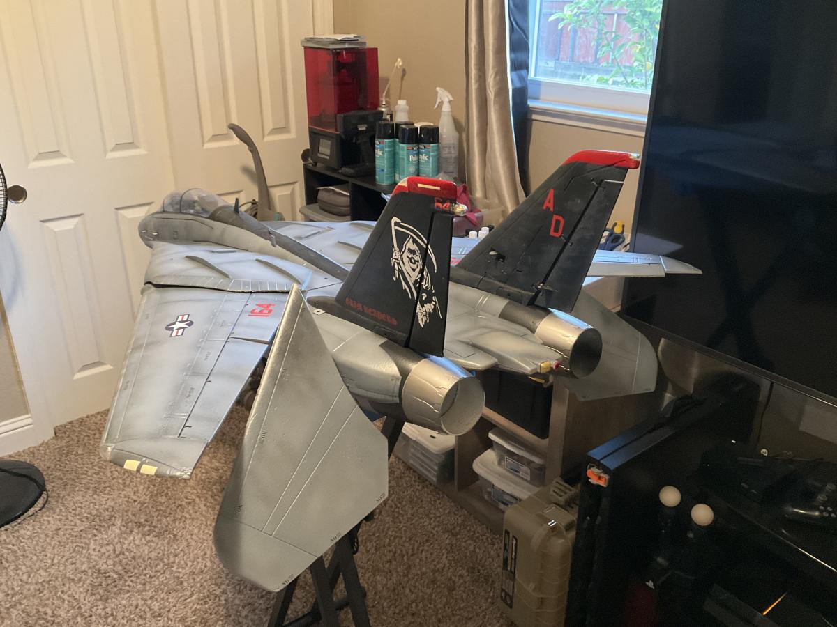

    Originally posted by Gravythe clown

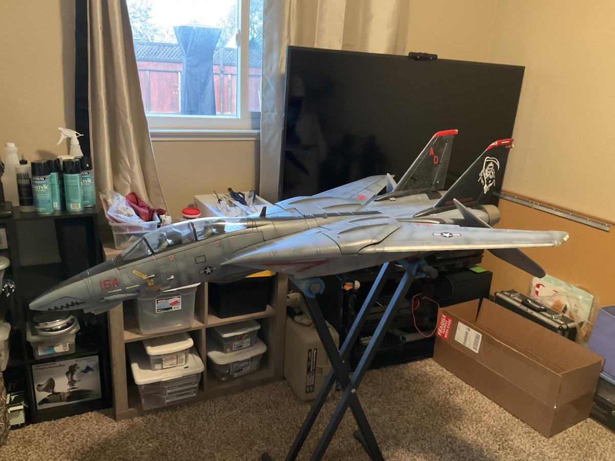

    Got it decaled and clear coated. I use a combination satin and matte. I’m happy with it and will start now on the reassembling. I still need to finish the spoiler wings. That will be my project this weekend.
    Gravy

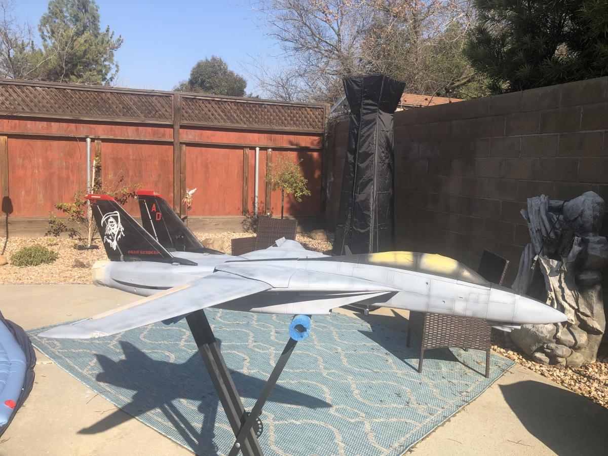

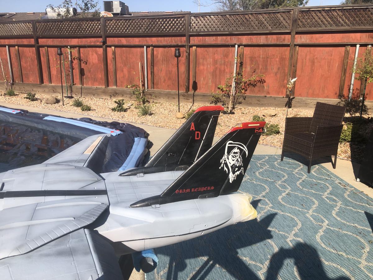

  • Gravythe clown
    Gravy
    commented on 's reply
    GtC, Very Nicely Done, Sir. Smooth operation, scale appearance and function. Bravo Zulu. Best, LB

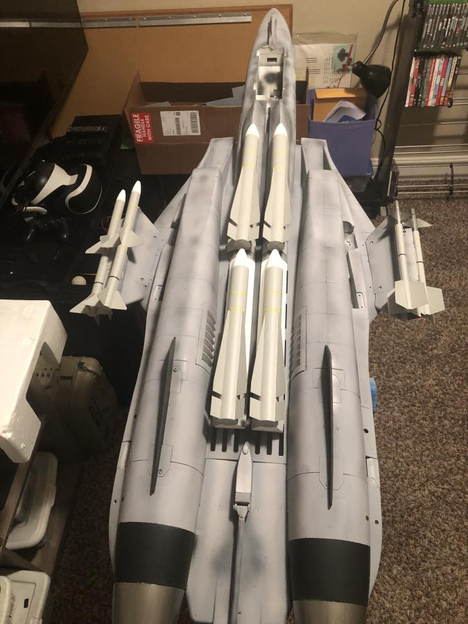

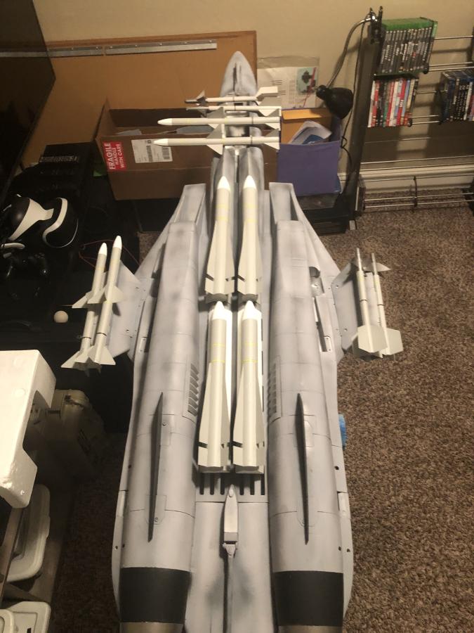

    Got my second load out set today. Now I can have her set with full load out.
    also got my left wing spoiler complete.
    need to paint the back Phoenix rail section to match the front and add some wooden braces to secure the back section.
    Gravy
    Update pics. Gravy
    GC, love the 'greys' and all the pre-shading work. Bravo Zulu, Sir. Best, LB

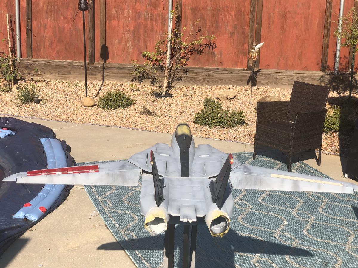

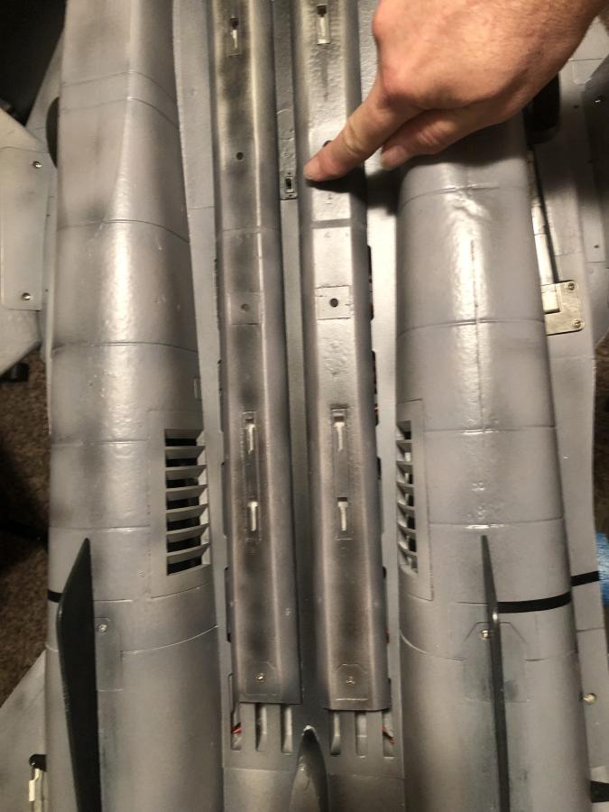

  • Gravythe clown

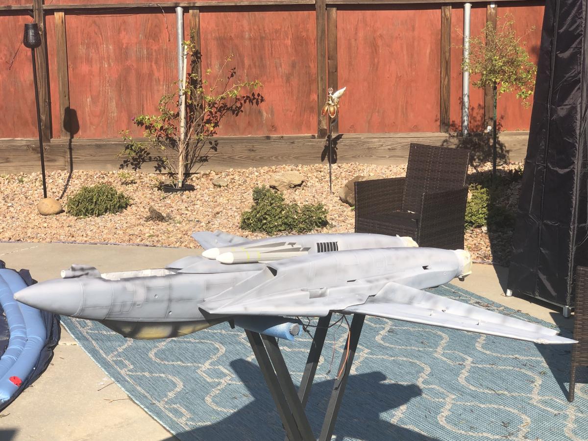

    Update pics, base is all done just some small areas to paint left.
    back of engines that show before the nozzles.
    area that is where the wings site when swept.
    leading edge of wings.
    then It’s clear coats and decals.
    Gravy
