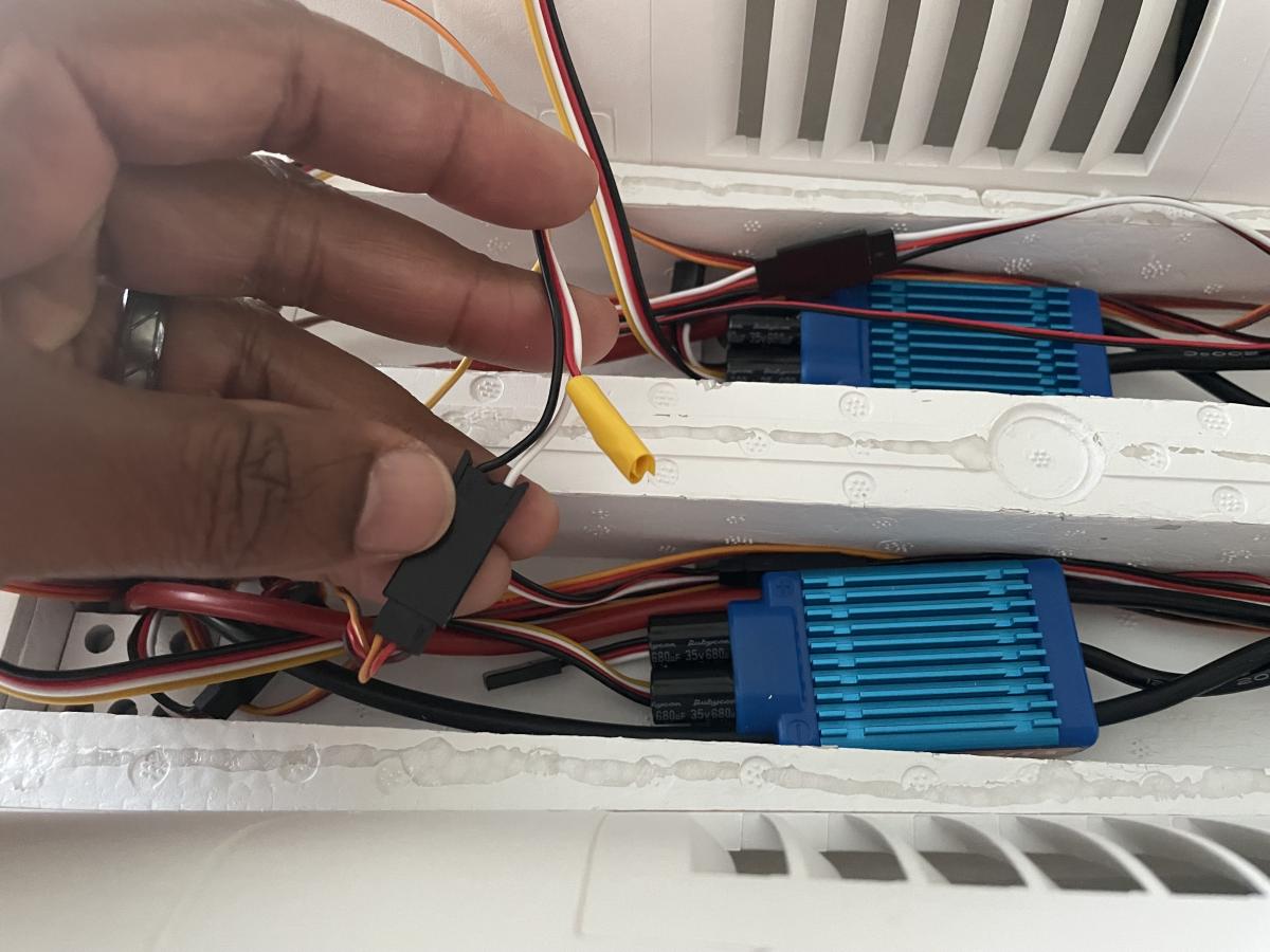

    How to connect 2 ESCs y harnessed into one receiver.
    Ok fellas… I’m stumped and need some help on the above statement.

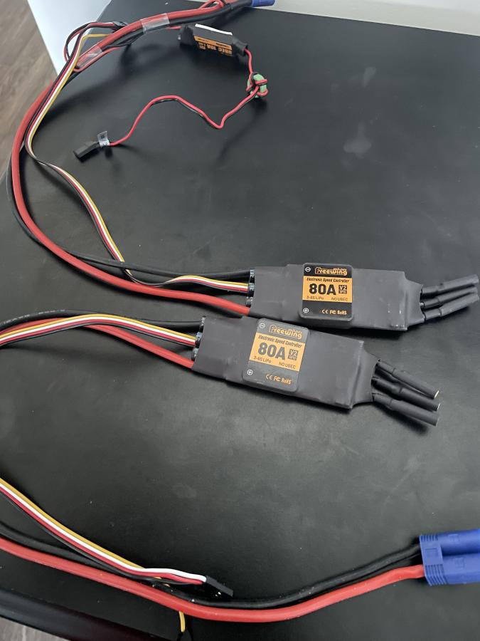

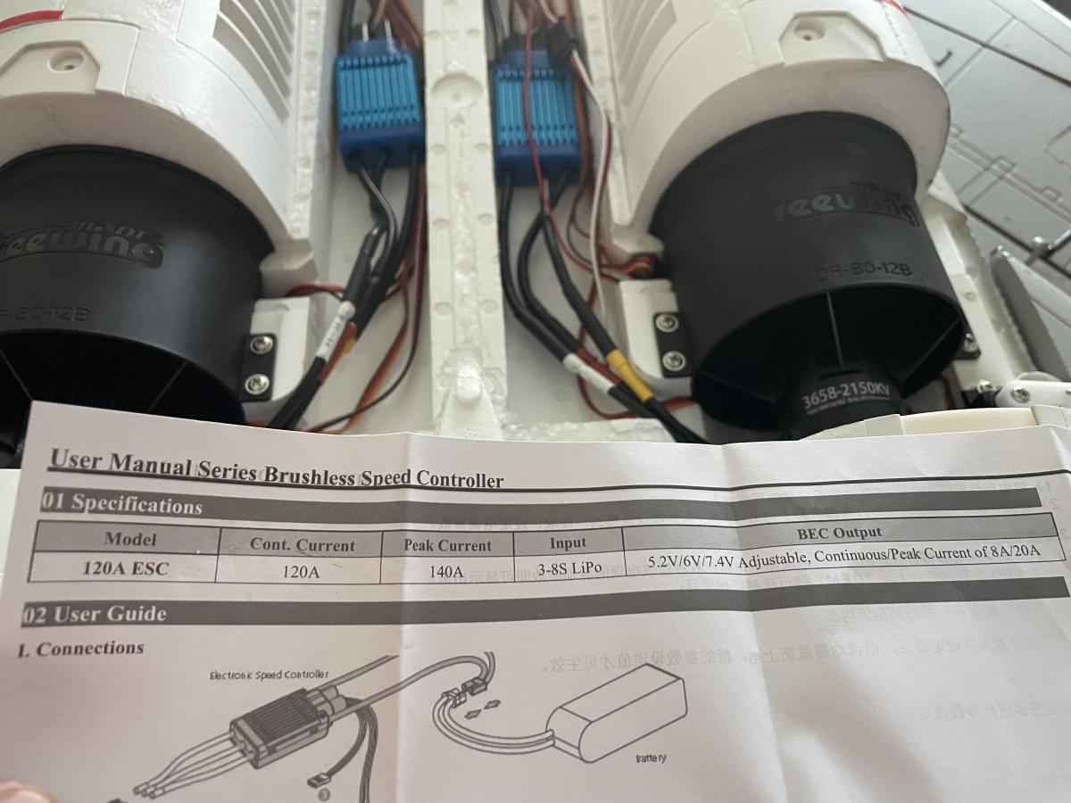

    I ordered 100amp ESCs to replace the 80s in my F14 from RC Castle. They must not’ve had them in stock, because they took it upon themselves to substitute my order with two 120a ESCs w/reverse leads. Pretty nice, but not what I needed. Nevertheless, let’s make lemonade.
    I installed the ESCs, but it only worked if I timed plugging them up simultaneously. If not only the first ESC and motor I plugged up would work while the other beeped.
    I even removed the center red lead as mentioned in some old videos. If you know how to get Y-harnessed ESCs to work, I’m all eats.
    the pics are the old 80s followed by the new blue 120s and the specs in the third pic.

    That bypass is the same as removing the red wire from the ESCs plug...
    Oh. well, you are the first doing this... On some ESCs with internal BECs you need to disconnect one by disconnecting the red lead on one ESC. Many newer ESCs are not effected by this and you can leave both BECs active. If so I would think just plugging in quickly will work, it has on some other planes where I have two active BECs. you have a good second, maybe two before the first goes into programming mode.
  • Having Fun
    I spoke with Motion about this and the tech had a different take on dealing with 2 ESC's and how do you synch the two ESCs. He recommended using a BEC bypass on each ESC. BenchCraft 300mm (12") BEC Bypass Cable [BCT5076-020] Motion RC​ you can get them in 6 inch or 12 inch lengths. Connect a Castle Creation 10 amp bec to one of the battery leads. Use the battery with the CC BEC first and that would turn on both ESCs of which you can then have the throttle high and synch the two ESCs.
