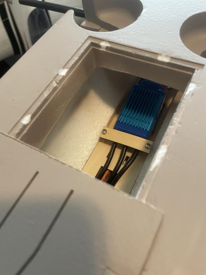

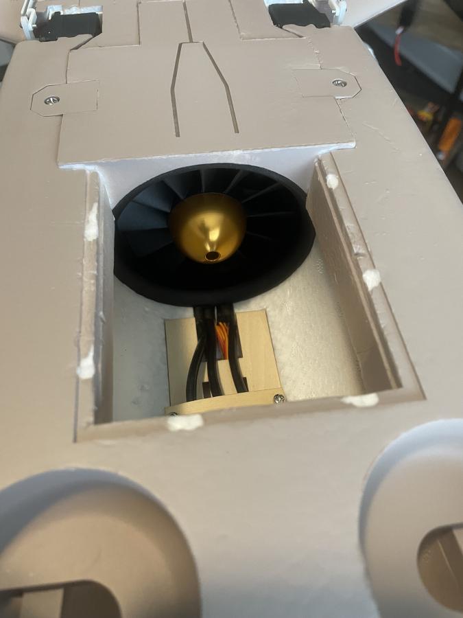

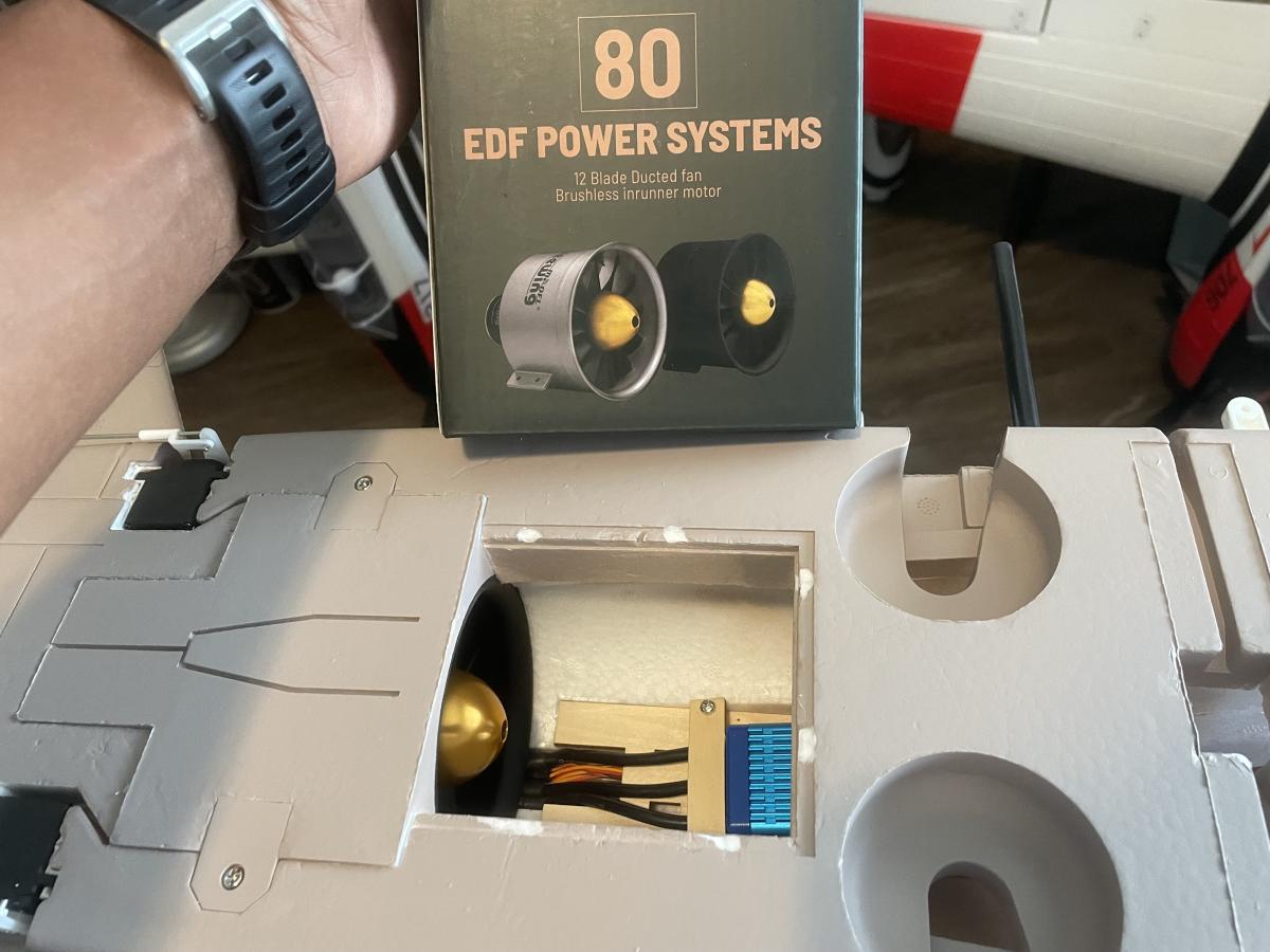

    The MiG 29 ESCs are good, but the new 3658-2150kv 80mm motors are the lates most powerful on the market for Freewing aircraft. It was released with the me F-9 jet. I’m updating my F-14 and my other 80s like this F-5 Tiger. I even put in a new 8S ESC.
    here is my test run with the new freewing12 blade inrunners fans. Definitely had a tangible boost of power with these
    RM, Are these fans and motors from MiG 29?
    If not, which Motors/Fans are these?
    I ask b/c I bought the MiG 29 setups and the Tomcat ARF.
    Don't really want to change out motors and fans if I don't need to do that.

    The 120's but you'll need to rewire them to add the BEC...
    Thanks for the info. I've got the 100a ESCs on order for my F14, but since these are newer, smaller, and lighter 8s capable ESCs, I'm going to upgrade a couple of my 6s birds (F-5 Tiger/70mm F-16) and fly them on 7s. The specs on these 120a ESCs are pretty sweet:
