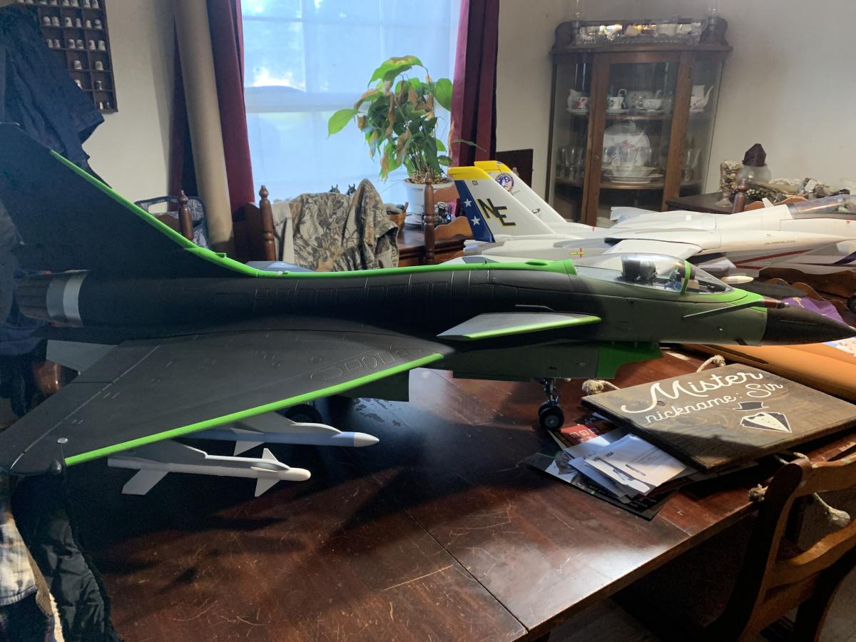

  • shortround91
    Well the F14 is ready to fly am going to replace the elevator servos first won’t take big 10-20 minutes for that. Alls working probably along with the Mirage EDF and ESC’s installed definitely has tons more power than the older stock ones ever thought about having. Having some health issues hopefully I’ll be able to maiden this weekend will post a update after hopefully all goes well

  • shortround91
    Won’t be long before the F14 Maidens, I bought the 90 F15 had similar issues on controls as the F14. All my fault choosing the wrong wing type but to my credit I was choosing what the pics looked like in wing rudder set ups. Throwing the 80mm EDF/ESC’s in now along with the upgraded servos as I have the same twitching that doesn’t give me much confidence that bad things won’t happen. Anyways I’ll post some pics within the next few weeks how the maiden goes been having a blast flying the J-10 and F15. Got 115mph from the J-10 level and 106 from the F-15 again level flights. Thanks guys for all the help talk back soon

  • shortround91
    That was my main thought of doing the 64 board was for the wing sweep not having to worry with flaps being down. I’ll post some pics soon hopefully y’all can help me get this thing sorted out.
