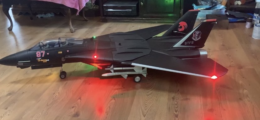

    Thank ya, I upgraded to a AR10360t+ really like the plus seems like I can get more throw and boy does it work great. Next up is to install the 3D cockpit install a HUD light set for the canopy

    She is a Beauty for sure.
    Bravo Zulu, Sir.
    Best, LB
