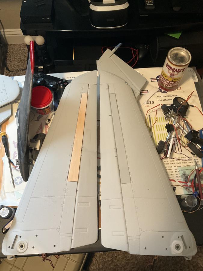

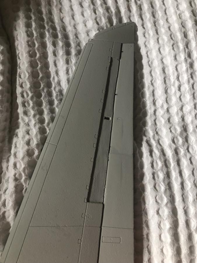

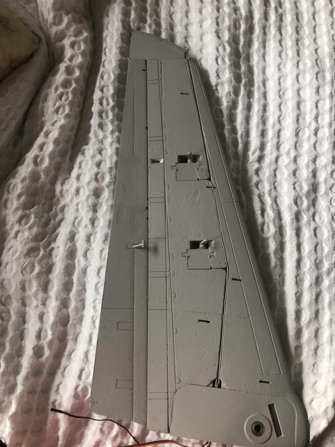

    Thanks Guys, I got my hinges last night and started getting the left wing spoiler attached. I'm still waiting on the control horn. I thought I had them in my order, I mistakenly didn't order them, so I ordered them last night as well as a full set of wing servos for the stock wings I have. Hopefully this weekend I'll have bother spoilers done and the full fuse painted.:fingers_crossed:
    Dougcarr73, I am going to have to model setups for it in my Horus X10. ​I'm using a S8R RX setup with Delta Config for the Tailerons and Rudder. My outputs on this RX will be Throttle, Taileron Left, Taileron Right, Rudder, Gear, Wing sweep and Steering. Then I'll have an X8R RX for main wing control sufaces, Left Aileron Or Spoiler, Left Flap, Right Aileron or Spoiler and Right Flap.
    I will also be using Air speed sensor and two Battery cell sensors so I can log and use call outs for important information. I'm hoping with time to gather enough data on the airspeed that I can use it for wing sweep in sweep mode and also landing. I'm going to have it call out every 2 seconds while on final. I under stand there will be a lag but with enough use age over time I should build up a pretty good predictability with air speed while landing.
    Model 1 will be with Stock wing (Aileron and Flaps)
    ​ and use Stock setup and RCgeeks full span flaps with flaperons (Flight mode select-able) Basically My last setup.
    Model 2 will be with Spoiler and full span flap wings and be programed with Scale setup.

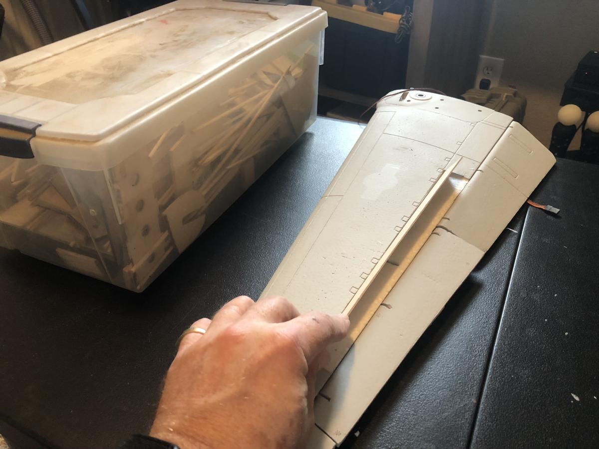

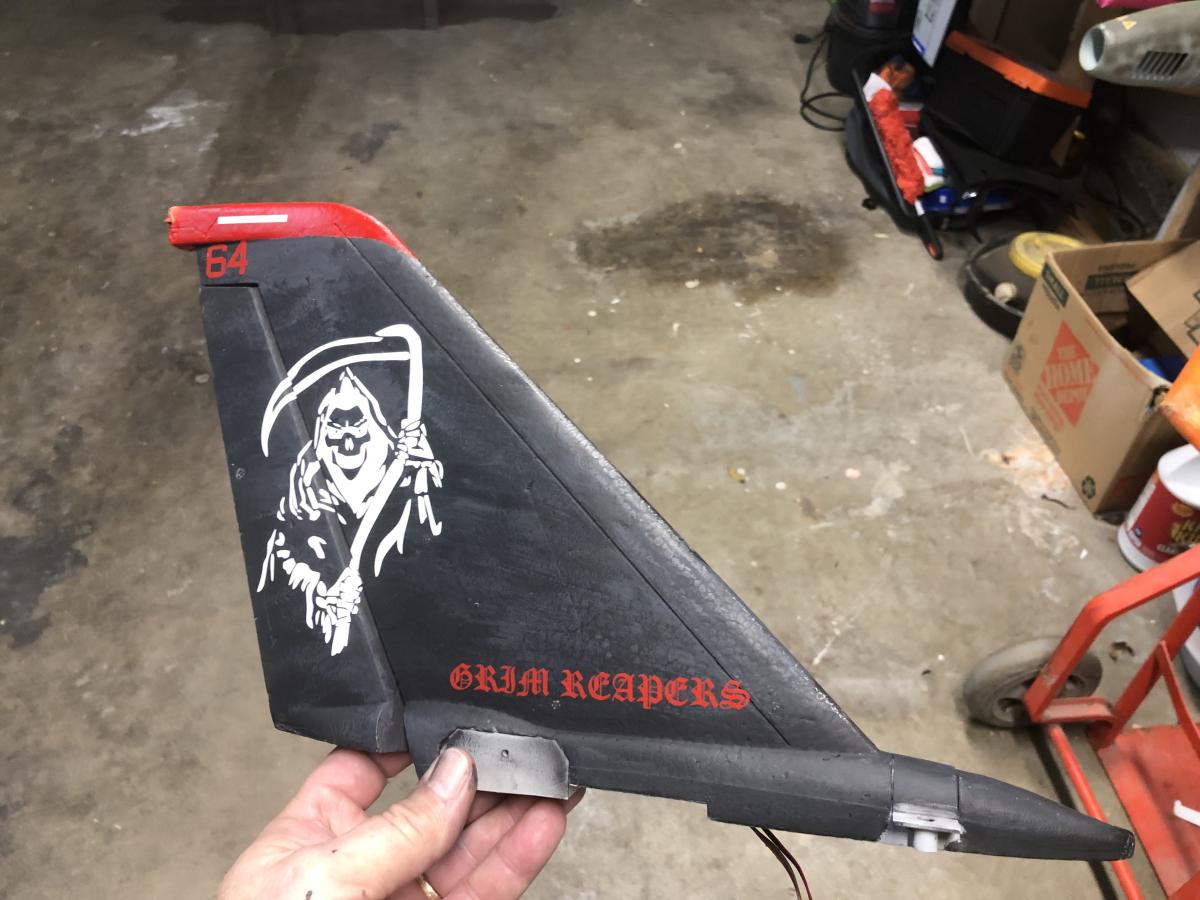

    Originally posted by Gravythe clown
    Well tried to find the post on FB where the guy posted his F-14 build, but could not find it again.
    Anyway he posted adding Spoilers so, I just had to follow suit.
    im still waiting on hinges and need to finish shaping one of the spoilers, but they are coming along nicely.
    I bought a second set of wings, this way I can go either way.
    The refresh is coming along nicely too. Prim coat is all laid down and ready for weathering and topcoats.
    going Grime Reapers.
    Gravy
    Very cool mod... well done!

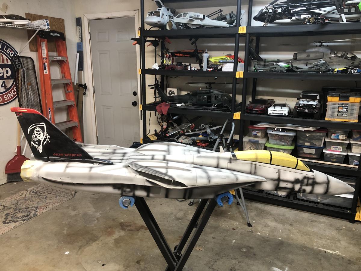

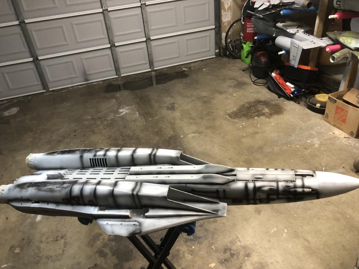

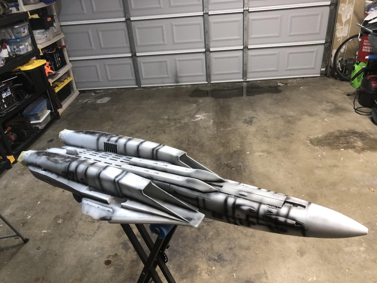

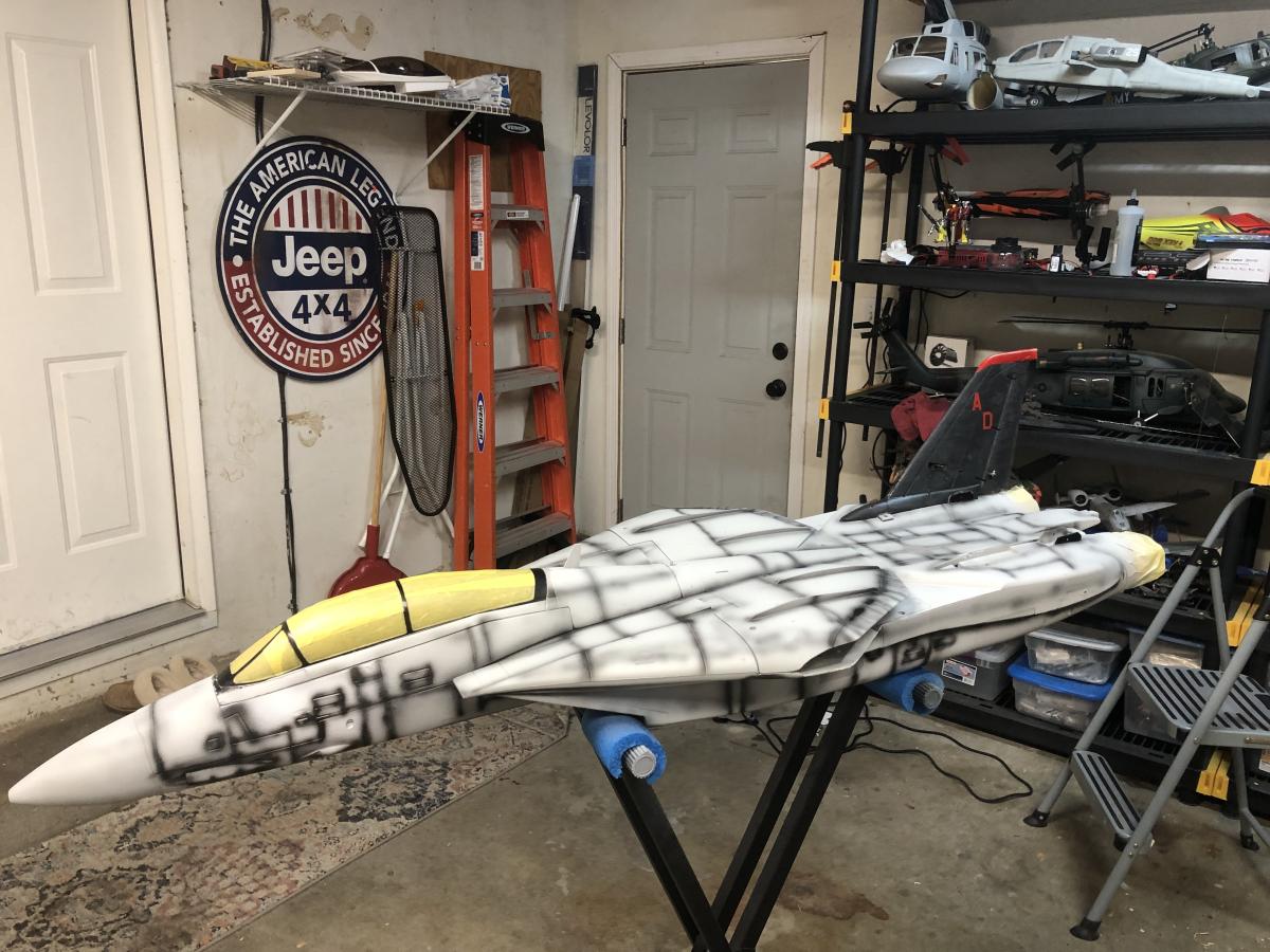

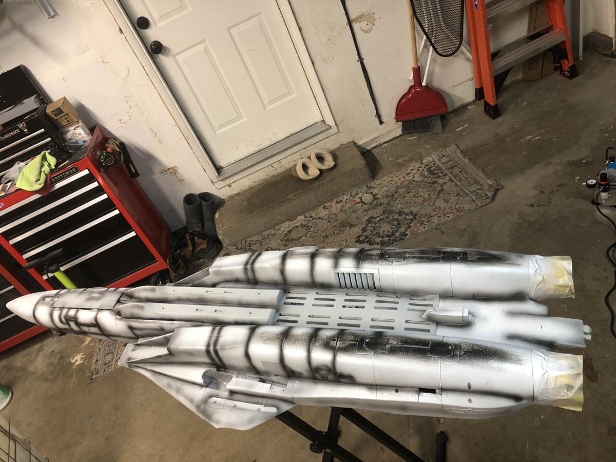

    Got some airbrushing done finally. Got a lot more to do but it’s coming along.
    Gravy
    Lookin' seriously good, GC. Best, LB

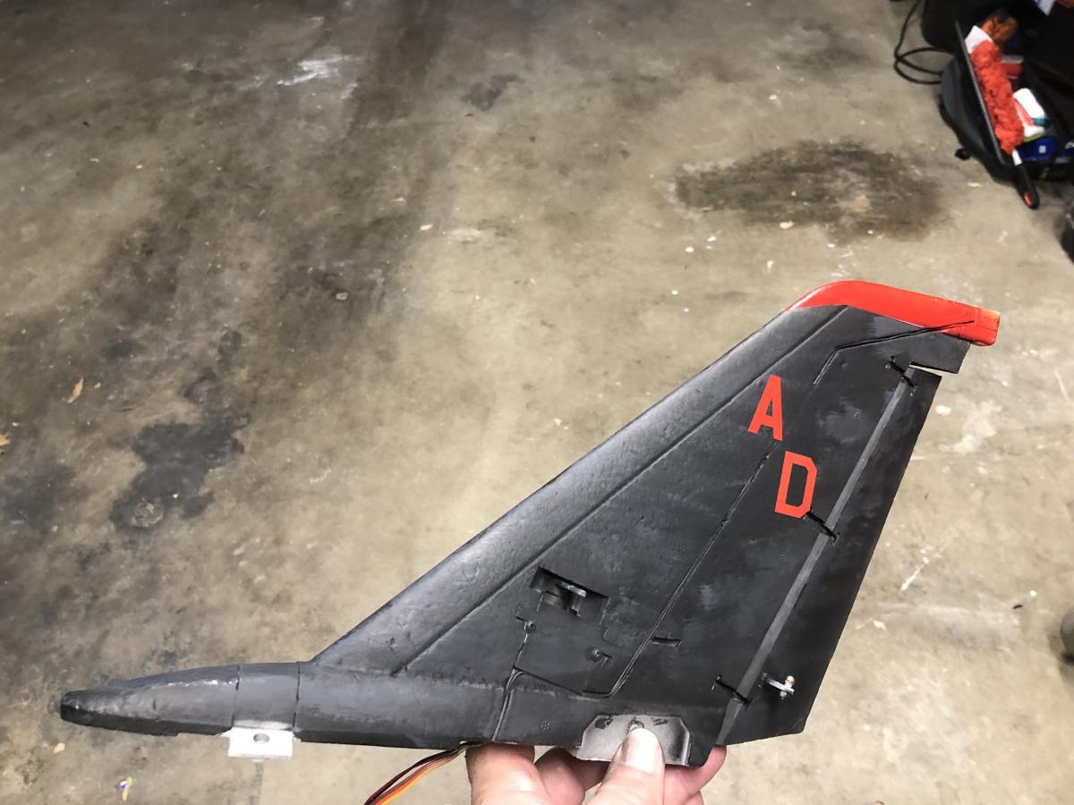

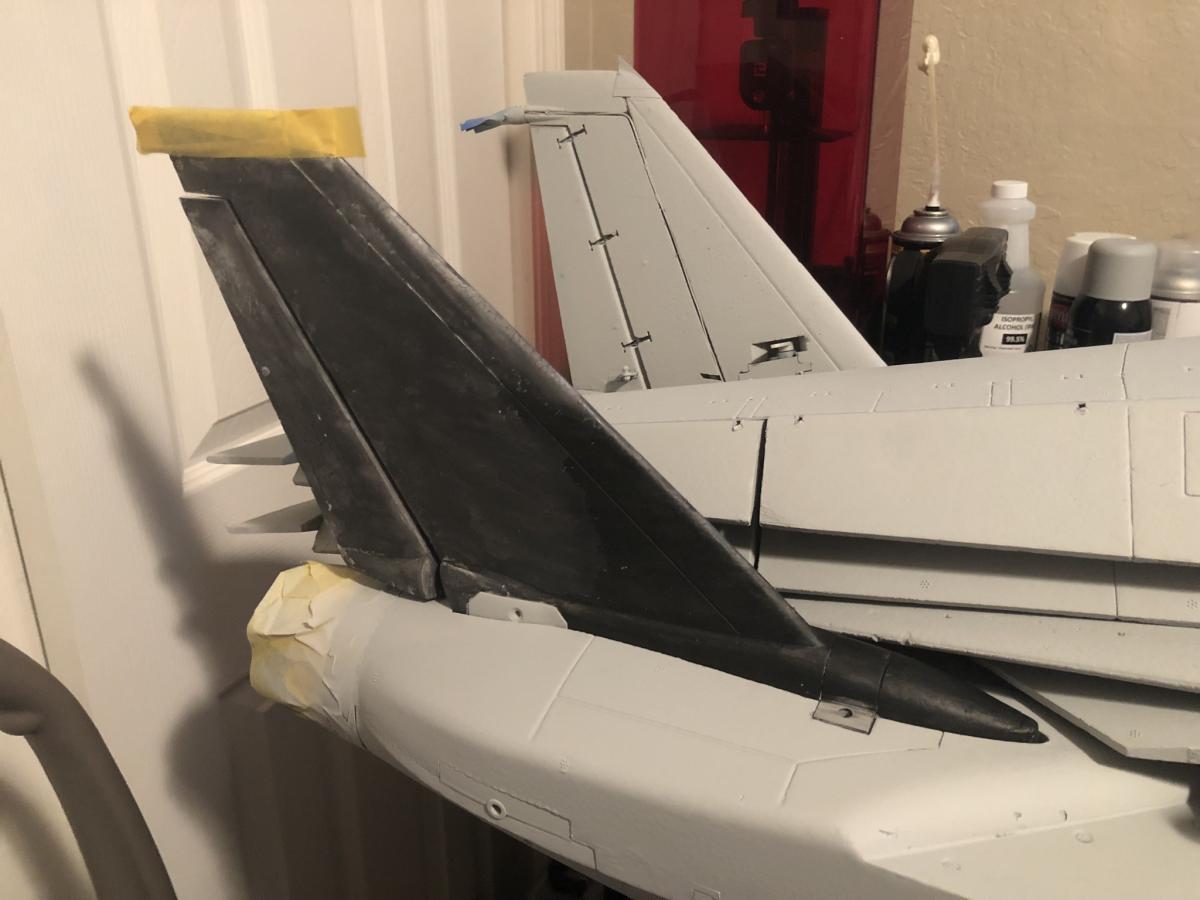

  • Gravythe clown
    Gravy
