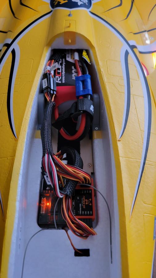

    What are most using for battery in this one?
    4000?
    5000?
    5200?
    6000?
    6250?
    I moved the reflex box and Rx to the very front of the battery compartment so I can slide a 5200 pack in as far back as possible but still getting the CG at 120mm
    I don't have any 4000 or 5000 6s packs as yet but if that's what is needed I will get them.
