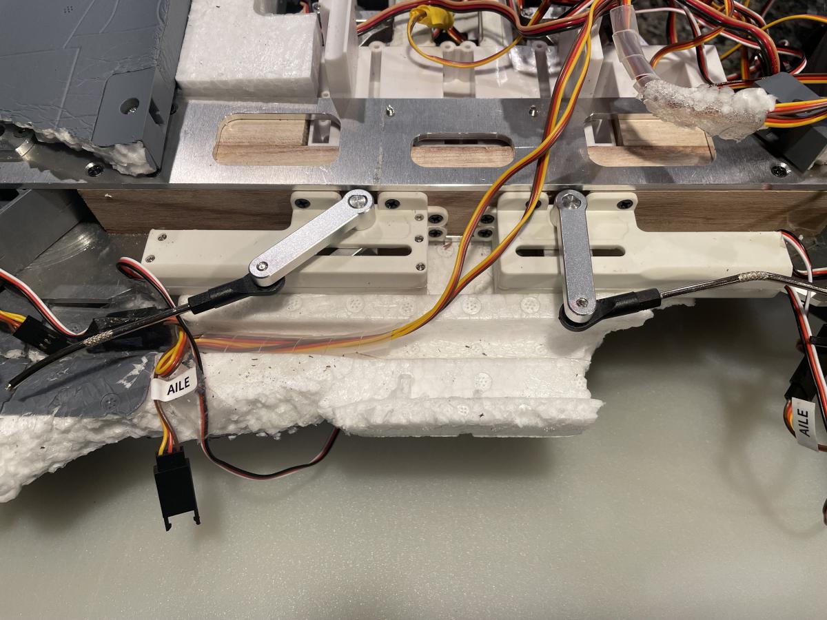

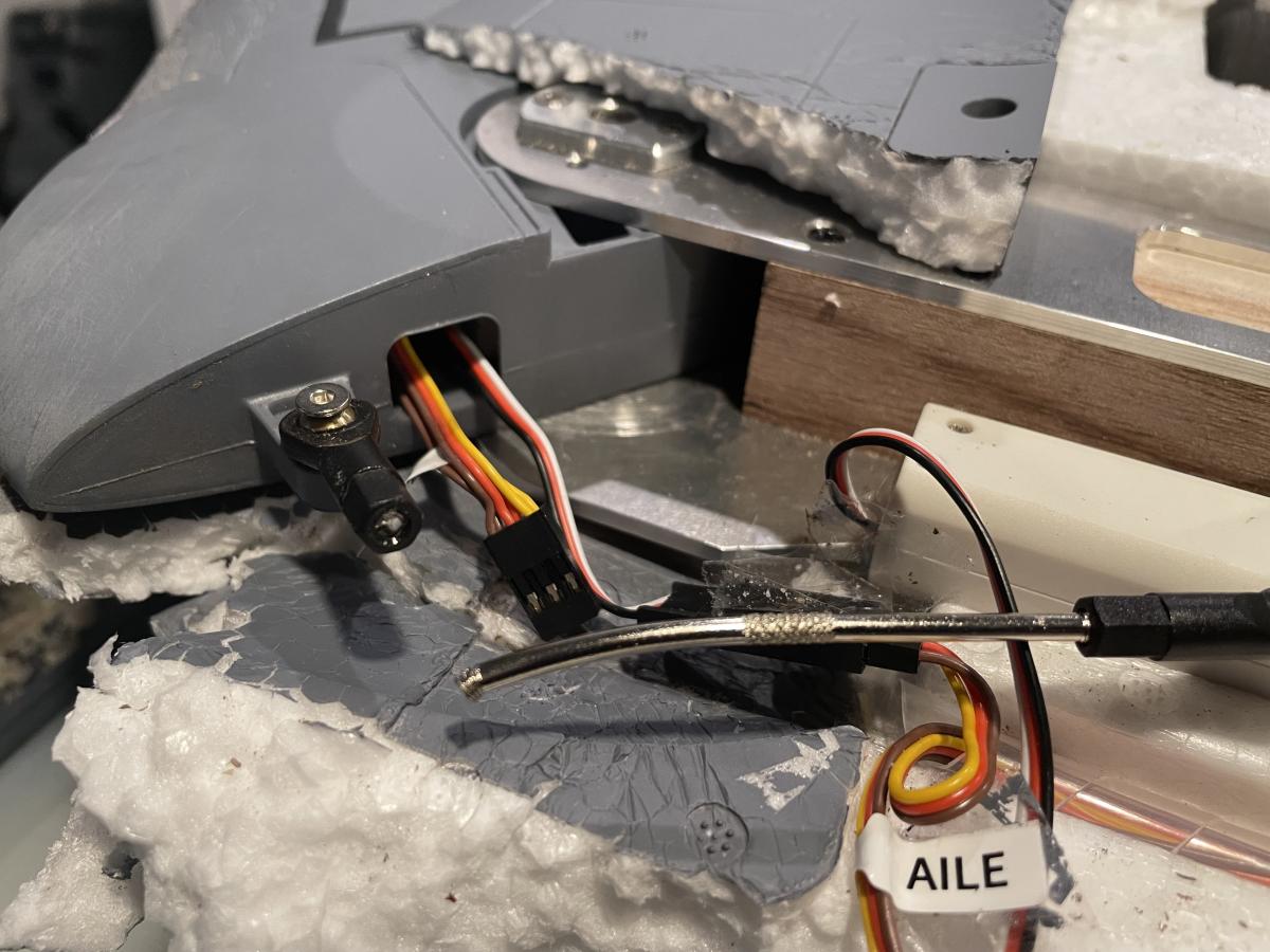

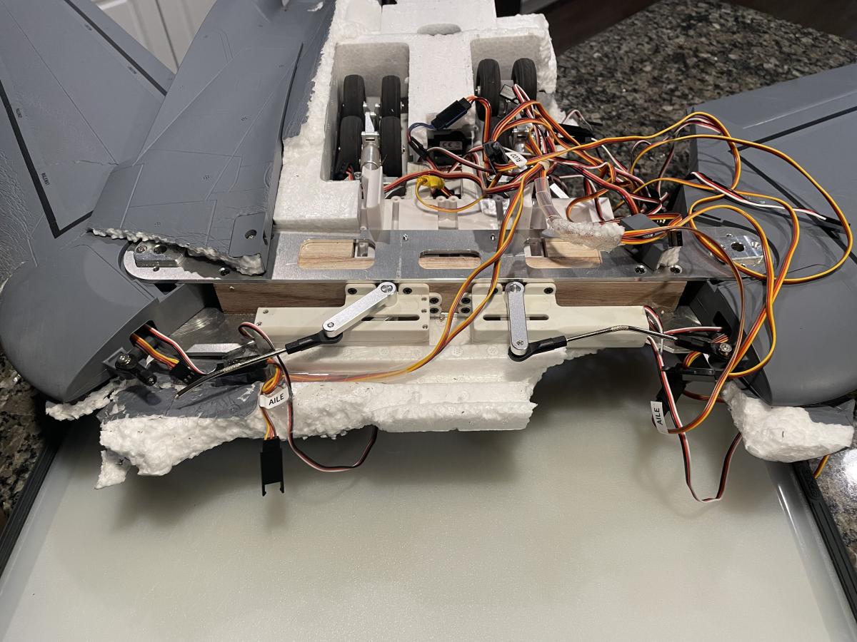

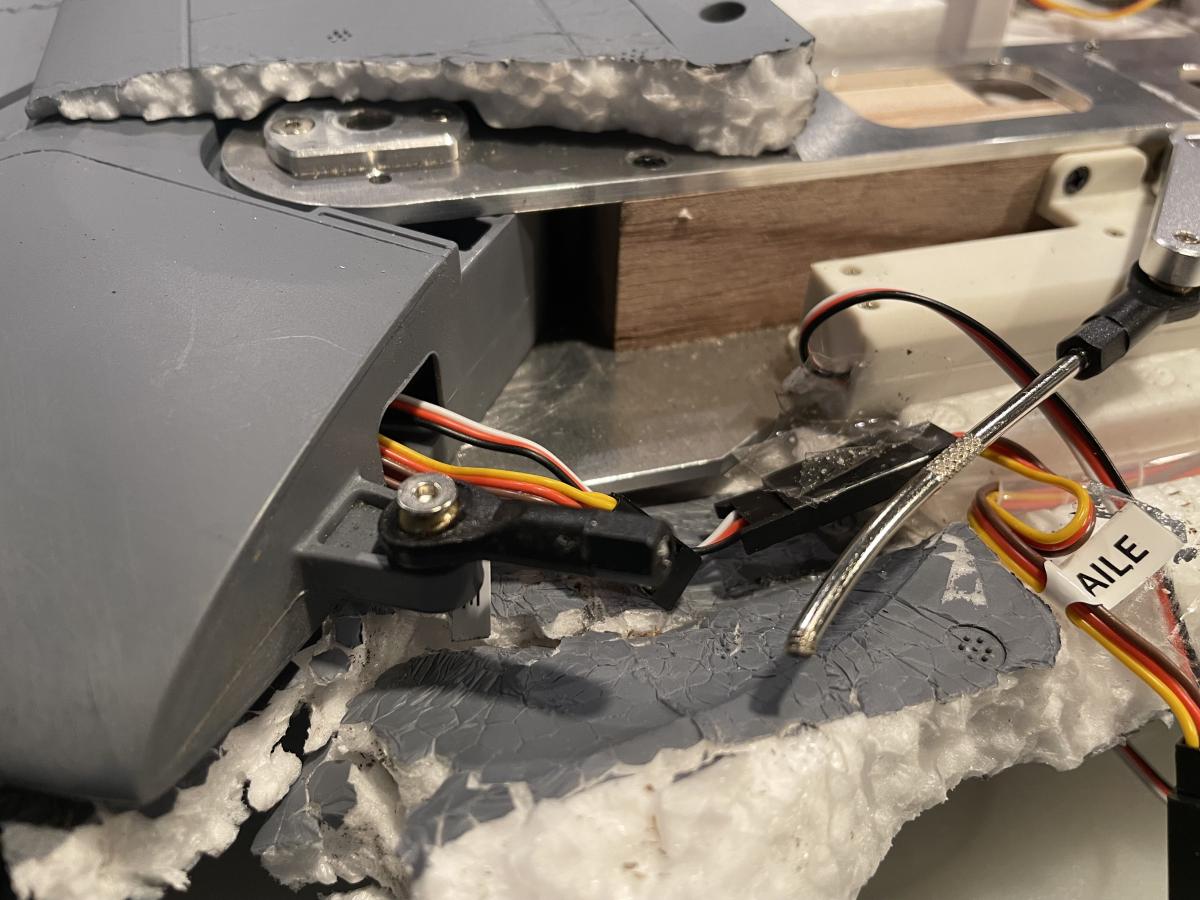

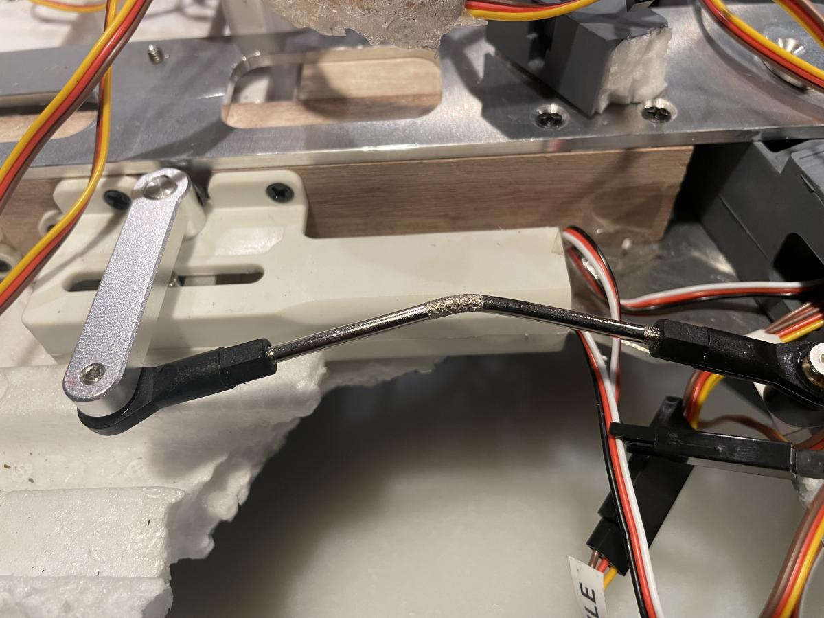

      Post crash, I tested each individual servo with a servo tester and they both operated flawlessly. The left servo had so much power that it began to straighten out the bend in the metal bar when it tried to full extend. The right servo moved freely and with hand pressure it moved what was left of the plane... very strong
      1. Binding; however there was nothing to cause it to bind and flaps were retracted for the wing sweep.
      2. Brown out from near full power and wing sweep simultaneously; this has happened with the landing gear on other aircraft where one gear would stay down, but once you pull the power back and cycle, all the gear would go up.
      3. Right wing sweep servo arm severed in flight; I'm not sure how this could have happened, but it makes sense that the right wing servo arm severed causing the right wing to close faster than the left.​
      I'm leaning toward number two s the reason and number three as a close second. Post crash analysis showed one army fully retracted and the other halfway, which would indicate a loss of power somewhere. Plus, the servos operate individually just like landing gear servos. On my older FW F-18 I had the problem of one gear staying down at full power. I haven't had that problem in years.

        Doug, Thanks for the detailed post crash report. The pictures help greatly. I think I'm also leaning to your second as the actual cause with yours. While I tend to think, like Kallend, that they should have failed together, it's entirely possible, because of possible differing drag on the units and the associated amp draws, that one side (left) failed first. I haven't gotten to mine yet, but I assume these units work the same way a retract does, in that, they simply stop when over-loaded?

          My view is that I have a preconceived notion of brown out, receiver not getting the minimum voltage to receive and process the signal, which is not how it's used in this case. I could see that the power was loaded to the point one high draw item, wing servo could draw down power where it stopped working. I know many retract servos have over current protection and the wing sweep servo is nothing more than a repurposed retract.

            Thanks Doug,,, wow,,,, very sorry
            Pictures,,,Thanks!!
            Brownout seems like a reasonable reason but is that what happened.
            I would think with a brownout it would effect both servos.....
            To bad there's no telemetry......
            Looking at your pictures it's obvious that the right servo stopped halve way.
            I wonder did that right wing jam somehow causing the servo to stop due to a current overload.
            I've had gear do that many times......
            I don't know maybe a flap didn't come up all the way or the wing jammed for some other reason.....
            That left wing is missing the flap.. Crash damage?
            And that right wing the flap is not neutral it's down.
            Looks like down enough to jam the wing........

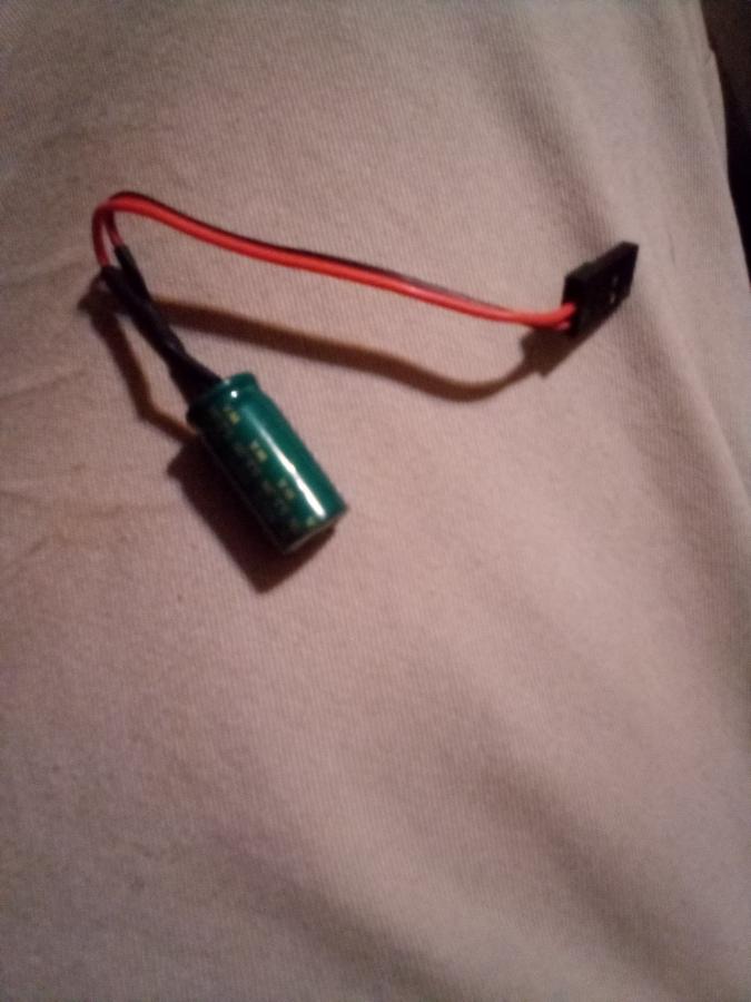

                            Just got mine, watched videos and read post.. haven't seen anything about the capacitor that comes with it. Is it needed and where to install, thanks
                              Where are you located?
                              They weren't included with US shipments back when I got mine, but Jeremy (BH) said they might start including them.
                              They are to help eliminate electrical noise on the receiver power lines due to things like retracts and wing sweep, which can consume a lot of current. You can plug into any spare channel. Just be sure to get the plug in the right way round!
                              • Capt. G
                                • Jun 2022
                                • 17
                                #275
                                Louisiana, got the PNP and ARF Plus, both had them. Figured they would help with voltage drop but wasn't sure... Have Spectrum 8020 , only open is the bind/prog port. Helped a buddy maiden his and resistance was futile 😳 thanks
                                  • 5401
                                  #276
                                  Any spare slot, preferably in the receiver. You can even use the bind port.

                                    Capacitor installed, maiden flight 9 mph crosswind, needed 54 clicks down elevator, went by video. Half flap pitched down so I landed holding nose up . A baby like my KC 46. Will adjust controls then sweep t
