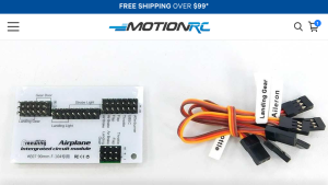

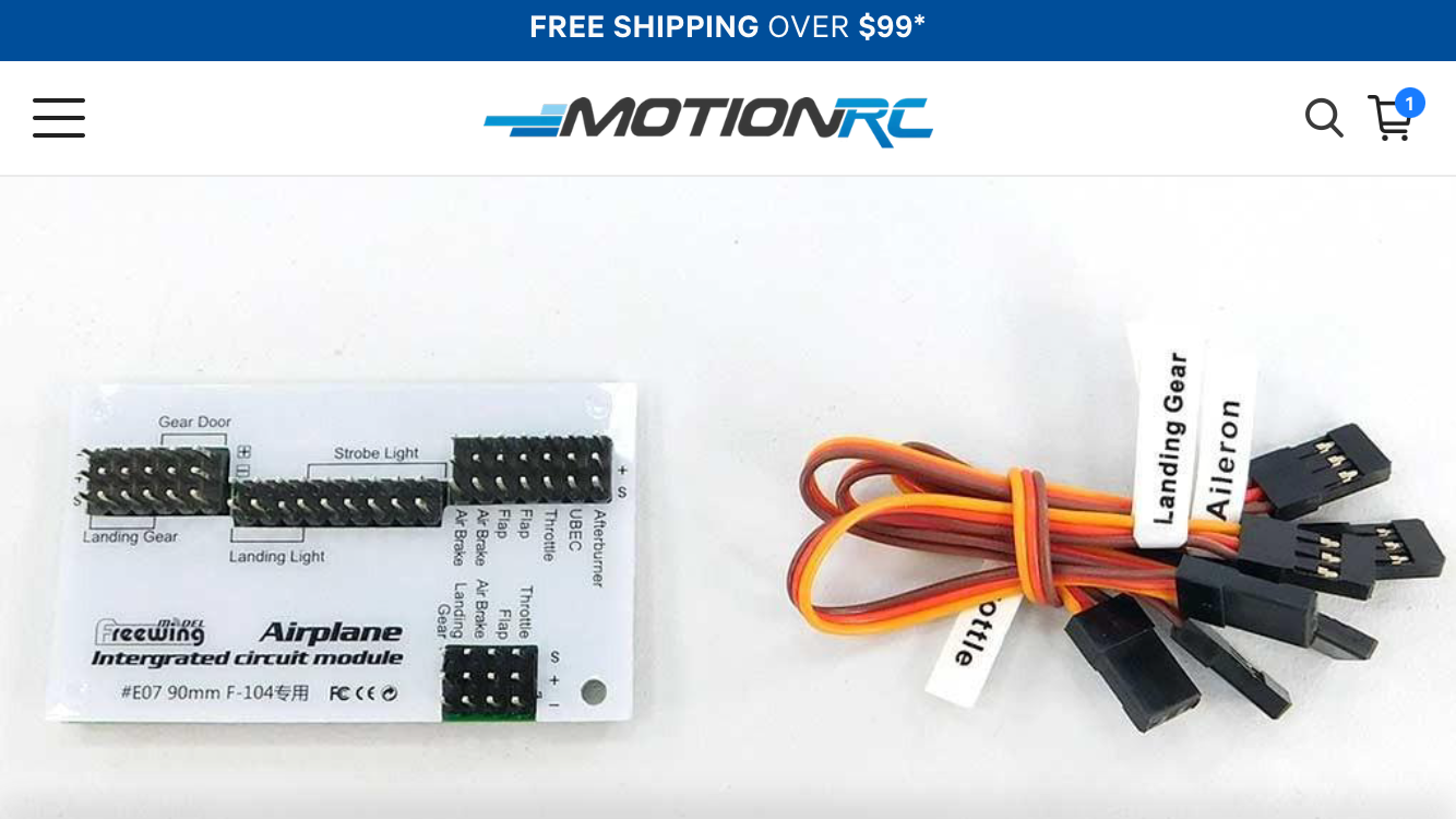

                            In order to get the flaps/flaperons do you leave one aileron in the control board or do they both need to go in the reciever?
                              • 5383
                              #34
                              Both. On this I’ll be bypassing the board (it’s not a blue box) for everything except gear and lights. I’ll have flaperons, tailerons and separate steering as on other F-16.
                              Interesting the boards aileron slots both in and out are marked flaps. The cable is labeled ailerons.​
