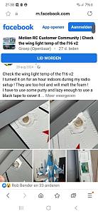

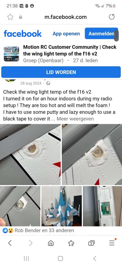

    A warning:
    Click image for larger version  Name:	Screenshot_20240907_213825_Samsung Internet.jpg Views:	0 Size:	62.2 KB ID:	409999
    They Warn NOT to run the jet for more than 30min continualy

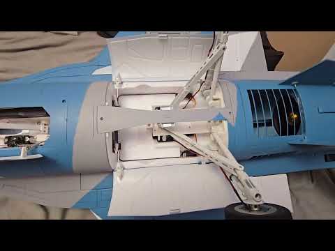

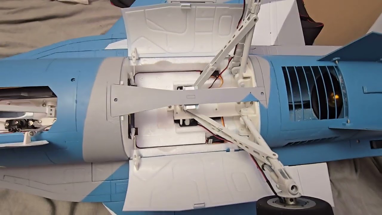

                          My flights went well yesterday. The balance is very nose heavy and right now I'm 30mm behind the wing marks and feel it'll need to go back further. It does fly well, it is heavy and not agile. I have the 8S with 880g of battery and I think the 6S wouldn't be as fun. Flaperons and tailerons help. The airbrake does slow it down a bit and makes the plane pitch down a little.
                          If you fly off grass you will want to firm up the gear, they are springy and you will catch the nose pitot in the grass.

                                  The springs in the struts are weak. Both the mains and the nose strut. On pavement it's no problem but on bumpy grass it will allow plane to tilt and the nose to hit.
                                  Originally posted by Reptielenfreak
                                  What do you mean with firma up the gear?
                                  like dubro wheels or?
