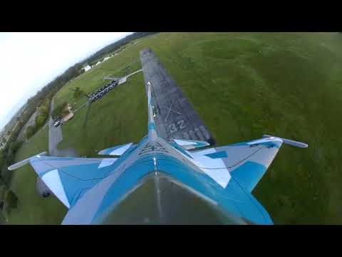

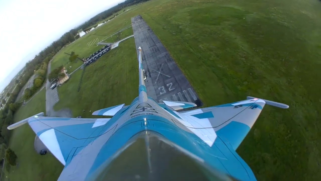

                                    Morning flight
