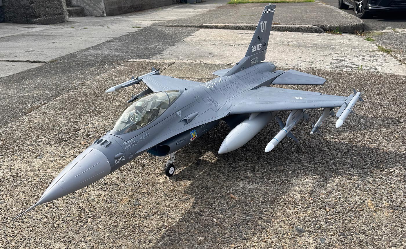

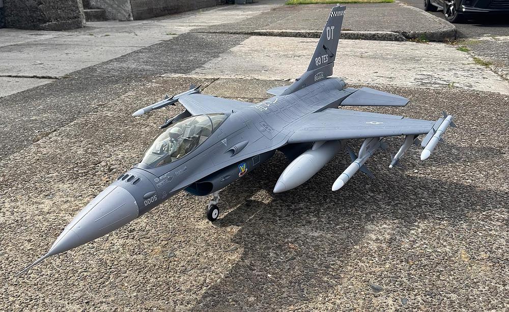

                                      #318
                                      Repainted my ARF PLUS. The livery we sell isn't bad, I'm just not into the turquoise shade of blue. I decided on the ubiquitous military grey. Looks pretty mean with the ordnance and tanks!
                                      • f4u ausie
                                        • 1242
                                        • Melbourne
                                        #319
                                        Very nice aros.. 8 or 6 s
                                          #320
                                          Thank you kind sir! This is an 8S.
