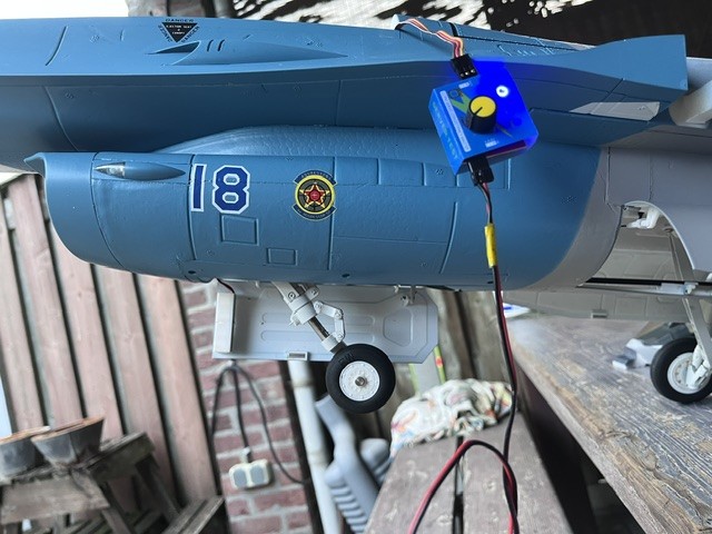

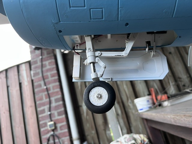

    Can anyone help me out her?!
    Hello, I am reaching out for guidance regarding my newly acquired used Freewing F16 90 v2. Upon purchasing the aircraft, I was informed that it had experienced a hard landing, resulting in damage to...
    I don't have facebook and I search internet to find person Charles D Linear​ who helped him solving the problem???
    I have same issue and he wrote this
    Joe El Padrino
    Auteur
    I got it fixed thank to Charles D Linear that help me . I appreciate everyone help
    but sadly he didn't wright down how he fixed it......
    Thanks guys for helping me out with this issue.
    Regards Hans

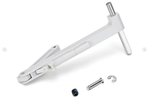

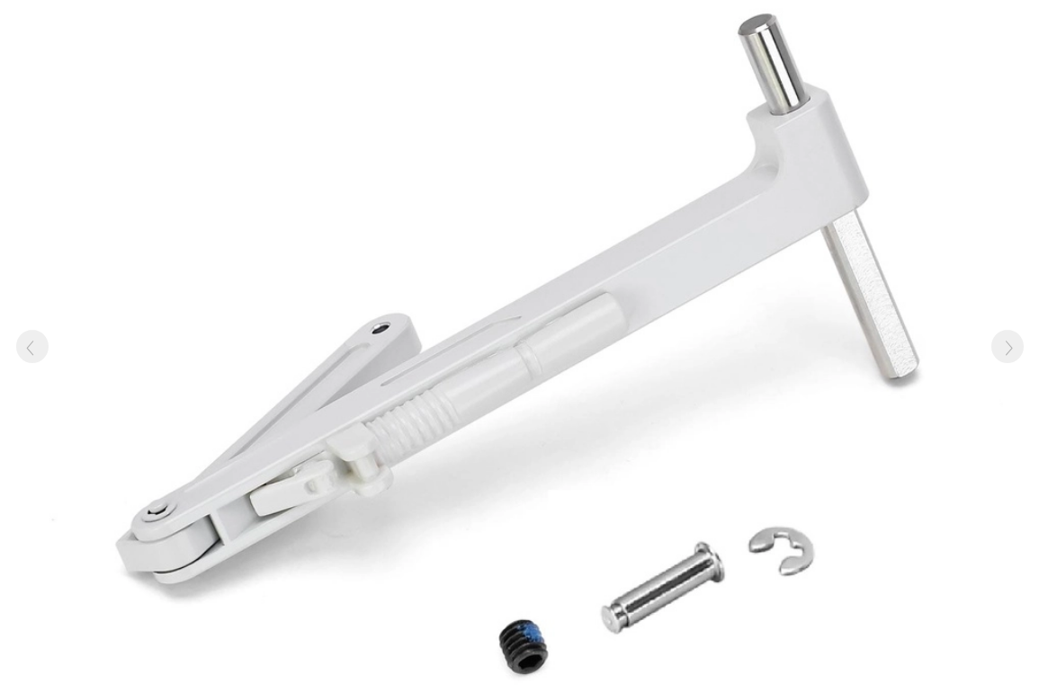

      The shaft coming out of the retract..... It's twisted.. the retract in the down position should b more forward and that scissors part in the bottom picture almost straight. That's from personal experience. My friend and I have had same problem... Flying off grass. I've repaired the twist. But that part is cheap and easy to get.. Ali express is easy

          Was riding my racebike this morning and thinking about the bend, and I came also on the idea that the shaft must have bend, coming out of the retract.
          Get it out put in a vise and give it a smale twist.
          Assembled the retract, tested it and it's fine again.
          Thanks for pointing me in the right direction.
          Kind regards Hans

            Good job. ...it unfortunately bend easier next time.

                "f4u" is precisedly correct on this. I think I touched upon this "fix" in this thread somewhere but it's such a long thread, it's not easy to find. I don't know if your case is the same as the guy on Facebook, but in his case, it would appear as though the detent tab on the articulated arm is also broken, such that when the gear is deployed, the detent prevents the arm from over rotation. IE, it helps to "lock" the arm in the slightly over rotated position.
                And yes, the main problem is the long end of that rod at the base of the arm. After a hard hit or repeated soft hits, that rod gets twisted as f4u indicated. In addition, the hex screw that locks down on that "flat" section of the rod may also cause a gouge in the flat. This would mean that the flat must be ground to get the gouge out. Untwisting the rod and refreshing the flat will fix it so that the rod can be "clocked" properly to work the strut through the prescibed end points. As said, once damage and fixed, there is a greater likelihood that the rod will twist very easily next time. You might consider getting a couple spares of that articulate arm.

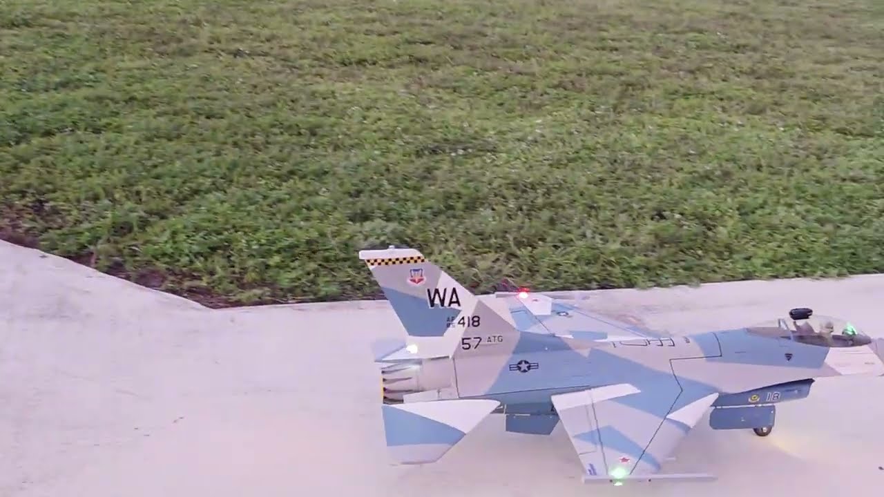

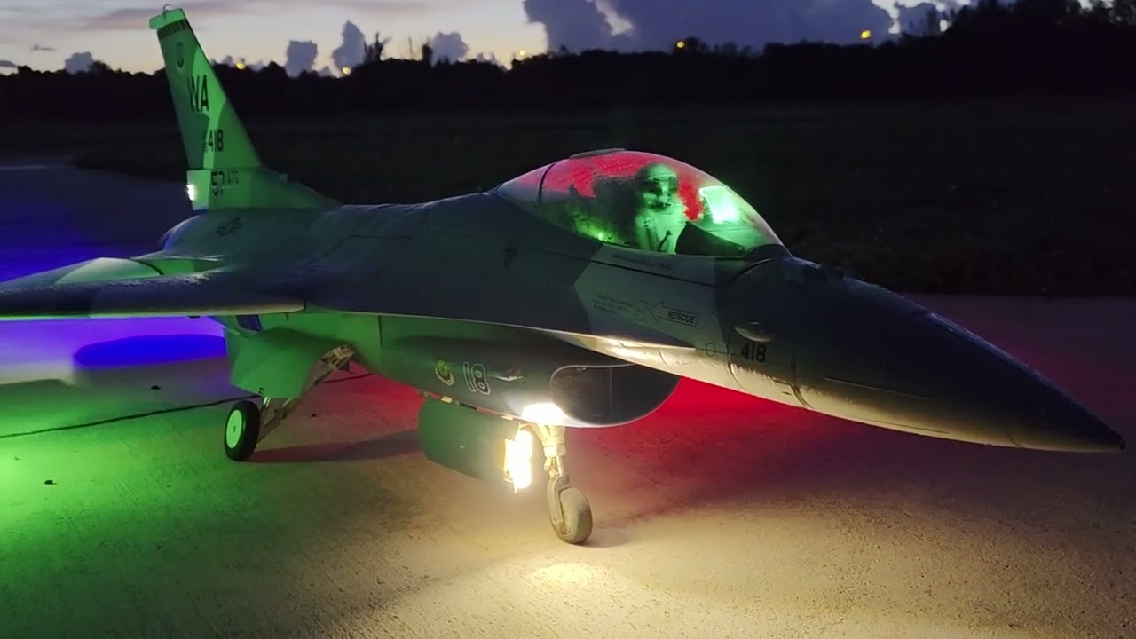

                              #495
                              Nite flite
                                #496
                                Brave!!
