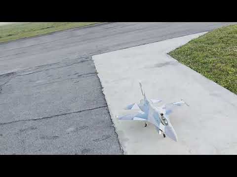

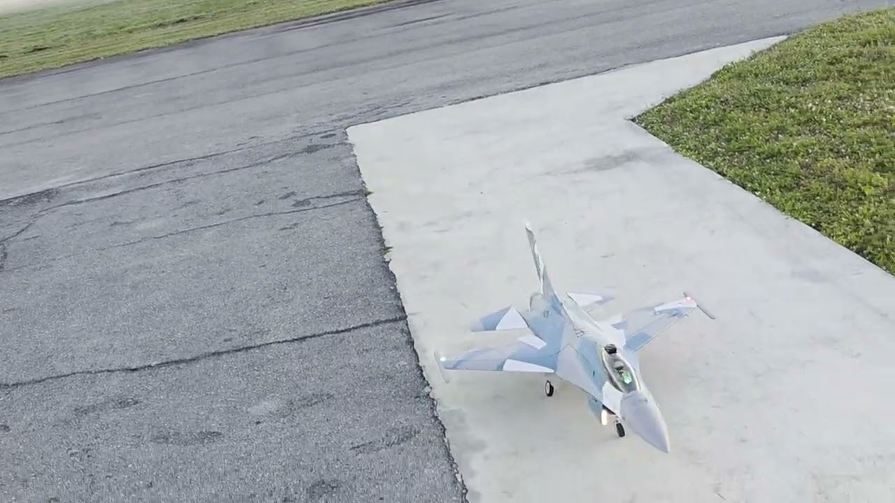

        Morning flights
          • 4874
          #364
          urrl,
          Nice morning ops, Sir.
          Great lookin' Viper.
          Best and Happy New Year, LB

            #365
            Thanks LB. Happy New Year to you
              #366
              Originally posted by urrl
              Morning flights
              Nothing like some greasers in the morning! Well done.
              Just flew mine the other day. Great flyer!
