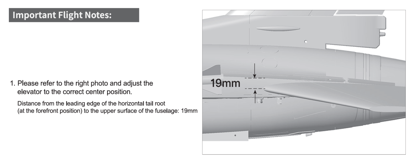

              Hi, first post here!
              I'm on my second flight on the 90mm v2 and I have to say I'm having issues. First flight was almost impossible to get off the deck - elevator neutral and CG were set to what the manual recommended. So I read up and changed elevator neutral and also nudged back the CG by 10mm. Bad idea, had to fight for survival on the second flight. I did install a gyro before the second flight but had the sensitivity dialed low to avoid oscillations at the first try. Turning on that gyro saved my bacon, but only barely.
              So now I'm wondering. Folks here report flying 10mm behind factory CG without a gyro - how?
              For the next flight I've dialed up the gyro sensitivity a bit and will go back to stock CG, though I'll definitely keep the new elevator neutral position.

                  Re: Gyro ............. Consider putting the gyro on a master gain knob or slider so you can adjust on the fly and not have to change it on the ground for the next flight.
                  When you say "neutral" ELE, do you mean as per this photo:
                  Click image for larger version  Name:	Screenshot 2026-04-17 143612.png Views:	0 Size:	221.1 KB ID:	447413This is the starting neutral ELE.
                  Not being able to get off the ground might indicate you didn't have enough elevator (or set in the wrong place to start with) and/or you were flying off grass that was a bit too thick. As for "fighting for survival" on the second flight after you moved the CG back 10mm ........... a rearward CG is not for everyone. Those who swear by it, fly in certain ways and have gotten used to handling the plane that way. You might want to resolve the flight characteristics before starting to move the CG back. You might have too high of travel or too low of EXPO or both.
                        Yes. That was what I used on the first flight, and reading through posts moving that to 24mm from the top edge is definitely better.
                        Not being able to get off the ground might indicate you didn't have enough elevator and/or you were flying off grass that was a bit too thick.
                        Travel and Expo was set as per manual. We have a plastic runway (it's from a big paper machine) so grass was not a factor.
                        Yeah I'll go back to the stock CG but keep the altered elevator neutral position. As I said both travel and expo are set up as per manual.
