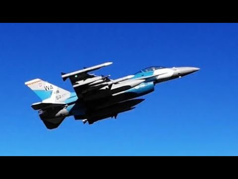

                              • Pushing the F-16 pretty hard on this one... if you want to see what this jet is actually capable of in post-stall, don't miss it out!
                                • You make my flying style look like a grandma by comparison, LOL.
                                  • Xviper…. Thanks much!
                                    • Airgardian. Is your F16 6 or 8s. Great flying.. I expect U have the cg back???
