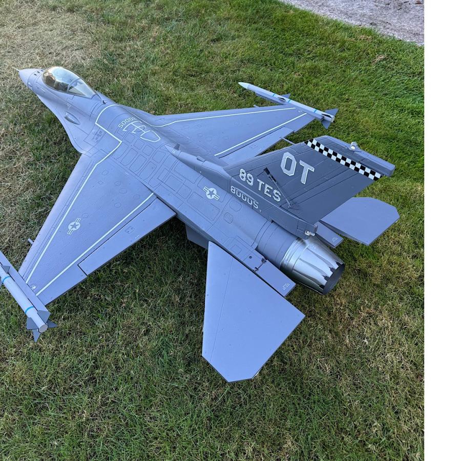

    Originally posted by Aros
    Repainted my ARF PLUS...the ubiquitous military grey. Looks pretty mean with the ordnance and tanks!
    Whoa Brother, she is a Sierra Hotel Mama, now.
    Truly nicely done.
    Best, LB

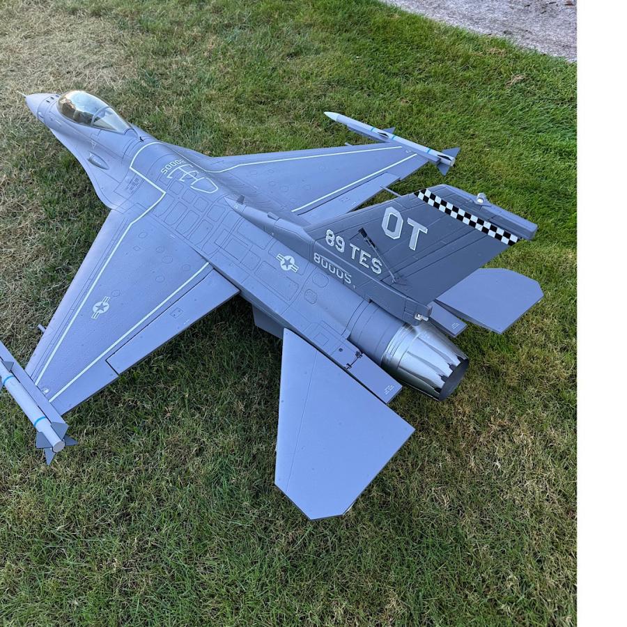

      Maidened the new ARF PLUS airframe yesterday. Couple clicks of up and she flew well. First time I’ve ever maidened fully dirty. I read enough reports that she flies perfectly fine dirty, just not quite as speedy. Wasn’t really an issue on 8S.
      With the all grey livery, seeing her well was a bit of a chore so I’m going to add two non-scale white vertical strips on the bottom to help. I hate adding any non-scale detail but I’m not getting any younger so these mid-life eyes need all the help they can get.

        • 4817
        #323
        Aros
        She looks like the real meal deal.
        Congrats, Sir.
        Best, LB
          • 8202
          #324
          Thanks as always kind sir!
ID:	433373Finished her up. Added the antennas and peripherals including the white walkway lines. Just your typical geeky scale nerd stuff lol.
                Boy this grey scheme won’t do me any favors on a grey day that’s for sure.

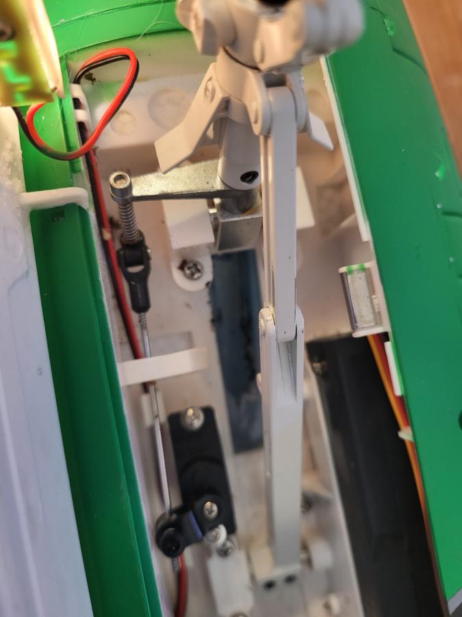

                  Has anyone had a problem with the front landing gear not locking?
                    • 8747
                    #329
                    Yes, this usually happens after one or two hard bumps on landing, such as hitting a divot or hump on the runway, especially if the driving shaft was not adequately "clocked" onto the first driven articulated arm. Hard to explain but if you take the nose gear out, you can better understand what I'm getting at. On the retract itself, look for the part that turns the articulated arm that connects to the strut itself. Either the hex screw(s) have come loose or the hex screws have gotten a bit loose from the "flat" of the rotating part. Also, the rod with the flat could also have twisted. When you take the nose retract out and run it using a servo tester, you'll see more clearly how the whole mechanism works.
                    You can then determine which aspect of the assembly is at fault ................. either undo the hex and re-tighten it with some FoamTac or Loctite or hone the flat back to the angle it needs to be or un twist the rod. The easiest and more expensive solution is to buy a new retract and arm assembly.

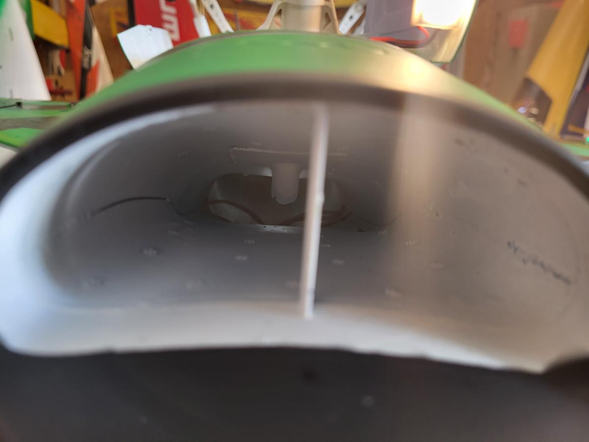

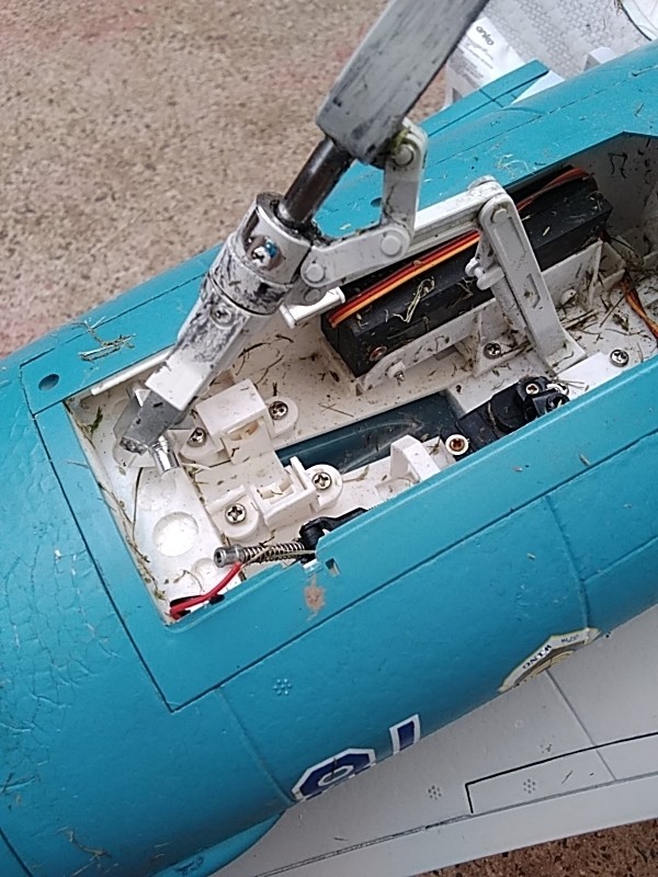

                        Thank you very much for your detailed answer. I haven't had any particularly hard landings, but we have a very uneven grass runway, and the Falcon has a very long takeoff roll. Once, it folded over before takeoff while accelerating, and again after landing on the landing run. I noticed a grinding sound during retraction, and it turned out that the cutout in the fuselage for the landing gear leg was too shallow. I cut a recess there. I tightened the bolts on the pin, but the rod is already limp, and something is skipping in the retraction mechanism itself. I ordered a new one and will adjust it properly. The season is over here in Poland, so I'll be flying in the spring. Best regards.

                          • 8747
                          #333
                          [QUOTE=lusek_pl;n433409]
ID:	433411 Click image for larger version
                          Repeated take off and landing rolls on bumpy ground creates a vibration that will loosen the "driving" rod hex screws, or twist that rod or round the flat a bit. Look at the lower portion of your first picture (at the 2 grub screws). It's the rod that those screws clamp onto that is the part in question.
                          Also, the elbow of that articulated strut should be at least straight or even better, slightly over driven to lock in firmly. When you get the new part, operate the nose assembly and see where the elbow ends up. I think it's entirely possible that your current one came with that elbow not locked in, making it more easy to loosen everything and prevent a properly locked arm.
                          On my old one, when I took out that rod, it was severely twisted plus, the grub screws started to round off the flat. I put it in a vise and untwisted it and refreshed the flat.

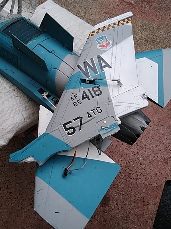

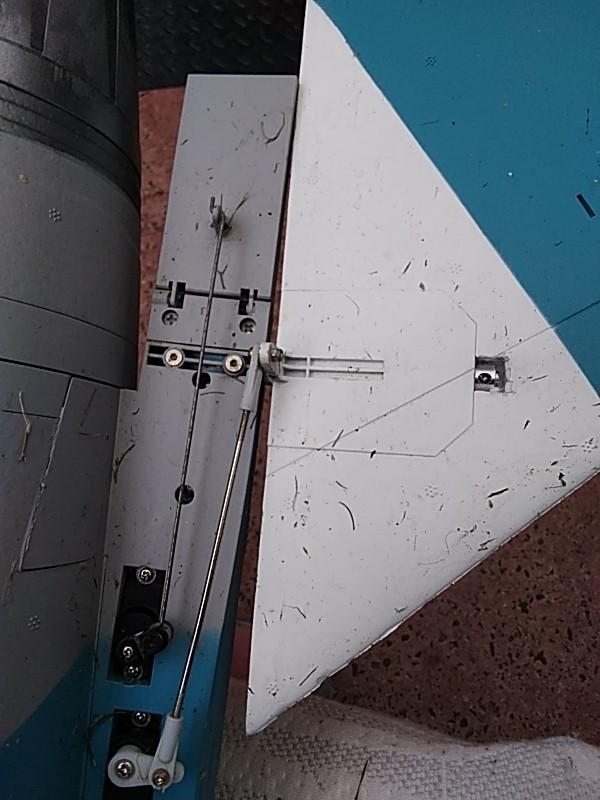

                            Hey team hope you r all well,, so my remaiden on 1100 grams of 8s overall went well... almost.. first flight very good... i think its underpowered on 6s.. not so on 8.. but second flight slowed a bit much aproaching final ,almost hit the dirt... went around ,, good plan stan,,, buuutt.. just touched the long grass,, very long .. on the edge of the runway,, and flipped it.. overall minimal damage,, vertigal 1 outer pylon nose cone all easy glue fix... front gear ripped out the front bearing mount.. oh and 1 bent elevator shaft.. coulda been waaaay worse... generally easy fix,,,,,, couple pics Click image for larger version

                              • 8747
                              #335
                              Very unfortunate! Been there, done that. We also have the scourge of grass at the edge of the runway, compounded by gopher mounds. We have a saying, "The runway never seem to be wide enough". No consolation but it could have been much worse. I'm sure you'll get her back in the air soon.

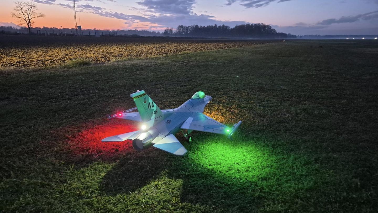

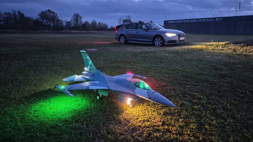

ID:	434997 Click image for larger version
