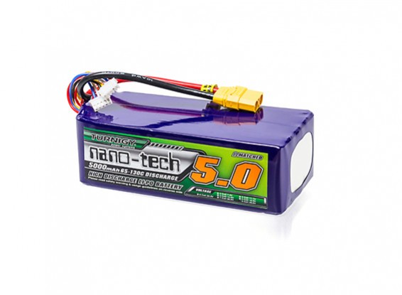

            #125
            Originally posted by ArmorBolt
            What battery and flight time.. for 6S version.. that what I have.
            I fly the 8S version with the following battery and have 4 of them:
            Turnigy nano-tech 5000mah 8S 65~130C LiPo Pack with XT-90
            A good 4 minutes of acro flight time​
              • 5416
              #126
              That's a heavy battery, where are you balancing the plane?

                    #129
                    At 130cm and the battery at the very back of the shaft, up to 2cm... no problem. 2 4S batteries are hardly any lighter at 5000mA/h.

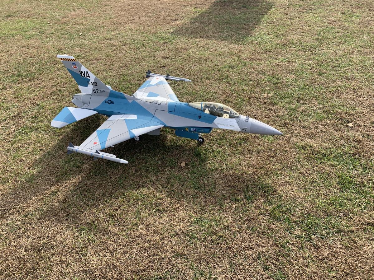

                              #134
                              Originally posted by lotech
                              So have a question, like a few others, mine came with a red ESC, wanting to replace it, I see the replacement one is out of stock. However, the old F-16 (V1) in the replacement parts for it, has the ESC with identical specs it seems to the new one...including thrust reverse. Is this the same ESC as the V2? I did reach out to the tech support and was told " the internals" are different.....not sure what to think...
                              Assuming you’re running 6s? I can’t answer on the Eflite ESC but I have the blues in all of my 90’s without any issues at all. My 90 F16 is 8s currently running 2 4s 4400 Green SMC’s, just got in 2 hivolt 49/4200 packs. Think I’d would rather go 5000 myself mixed flying so far getting 3 min from the 4400’s maybe the hivolt packs will do better will update as I get to try em out. 12th flight on the F16 today finally have her dialed in, I’m 2 fingers behind factory CG marks which seems to be the sweet spot for me, I have had to turn down gains had some oscillation going on at higher speed flights. Running a AR10360t+ high speed gains asset 18/26 no more oscillation of course for alphas gains are raised. I am running tailerons saw no need in flaperons or thrust reverse in my grass field, one suggestion check you front retract trailing arm set screws mine were loose caused front gear to collapse fortunately no damage other than the front gear door which I made my own hinges as stock doors are out of stock still. One speed pass in level today she doesn’t do bad at all
