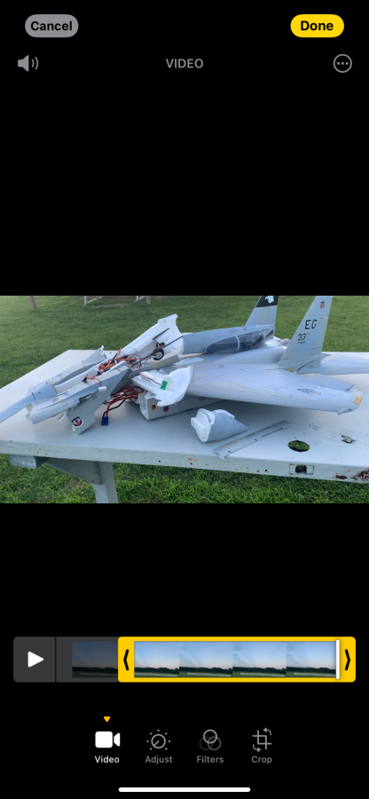

                                First I lose my Freewing 90mm F-18 on the maiden. Uncontrollable, got away from me and crashed in thick woods about a half a mile away. Tried to locate with my drone to no avail. I decided to get the bad taste out of my mouth so I went to fly my recently painted 90mm F-16 V2 (hauntingly in retrospect, a fantasy Blue Angels livery). The maiden was great, just needed to trim her out. So today was going to be trim the flight. Usual pre-flight checklist, everything normal, battery secure, CG good, control surfaces all good, power good.
                                Took off on the recently mowed grass field, she started pulling to the right getting close to the edge of the runway but with enough left rudder she kicked back out and then rotated. Almost imediately I could tell it wanted to pitch up and roll to the right. I fought the sticks with all I could, jamming aileron stick full left but it ignored my inputs and nosed in.
                                Two new 90mm jets in one week.
                                At least I was able to retrieve it, broken front and all. Front LG is bent all to hell aft, will need major repairs from the cockpit forward, but from the cockpit back it's pretty much fine, just a little cosmetic damage on the H stabs. And like the F-18, I have NO idea what happened. After the Walk of Shame, I put it on the bench and plugged the battery in (thankfully the 8S battery was undamaged), and everything worked normally. All control surfaces, everything.
                                You ever have those days you feel like quitting the hobby, or at least jets? That's how I've felt this week.
                                Had several like that totaled a 90 F15 not a clue and 2 70 Raptors in one day. Thankfully the V2 90 F16 didn’t disappoint but I get your pain, I have fully rebuilt converted to 8s remaiden I have no idea was not the same plane. Finally yesterday I said the hell with it do or die spent the whole day working her back out. Ended up having to scrap and factory reset the AR8360t finally after 5 flights she’s back to around 90% I do have the reduced nozzles that I’m going to remove think they choke her down on 8s. Pick your head up and head back out Sir
