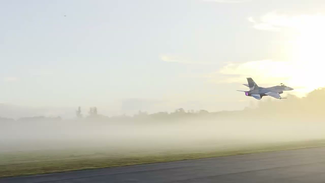

                                          Absolutely cool, I also enjoy flying when there's little fog!
