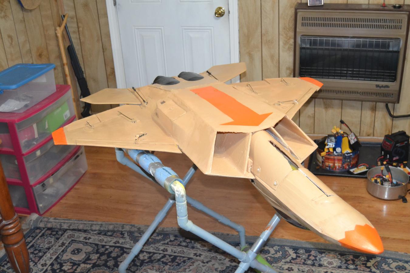

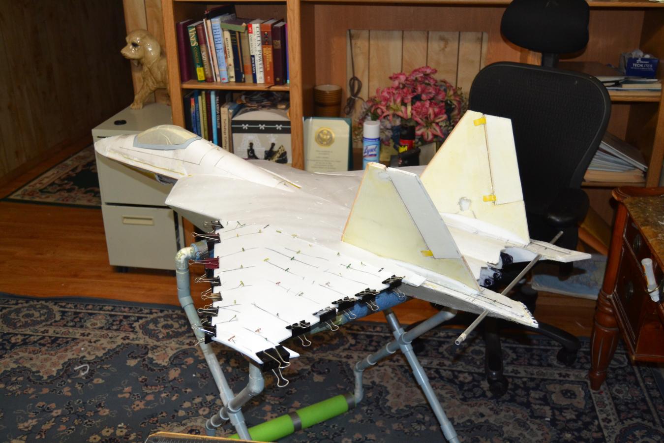

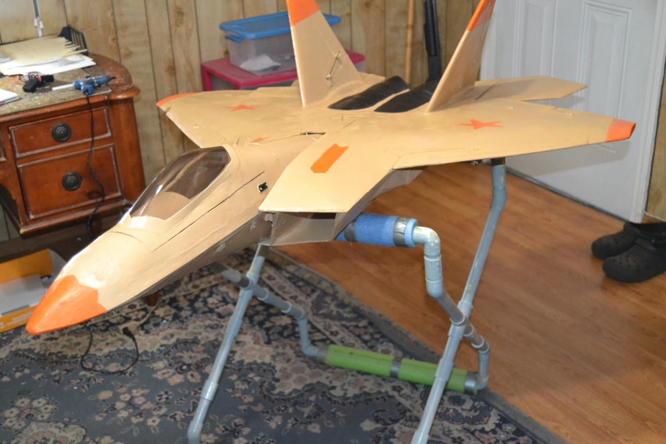

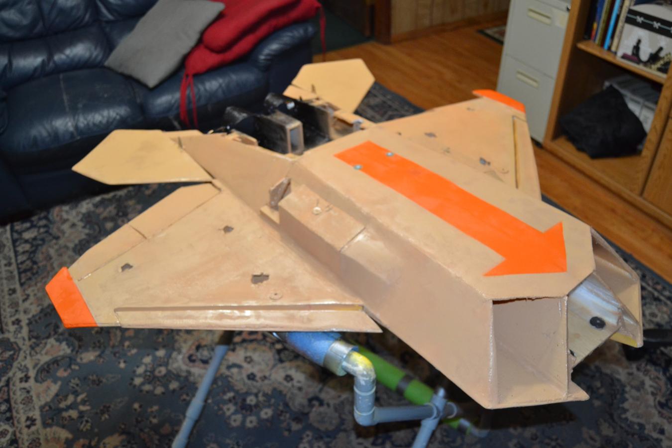

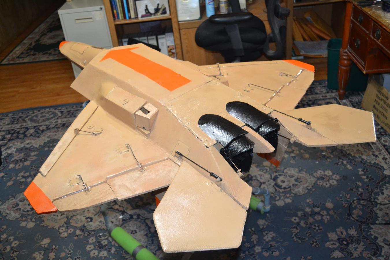

                                  Concerning making or adding Leading Edge Flaps/Slats (LEF). I am not a good scratch builder, and I decided to add LEF's to my F22 for slower landing. I added two servos and connect both to my main (right and left) flaps. I am not a good pilot and like slow flying and landings. The LEF's solvd my problem. Pics attached.

                                    Gopher,
                                    Great modification...well done.
                                    Best, LB
