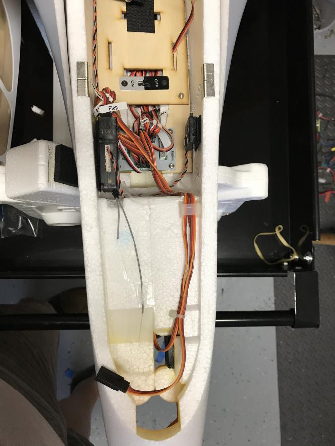

                    Like Hugh said, you will end up with the battery all the way back more than likely. I have my receiver mounted just like Hugh's as well. I put my receiver battery in the small space behind the flight battery and it flies great. The extension running to the nose of the airplane is for convenience. That's where the programming cable plugs in. I am also running a temperature probe on the flight battery. You will love this plane.

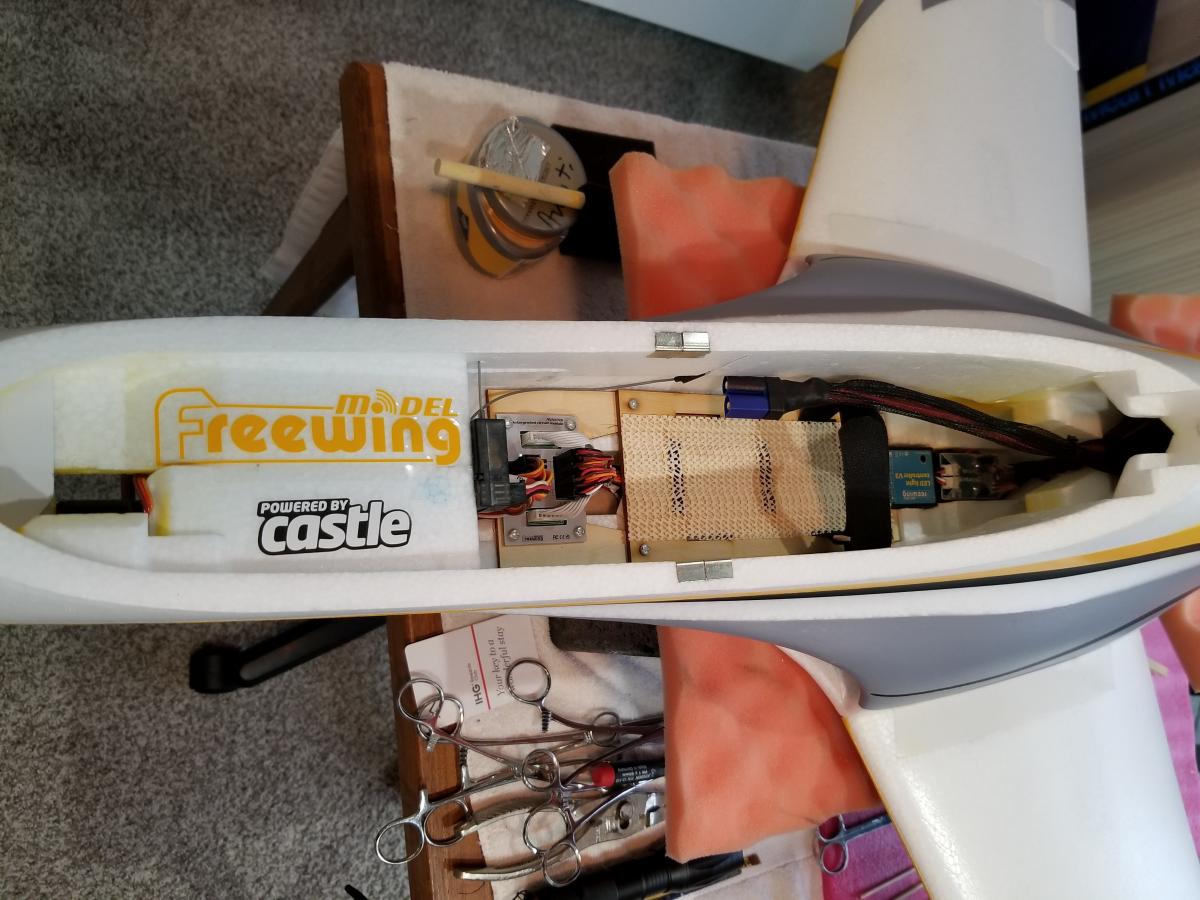

                        #2731
ID:	242649 here is what I did with the receiver Click image for larger version  Name:	20181230_124421.jpg Views:	0 Size:	127.5 KB ID:	242647

                          mr.frankenjet That is how I mount my Castle Berg 7P receivers with velcro.

                              the bergs are great receivers, still have some on 72, I run a cc10 BEC on all my larger 6cell planes to keep the power flowing to everything. I use foam-tac to mount most stuff on epu, removable if needed but holds snug.

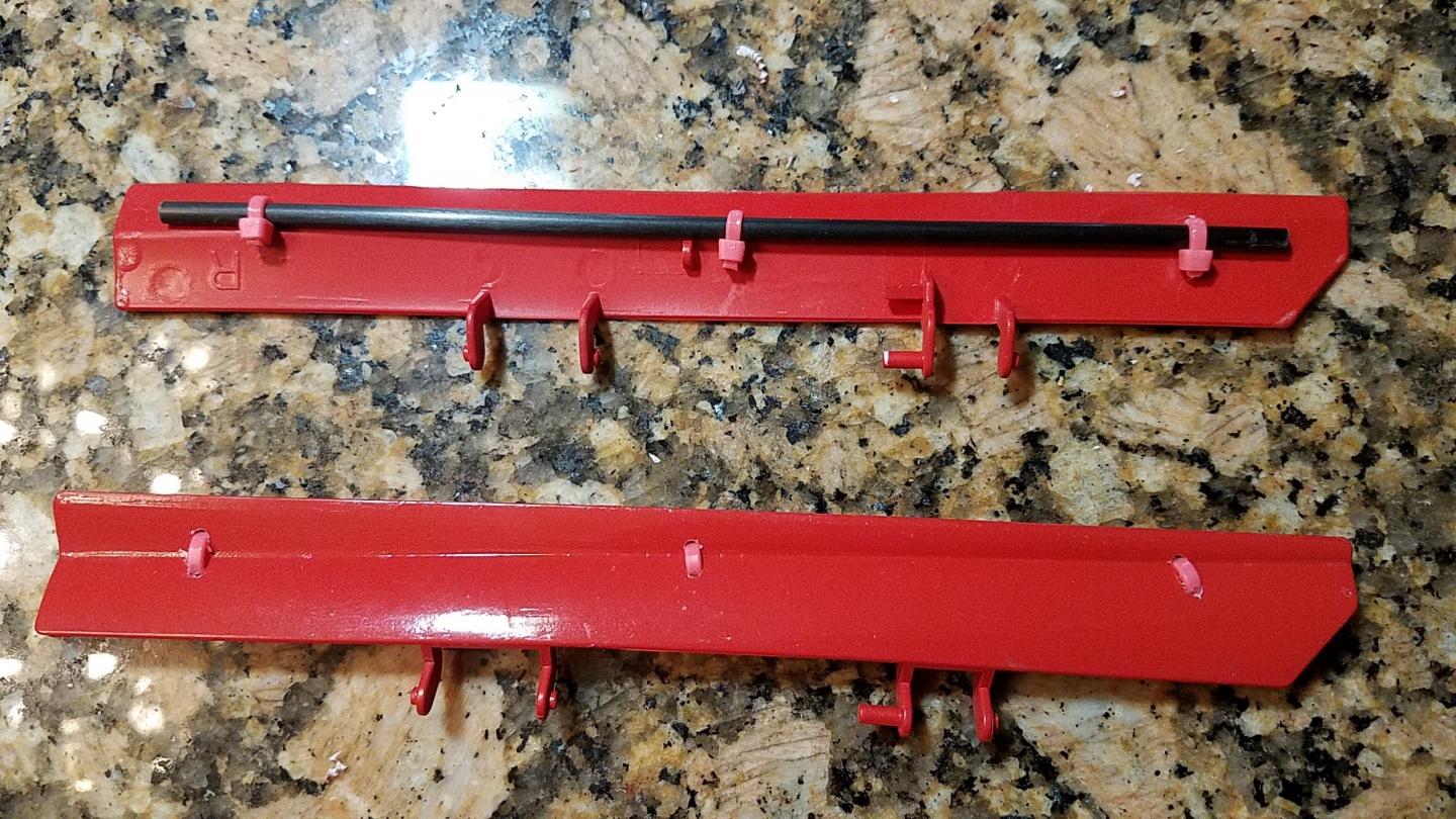

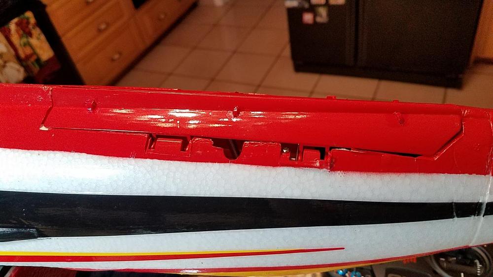

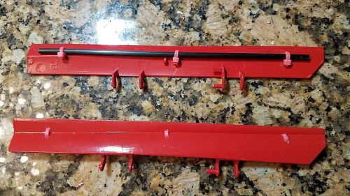

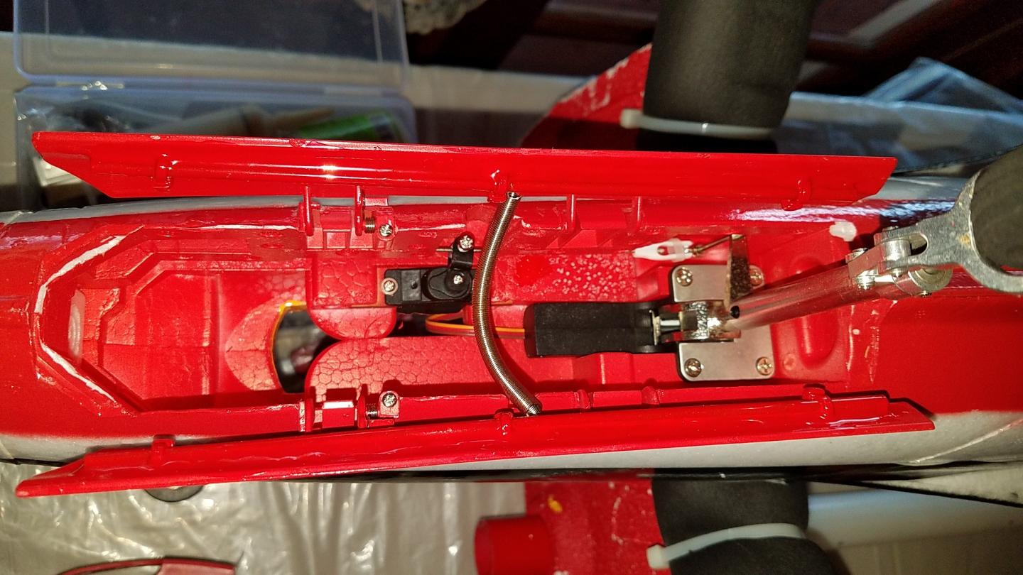

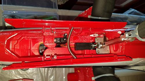

                                  With everything shut down, have some time to complete some minor repairs on a lot of planes. The nose gear doors on the Avanti have been an issue for some time, caving in to the point of ridiculousness. (forgot to take a photo first, but you get it) Doubt everyone has this problem, but I know a few do from some earlier posts. I gather that this is caused by continuous pressure applied by the spring holding them closed. I was going to replace the doors with new, straight ones, but thought that in a few months it would be same problem, so I reinforced the old "bent" ones with 4mm carbon fiber tubes, first affixed with small zip ties, then epoxied it and painted. Others have just epoxied them on, but I felt that eventually the epoxy would pull loose from the painted doors. Besides, who looks underneath the jet anyway. At least, for the moment, they are reasonably straight.
ID:	243280Click image for larger version
ID:	243281Click image for larger version
