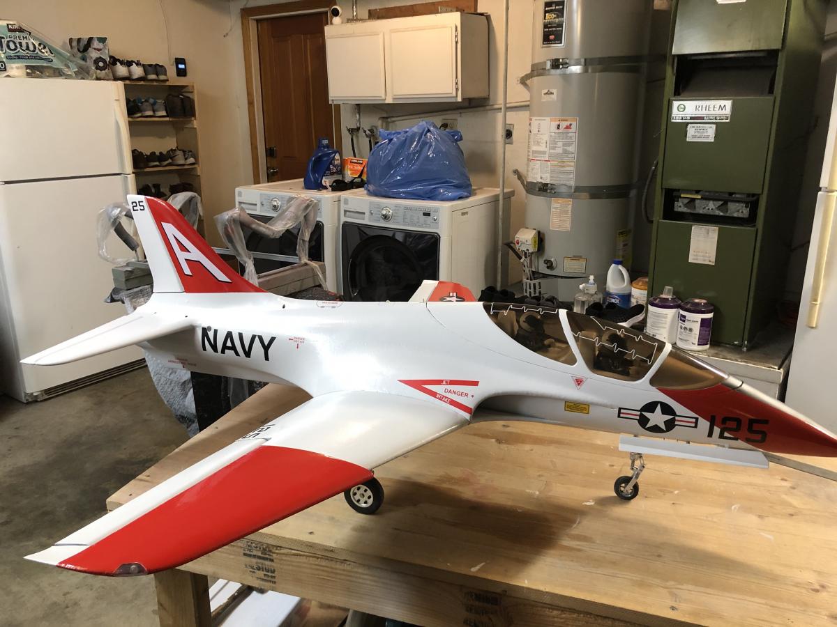

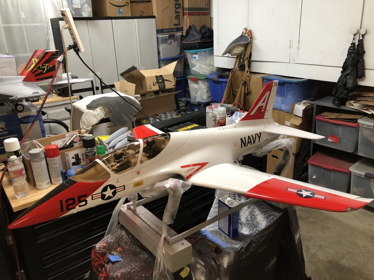

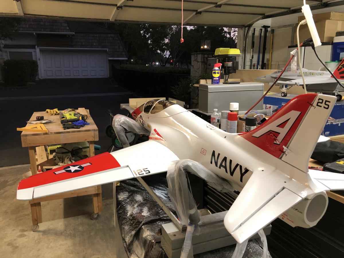

                              Hi All,
                              Just wanted to share my Avanti paint job. I’m new to electric planes and foamies. My first time working with this material, so forgive any blemishes 😁
                              Fan and motor was upgraded. Running a HET 700-60-1865 on 8S
                              The inspiration for the scheme was obviously a T-45 Goshawk, I used the decals off the Freewing T-45 with minor modifications if any.
                              Paint used was just cheap rattle can paint from my local Home Depot and then it was clear coated with a gloss enamel.
                              Hope you guys like it! 👍

                                #2875
                                xTIBSx That is absolutely fantastic, it looks very sharp, like it's supposed to be that way. I've always flown things unmodified and this last year decided to purchase fancy paints and such. I enjoy doing some customization, but my skills are somewhat lacking for now. Did you spray or brush the gloss? Any pre-coat or extensive prep?

                                  #2876
                                  Originally posted by xTIBSx
                                  Hi All,
                                  xTIBSx I too love the finish on your Avant. Same question as The Sheriff . Your 1st time working with foamies? Way to "knock it out of the Park!!!:clap: Can't wait to see what you produce after a few more attempts but where can you go from being at the top already. I've been hand brushing a clear gloss water-based exterior Spar Urethane on all of my foamies and love the look and the added durability, but I have to say, yours looks better. On the last couple I did, I applied it first on the base coat grey before painting and it made masking so much easier without having any of the base paint come off with the masking and then a final couple of coats over everything including the graphics. I thought this was the way to go, but if that spray clear coat works as good as it looks, this may be my new method. I assume you used the Rustoleum 2X clear gloss enamel spray from Home Depot over the same type of colored spray, no? I used the exterior Urethane so it wouldn't eventually yellow after long exposure to the sun, but assume that spray enamel has the same non-yellowing properties. I did try it once on a very old (15 years) foam Cub but it had a slight reaction to the paint and bare foam, but that was on foam and paint that I doubt anyone uses anymore. Did you prep the bare surfaces and existing paint by wiping it with a diluted alcohol mixture?

                                    #2877
                                    That's a good looking Avanti!

                                      #2878
                                      Thank you for the compliment! I think the theme worked well with this plane because the original designer of the Avanti drew a lot of inspiration from the BAE Hawk. So the shapes were similar. I was inspired to go with this theme because the Avanti is what I used as a "trainer" airplane to learn how to fly RC again, and the T45 is a military trainer aircraft. So I put 2 and 2 together. I flew RC for a long time, but I took a long hiatus off this hobby only just getting back into it this last January 2020. I decided to refinish my Avanti because after only a few flights on it, my decals were falling off and the original paint job was just so terrible, it had overspray everywhere and just did not look nice.
                                      The clear coat was a just a cheap rattle can gloss enamel...specifically Rustoleum's Automotive Clear Gloss. If you chose to refinish one of your planes, be careful using this clear, it DISSOLVES decals (don't ask how I learned that 😓) you have to spray it on lightly first and let it dry. DO NOT TOUCH THE DECAL UNTIL THE CLEAR IS DRY! If you get any runs and it's over a decal, you have to leave it alone, don't wipe it. You'll ruin the decal. Once dry and the decals are stable, you can clear the plane like normal.
                                      Prep work was done with filler primer, regular primer, scrap foam pieces and lightweight spackle. I first filled gaps, holes and unevenness with spackle. If the area that needed filling was big, I glued scrap pieces of foam in it and then sanded it even, finishing it with spackle and then priming the whole thing.
                                      When it came to priming, I used filler primer first, which I then sanded down to Where I could just start seeing the foam coming through, then I primed again with regular primer and sanded smooth. Then it was painted.

                                        #2879
                                        Thank you! I used Rustoleum Automotive Clear Enamel (Gloss). No specific reason why I chose that particular one. Mainly just cause it was cheap and easy to obtain. I did this as my quarantine project. Lots of stores were closed in my area but my Local Home Depot was open so that's why this paint. I suppose I could've bought nicer paint online...but being my first foam refinish, I didn't want to spend too much in case I really sucked at doing this and also I didn't want to wait for delivery Lol.
                                        In regards to prepwork, I forgot to mention in my reply above, PRIOR to filling gaps/dents and priming, I stripped the original decals (what ever was left since they started falling off after the 4th flight) and also stripping the original paint using acetone. Nothing too crazy....just removed enough paint so that the new primer and filler would be mostly on the bare foam. I noticed that the original paint seemed to come off easily with just regular handling, I was afraid that priming and painting over it would result in the new paint chipping.
