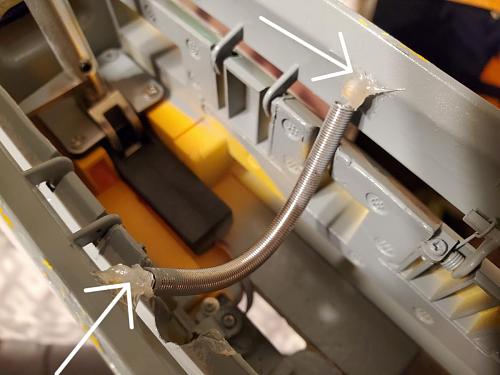

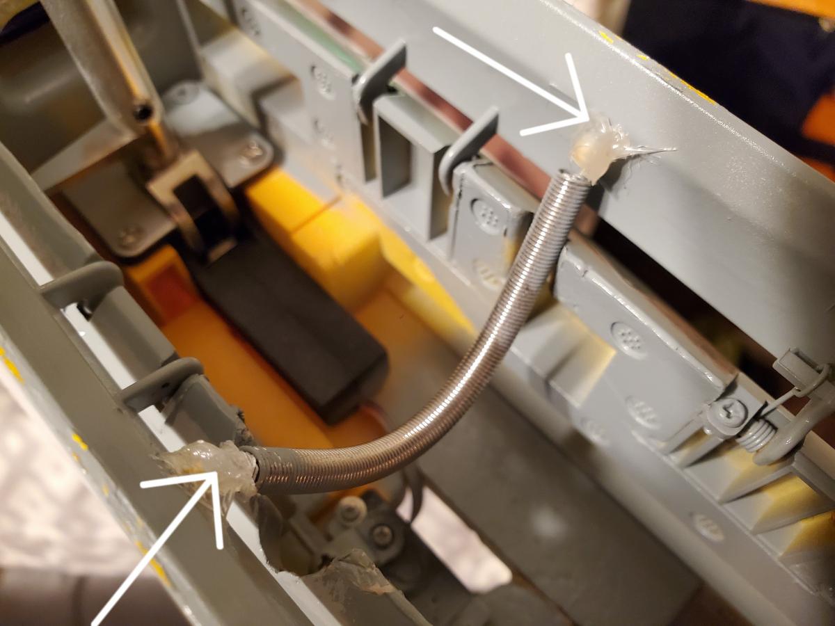

    In addition to the regular checks above, adding some glue (I prefer hot glue for this in particular) to each mounting tabs and end of the spring on each nose gear door. This locks the spring into its proper place (you would want to have the aircraft on a stand inverted and place the spring in the proper spot prior to gluing). This prevents the spring from rotating around out of its ideal position, and when in the proper place the nose doors close and open more reliably and more evenly. The picture below shows it best.

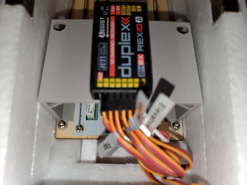

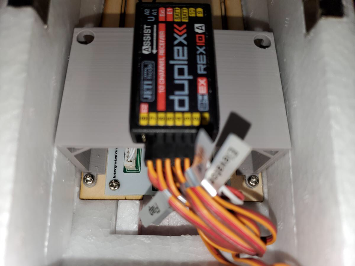

    I didn’t like the positioning and space to place my receiver and any telemetry equipment, gyro, etc., so I made a simple RX/Gyro tray for the Avanti that can be 3D printed, and is available on Thingiverse in the link below.
