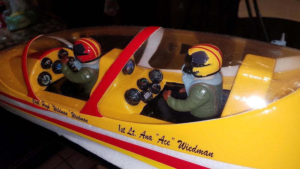

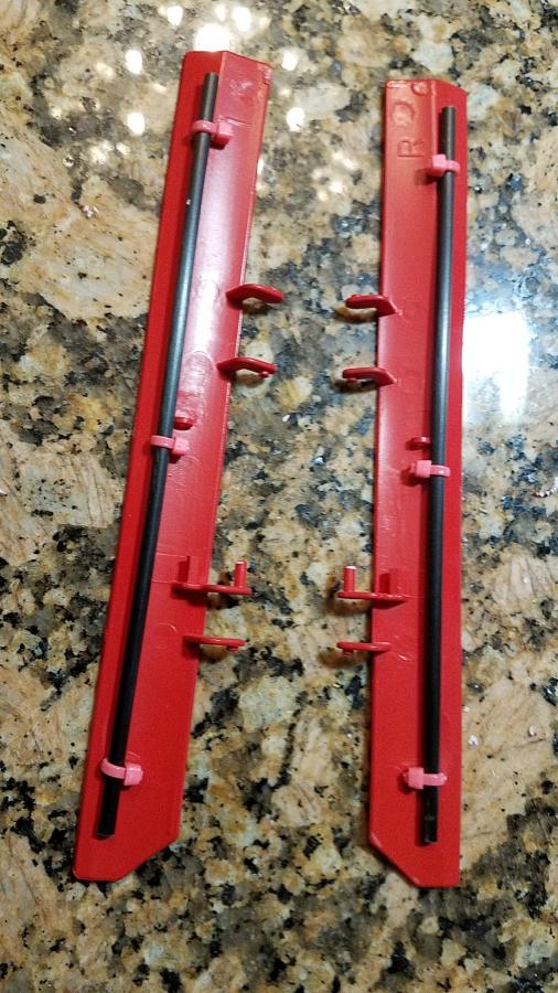

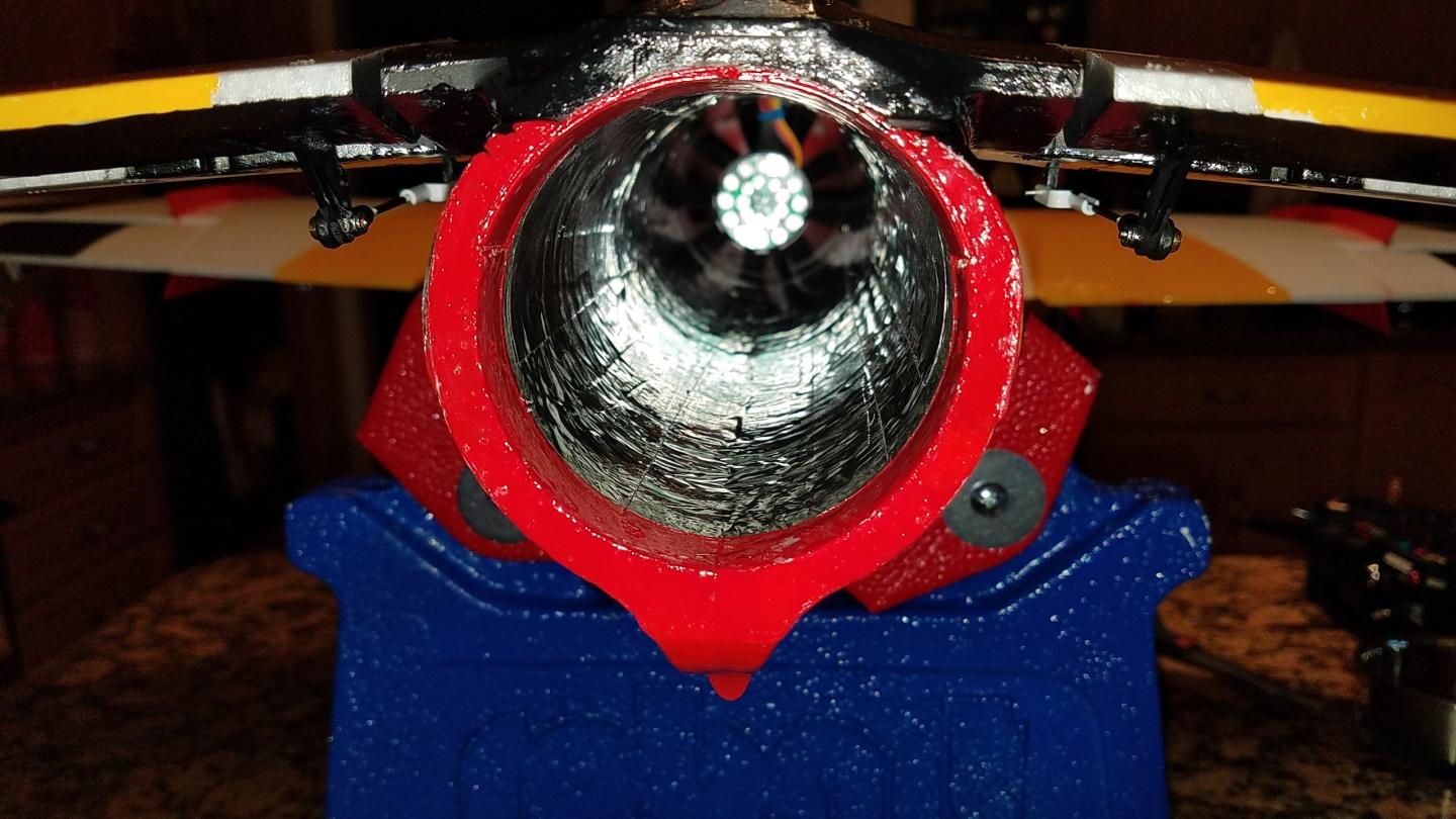

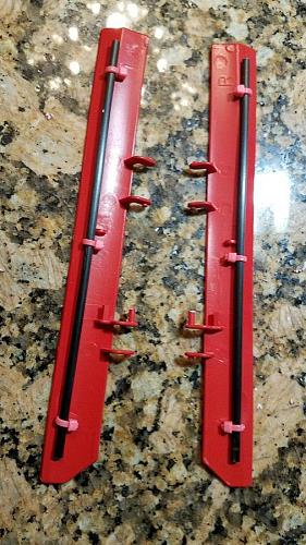

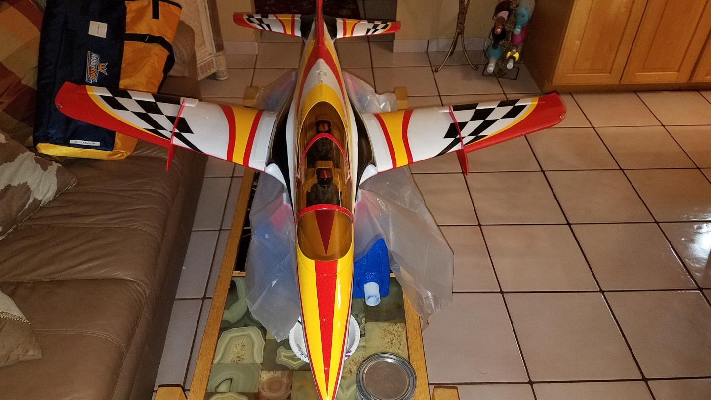

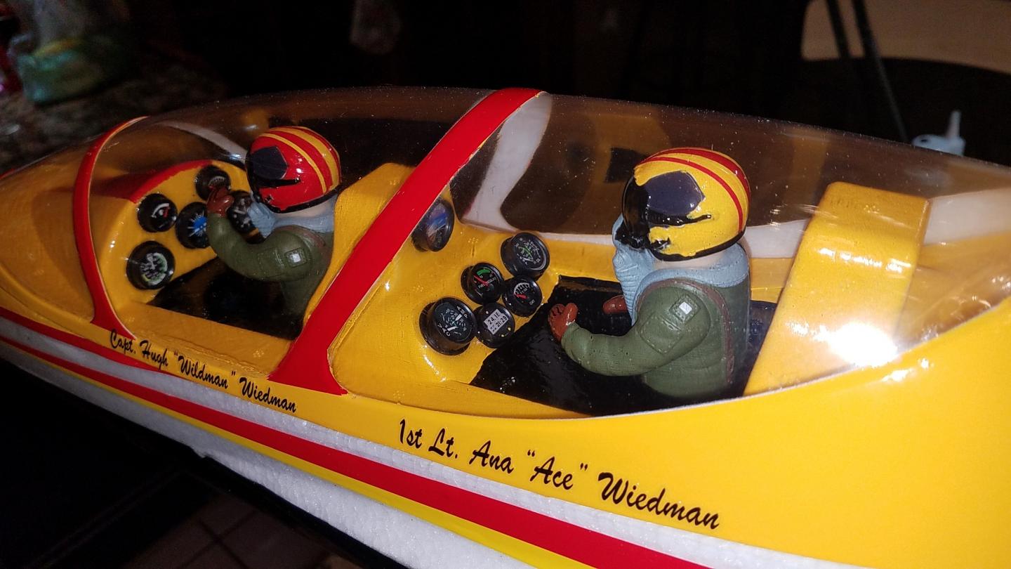

                                  For me it didn't need a lot of mods, just an outstanding flying sport jet. Gets over 5 minutes of aggressive flying on a RT 6250. Lands easy, takes off of grass in a short distance and can knife edge all day long. Very easy to get into a slow high alpha and stay there until you punch it out.
                                  I did do a bit with the cockpit and added 2 pilots, added a little extra paint and covered the entire jet with 4 coats of clear gloss spar urethane, added an afterburner just for the hell of it and did add some carbon fiber tubes to the nose gear doors because after a while, the spring holding it closed bows the doors in. Some reinforced the base of the nose gear retract, but after 150 flights I haven't had an issue so it is still stock.
                                      Excellent job! The pilots are awesome.

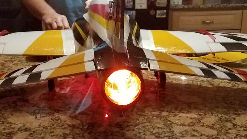

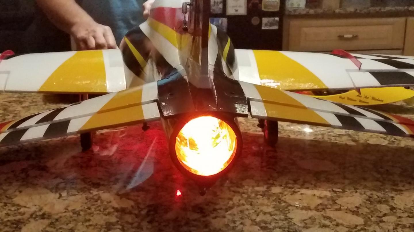

                                        1. A popular "burner" mod is available from the RC Geek:
                                        https://thercgeek.com/the-centerburner/
                                        That's the one I used, have them in all of my EDF's except the A-10 (but I sure wanted to but got talked out of it since the A-10 does not have them-but then my Stinger 90 and Avanti probably shouldn't either but who cares, they look too cool to go without them). Also it helps if you line the exhaust nozzles with Aluminum AC tape, shines even in bright sunlight!
