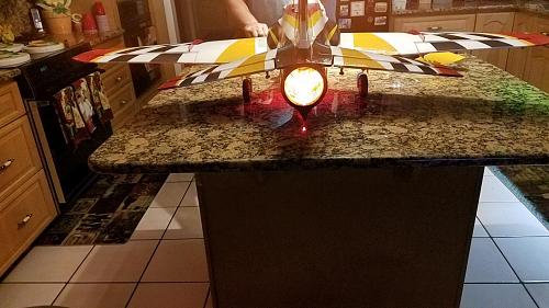

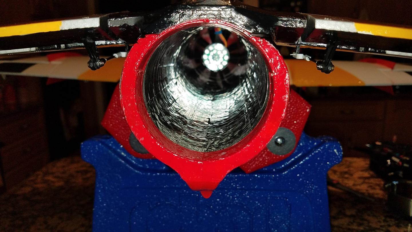

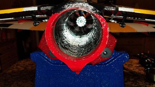

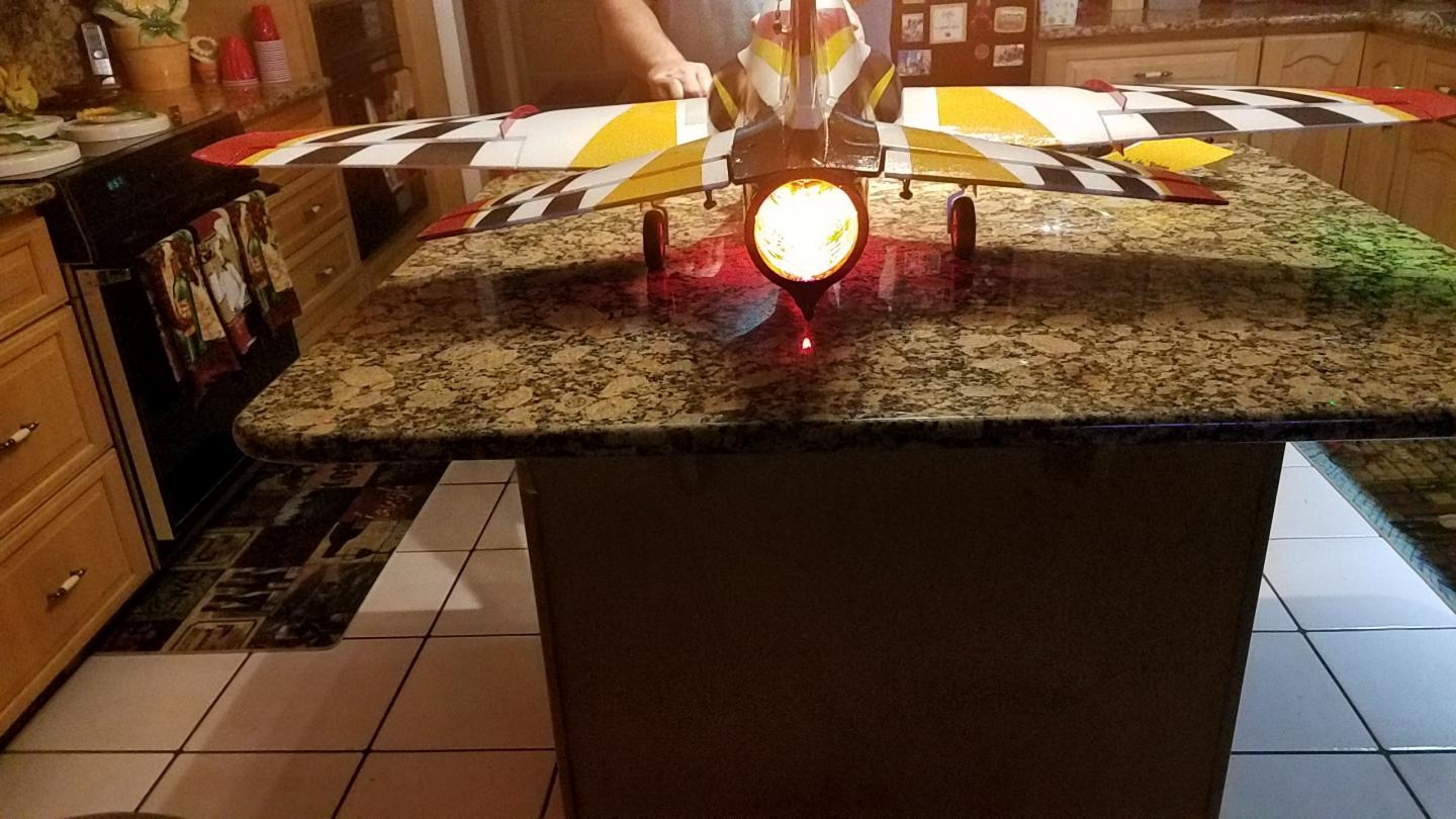

          I have the RC Geek in all my EDF'S except the A10. When you order, send in the comment section to Chris exactly the fan you have, inrunner 80 mm so if you pick the wrong one he will correct it. The fans in the Avanti have changed several times so be specific. Also, I suggest you line the nozzle with highly reflective paint or better yet A/C aluminum foil tape.
          Click image for larger version  Name:	20191002_180354.jpg Views:	0 Size:	150.6 KB ID:	299373Click image for larger version  Name:	20191002_205620.jpg Views:	0 Size:	159.4 KB ID:	299374

            Same here Hugh, AB always from Chris, super nice guy ever and the products works great all the time. Never had a single problem, not on single or twin motor. On the bad side, now i can’t have a jet without. .
            thank you Rc geek

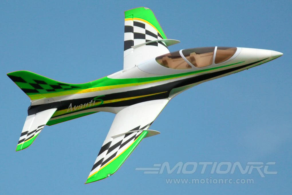

                I've got 10 flights on my new Avanti. Last flight was a follow the leader with 3 other Avanti's from take off (simultaneously) to landing. It was a hoot and I'm sure we'll do more of that. But with all the Avanti's at clubs -- it sure would be nice to have a livery with a different (or two) colors. I use photoshop to play with some options and think optic green would be awesome.

                  I like that color, but I like my red more. But it gives me something to think about for the next one (yeah, there will be another one when this one dies).

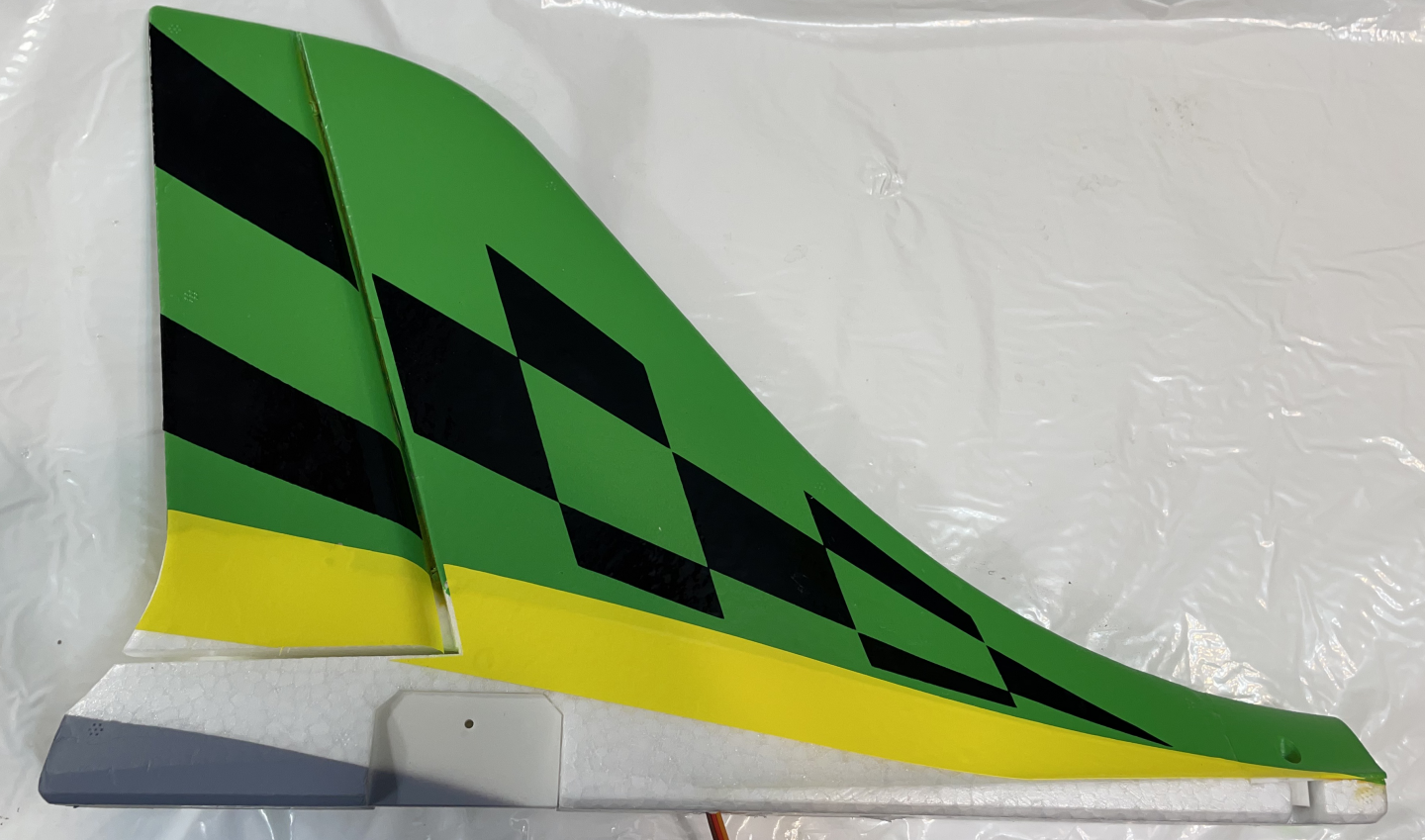

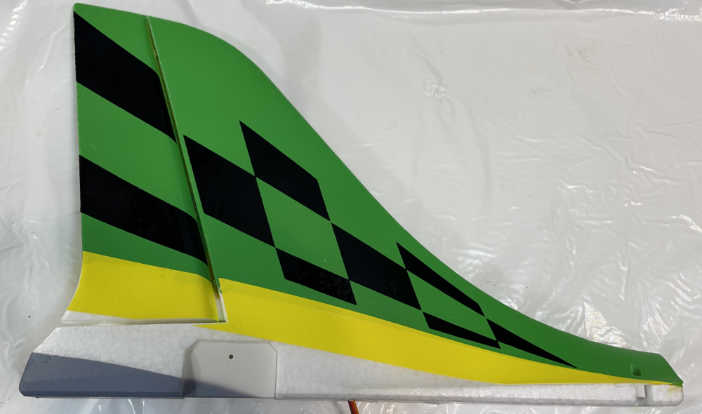

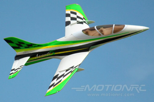

                              I posted awhile ago that I wanted a green Avanti. I'm good with Photoshop, but have no experience changing the color of a foam model for real, but concluded that if I wanted a green Avanti it was up to me. I bought a yellow ARF+ and commenced to learning. I opted to use Liquitex fluorescent green rattle can and I'm cutting my own vinyl. I've finished the vertical stab. Have two wings painted, now doing graphics.
                              I would like to put a better than stock power system in this and would appreciate recommendations. I want it to be a 32mm inrunner and 6S setup. The reason for the 32mm inrunner is I bought a afterburner setup for it.
                              Click image for larger version  Name:	Avanti Stab.png Views:	1 Size:	1.08 MB ID:	305058

                                Good job, Scott. The green color looks nice.
                                If you want a different EDF and Motor that fits your preferences, then take a look at purchasing the FMS 80mm 12-Blade with 2100kv Inrunner motor (32mm diameter). As for an ESC, a Hobbywing 100A will suffice and is the common ESC brand Freewing tends to use on their PNP jets. Keep in mind though that the FMS EDF/Motor above can push the limits of that 100A ESC (FMS tends to use 100A ESC’s with the power system mentioned), so smart throttle use is beneficial, keep the ESC in the stock location on this aircraft for good airflow, and then determine whether you want to use an internal BEC or external BEC as your preference.

                                  Ive used both acyrlic paint and iron on Oracover film on EPO foam models and definitly recomend the fillm over paint. The finish is much better and it adds protection to the foam making the model look as though it is a composite model. The 2 you tube clips below will help. Start with you iron on low temperature setting and gradualy increase until you find the 'sweet spot' where the adhesive melts but the film retains its gloss finish. Don't worry the EPO is very temperature resistant. Good luck with it.
