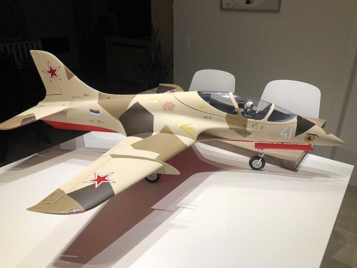

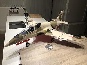

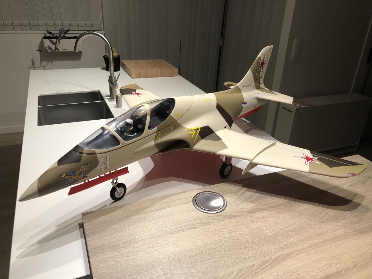

              • really nice camo scheme, arabs Mb339 are similar?
                here is mine (still stock paint) from today

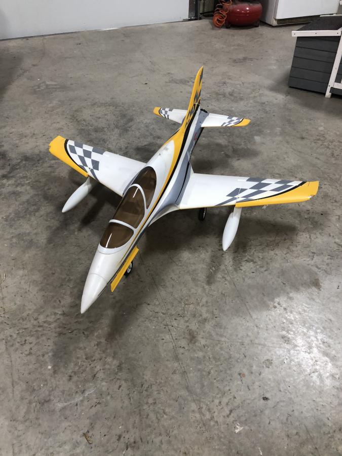

                    • Printed some tanks. Haven’t tried it yet.

                                  • Tried the new tanks today. I didnt see any difference with them on. This jet flies just as good.
                                    the printed mounts are holding up.
                                    paul
                                      Nice flight, she definitely is a sweet flying machine. Noticed he used the SMC 5000's. I actually use the even larger SMC 6200 for even more "funtime flyin". It handles the extra weight with absolutely no ill effects.
                                      Very cool! He tends to use a variety of sizes, including the size you mentioned, and he loves them all with this jet :D
