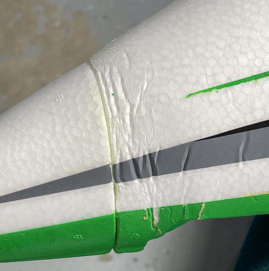

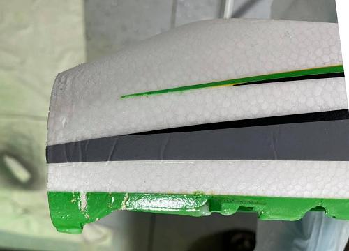

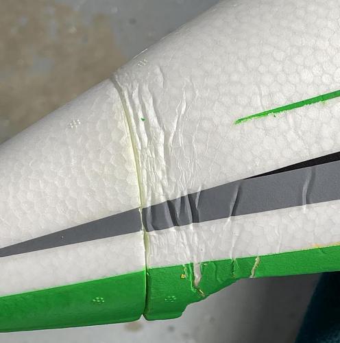

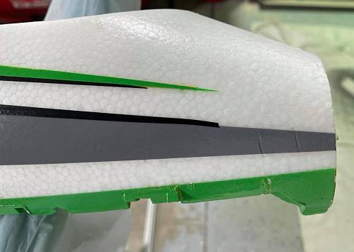

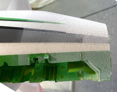

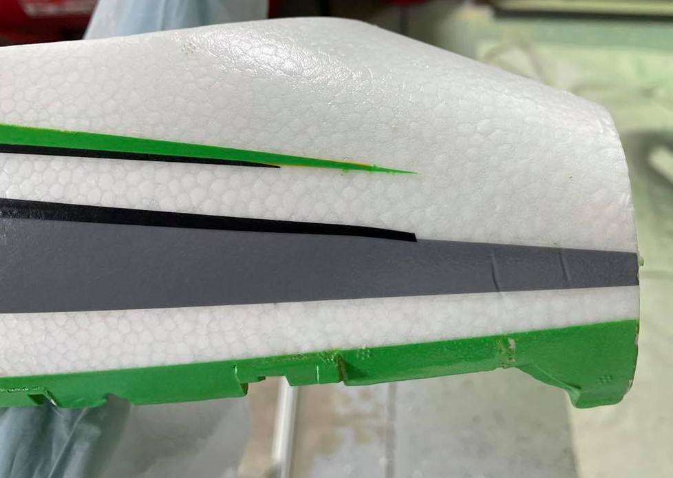

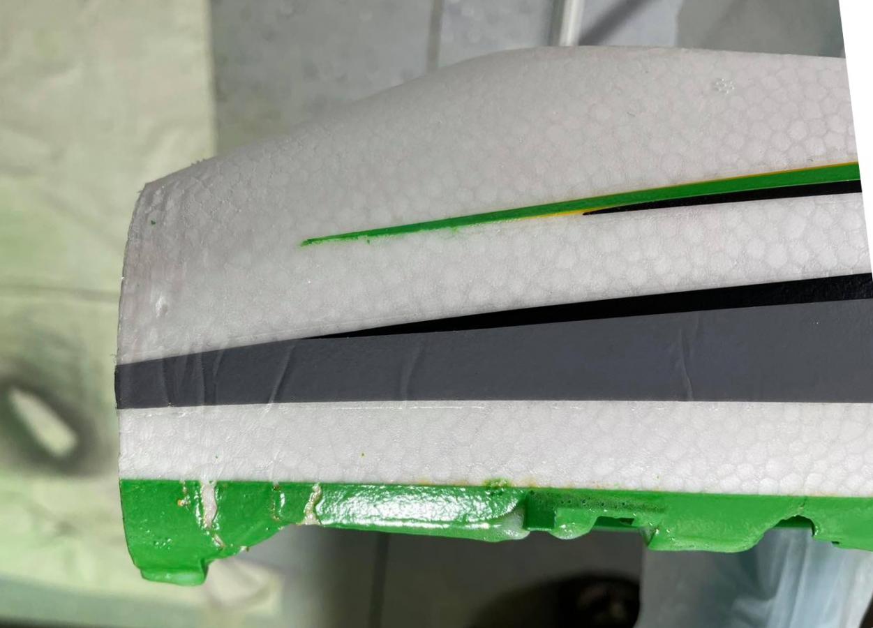

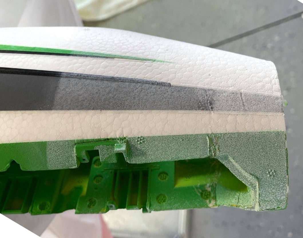

          Here are some lessons learned that others may benefit from.
          I was painting my next Avanti -- Had just finished application of clear coat - the final step in the job and when hanging the fuselage I dropped it on the nose (without nose cone on). To make matters worse - when trying to catch it I missed the catch and propelled if even faster into the the concrete floor. (insert angst here)
          From the RCG Avanti thread I learned that the optimal temp to water bath this foam is 170F. At 180 the foam will gator. So I used my sous vide water bath to precisely set the temp to 170 and bathed the nose for about 5 minutes. It worked -- except when it dried the clear coat had become cloudy. (insert angst here).
          So I applied another fairly heavy coat of polycrylic to the affected area and the cloudiness went away. (insert much joy and dancing here).

          Here is the nose after my painting accident.

          This is the nose after the water bath.

          Left side (the worst) after water bath and re-applying Polycrylic

          Right side after all was said and done. This side looks almost as good as new.

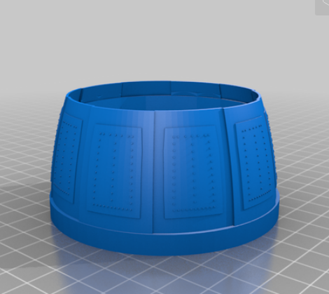

                I added anther nozzle to the set I posted for the Avanti. This one based on the Rafale's nozzle.
                https://www.thingiverse.com/thing:4785745

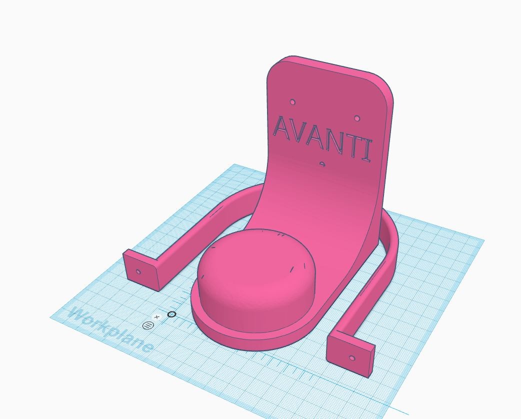

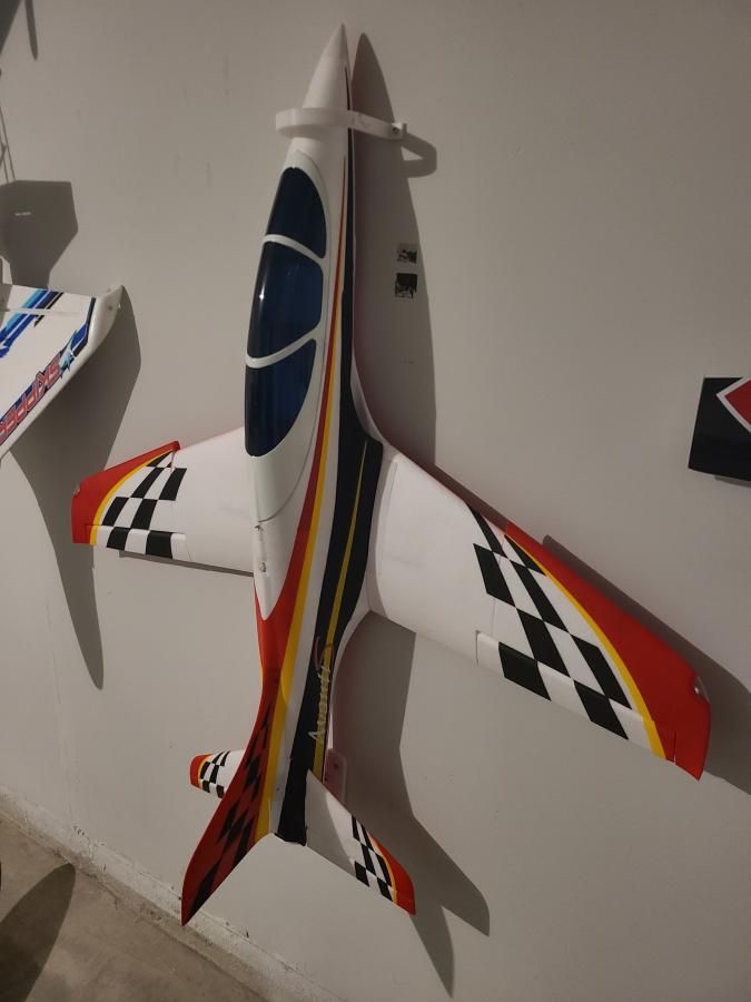

                  Avanti Wall mount

                    Originally posted by bandetx
                    Avanti Wall mount
                    STL file?
