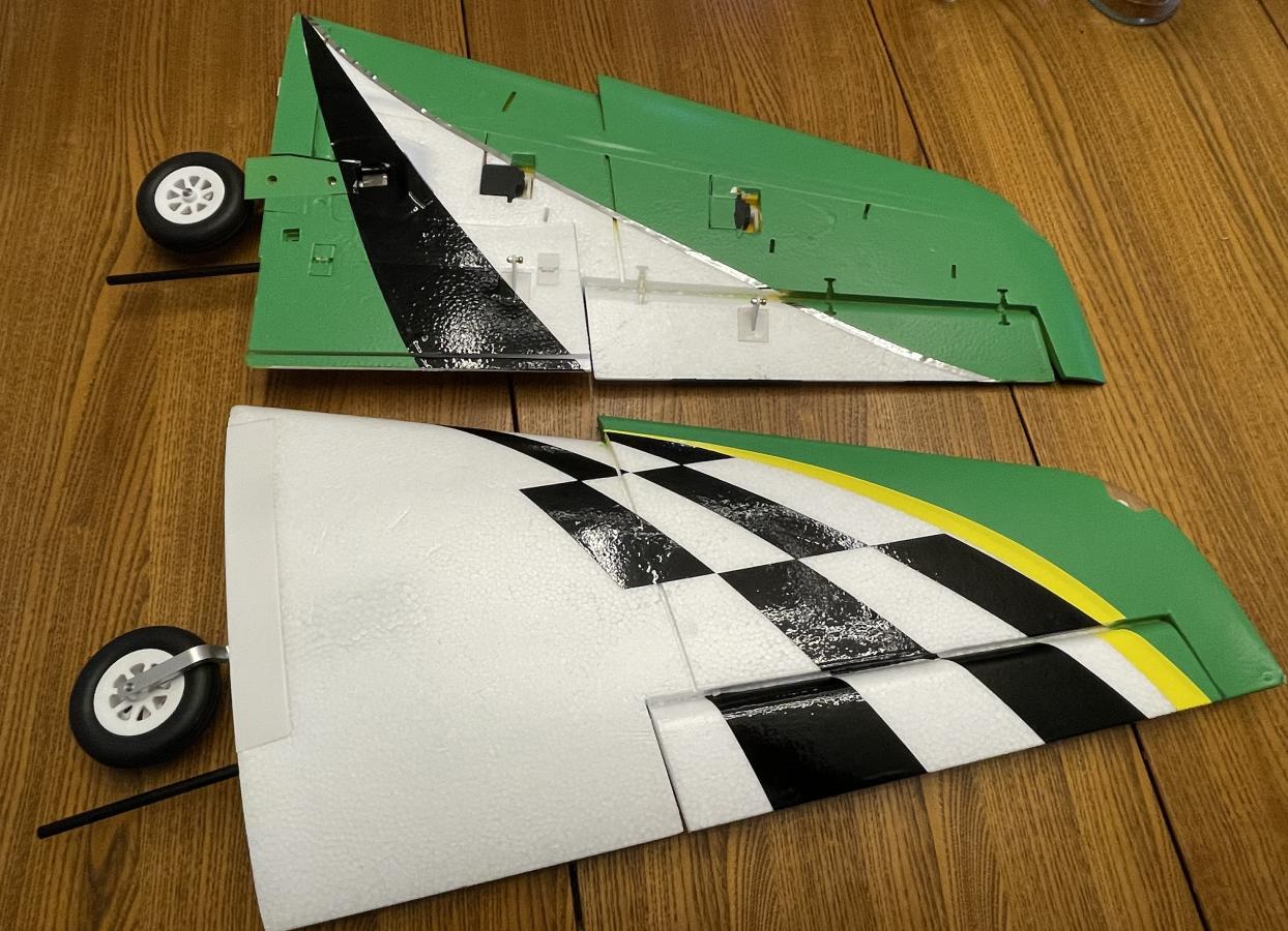

    It would seem that way however I changed plans for the green Avanti once things progressed. I'd purchased the Afterburner for my red Avanti that I started with. I'd planned to put that airframe to an early retirement and move the power system to the ARF+ I'm painting green. However as things progressed well with the Green Avanti I decided to purchase an additional power system and have both a functional red and the new green. I ordered a Castle Phoenix Edge 100A ESC and Freewing 80mm 9-Blade EDF Power System w/3658-1920kV Inrunner Motor. I could not find the FMS system recommended above to buy in the states (except on Amazon where they wanted $200) - so I guess this will be close to the stock fan/motor with a premium(ish) ESC.
    Making slow progress - nearly finished the wings today - however I'm not happy with the way the chrome pinstriping looks in the curves. It puckers.Click image for larger version Name:	Avant Wings.jpg Views:	0 Size:	175.0 KB ID:	305356
    Scott have you considered using A4 self adhesive signwriters vinyl sheets( Ebay ) in gold or copper to compliment the green they are about $2 a sheet

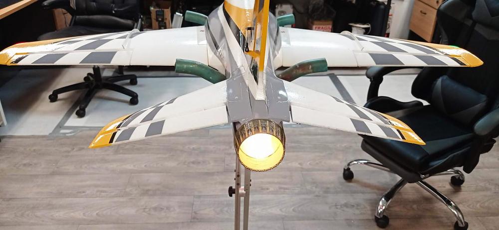

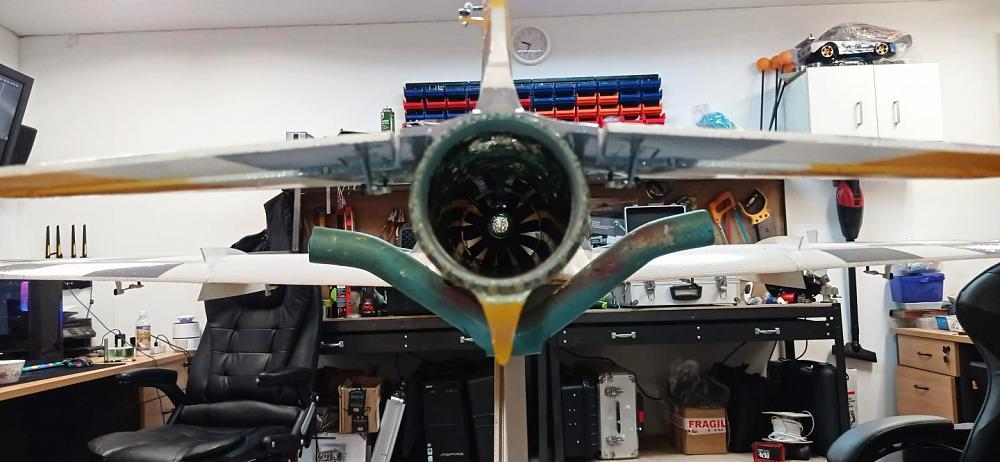

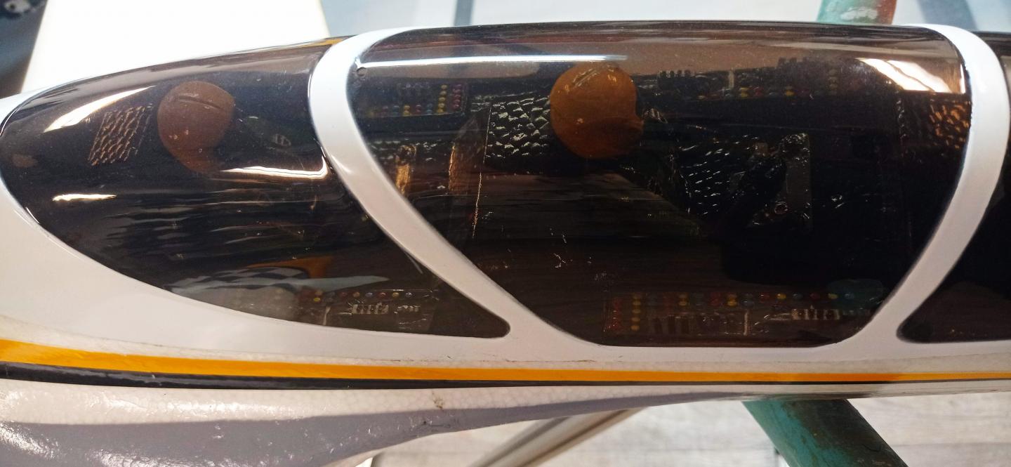

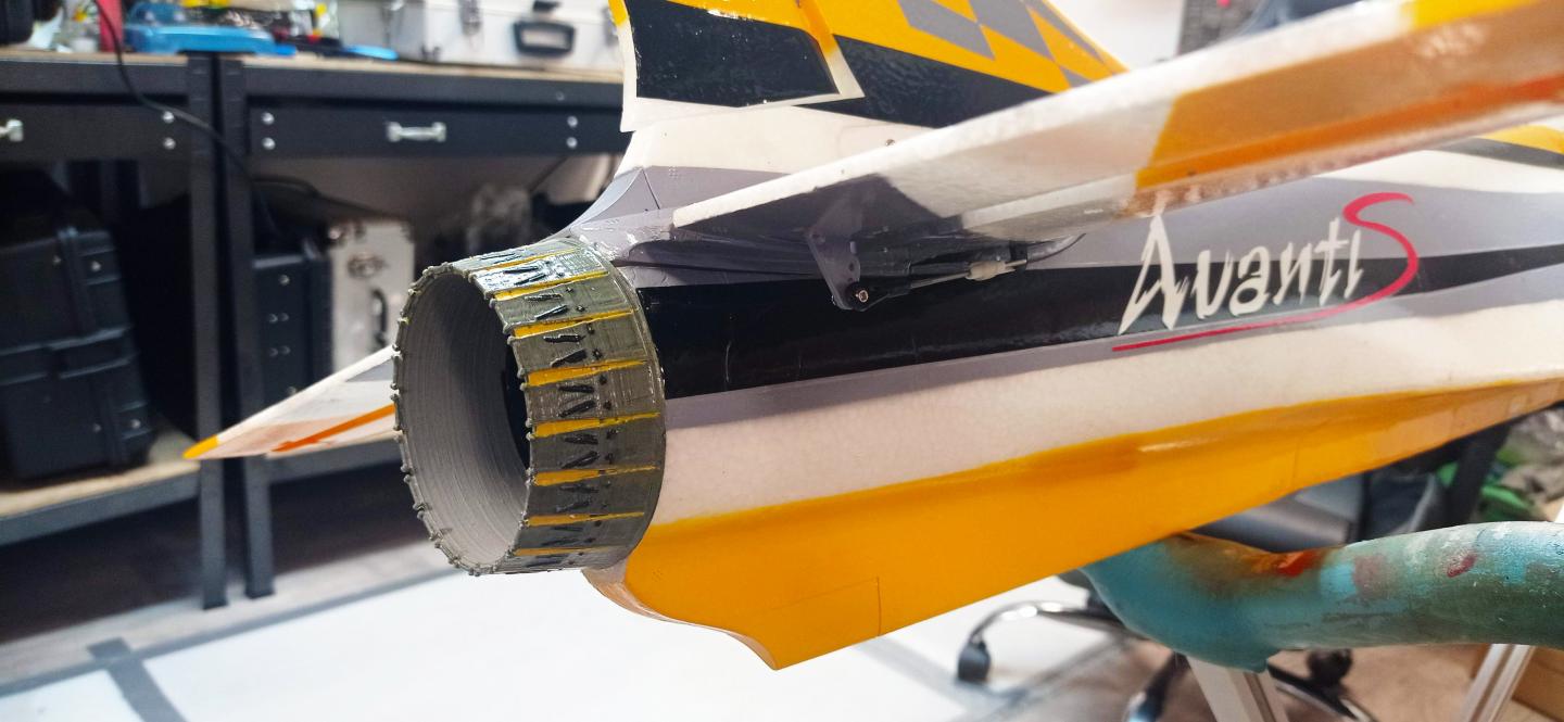

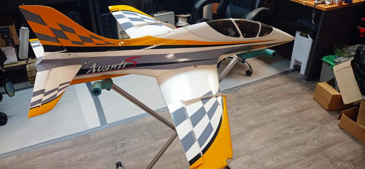

                This is my Freewing 80mm Avant with 3D printed Exhaust Mod & 3D printed detailed pilots with instruments in the cockpit cheers.

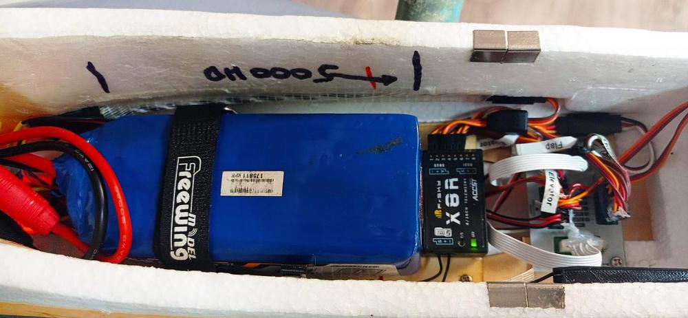

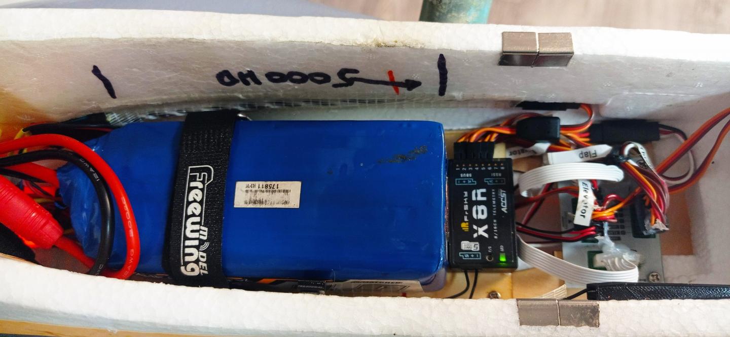

                  Click image for larger version  Name:	Turnigy 5000mah heavy duty batt placement.jpg Views:	0 Size:	109.6 KB ID:	307001
                  Hi Nick
                  She will fly nice on a 5000mah pack just adjust according to the cg in the book don't copy exactly where mine is because i have a center burner in the rear also the 3d printed exhaust so mine is a little more forward.
                  Cheers

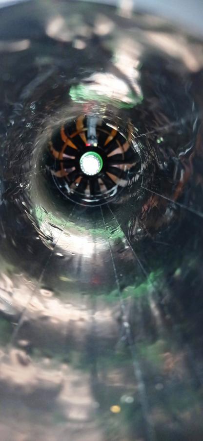

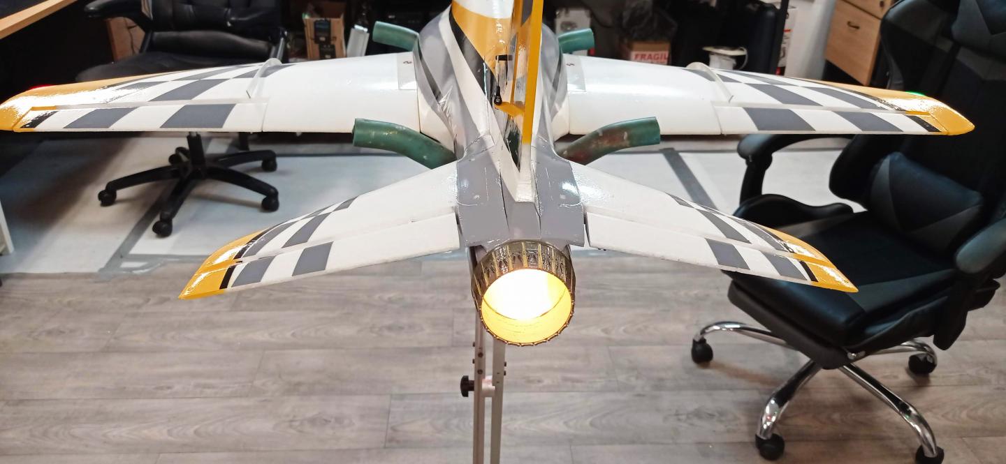

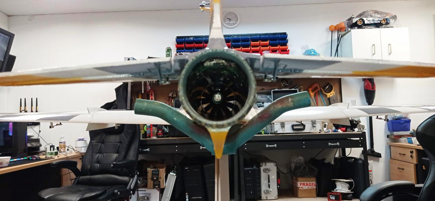

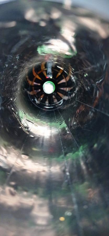

                    Hi Hugh
                    I have also put in a Center burner that i have made my self, similar to the Light burner it has a 12v 144smd led light and is super bright in the day,Check i out.
                    The 3rd pic of the led on only at half throttle so will go brighter at full throttle.
                    Cheers
                    Click image for larger version  Name:	1617447382401.jpg Views:	0 Size:	109.7 KB ID:	307005Click image for larger version  Name:	1617447382384.jpg Views:	0 Size:	41.9 KB ID:	307004Click image for larger version  Name:	1617447382369.jpg Views:	0 Size:	101.2 KB ID:	307003

                          Con Papaioannou love your printed nozzle with the afterburner. Great installation of the aluminum foil; makes a big difference on this one with the long exhaust tunnel. Wouldn't have an EDF without AB's, even if it's not "Scale" and the only EDF I don't have them in is the A-10. Even one in my Stinger 90!

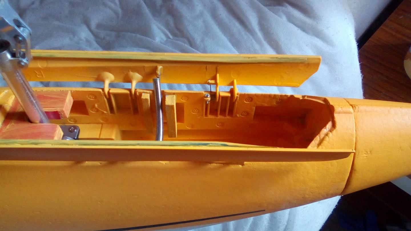

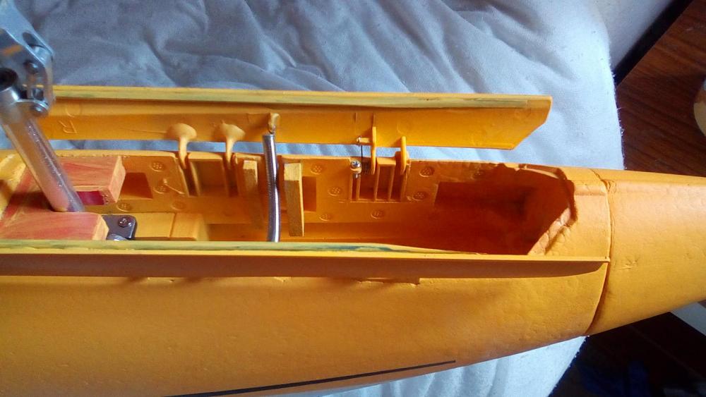

                                My last flight with my Avanti S resulted in a minor molecular alignment at the front end so I decided the best way out was some minimal filler and yellow paint.. I also lost one of the tension springs and not wishing to pay a fedex £12 admin fee from the EU to UK ( excluding the cost of the spring and postage ) I found some piano wire of the right size and strength in my scrap box and made one. A bit of epoxy on the door tabs and the main spring to keep it in place along with a couple of balsa guides for the spring plus a bit of cf rod to stiffen the doors and I am ready to go.

                                  Hi Mate
                                  There is a simple mod by using a rubber band to hold the front door spring so it doesn't invert forward & also it keeps it up so it doesn't move or spring off.
                                  Some simple mods link below
                                  Cheers

                                    Thanks Con , I thought of that but rubber perishes, the way I have set the epoxy on the main spring does stop it from inverting or moving forward, the balsa is just belt and braces

                                      Very creative on the balsa to keep the spring lined up, you architects are just too clever to be allowed to roam around freely. I also put cf tubes on the doors to keep them from bowing in and it seems to have solved that issue.
