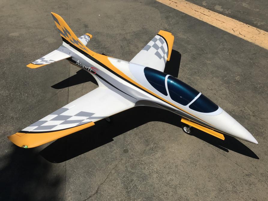

Just got back from a highly successful maiden and three successive flights. Holy crab cakes this jet is SWEET!!!
I used the Admiral 4000 for the maiden. CG at 110mm. Flew on low rates which were still a little sensitive so I dialed them back on the other flights. This jet is ROCK SOLID. By far the most stress-less maiden I can remember. Takeoff roll is on rails, flies on rails, needed just a click or two or right and it was like it was my 100th flight with her. Incredibly floaty with flaps, so much so I dead-sticked the landings on the 2nd, 3rd and 4th flights completely. (I have a high approach over a tree line which affords me the opportunity with a jet as floaty as this). What more can I say that hasn't already been said? It's really hot today so I am going to wait until dusk for my next flights. Wow, this thing is a home run any way you slice it. I couldn't be more thrilled!

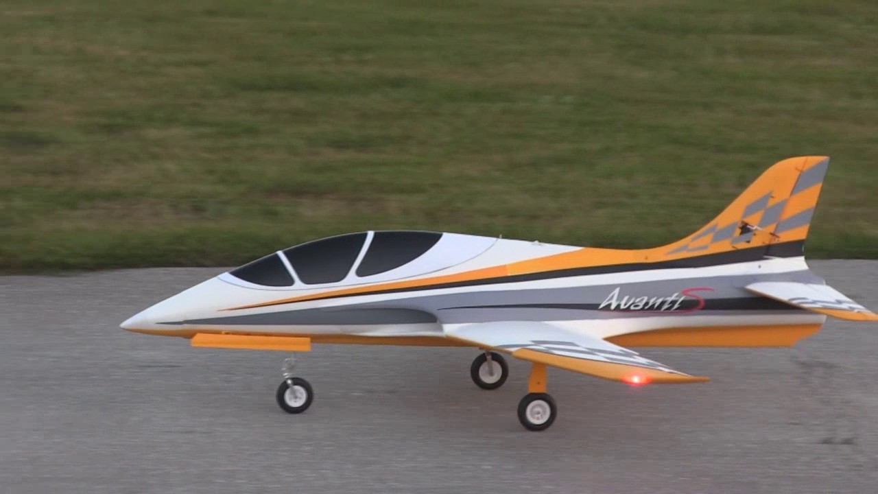

Morning flights with Doug. I got razzed on RC groups forum by a few guys so I removed two of the whistles as the sound did sound like overkill on the slow flybys. The single mid sized Nerf Vortex football whistle sounds best to me, blending in with the jets own sound. Doug and I discover that wheelies are indeed possible as the onlooking owls tilt their heads in puzzlement.Doug maidens his Avanti. I remved all but one Nerf vortex football whistle, keeping the middle sized one since it seems to blend in with the natural sound of...

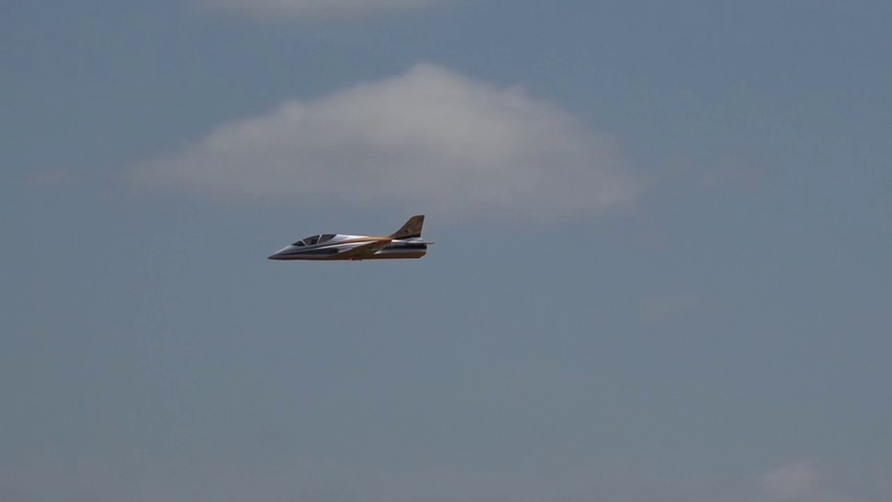

I got my maiden flight in, and four more flight after that. Everything went without a problem. A little elevator trim and aileron trim, and completely rock solid. It makes you so comfortable actually, that I felt more than safe to do aerobatics on the maiden. That speaks a lot about the plane. I've already said a long bit about the great aspects of the plane in this thread on a post long ago when I had only one flight on Alpha's production model. I loved it then, and I REALLY love the jet now after getting more stick time on it. I used low rates for aileron, and middle rates for everything else. The ailerons even on low are MORE than enough to do virtually any aerobatics you want it to do that involves them. The middle setting of throws on the rudder was enough to do knife edge fine, and elevator had plenty of authority on middle rates as well. It lands gently, flaps work fantastic for slow flight, and I went without any mixing at all on flap to elevator for pitch. Slowed down enough, drop the gear, wait, feed in flaps, and I didn't notice any significant pitching. The trailing link struts worked great and made landing extra nice and delicious. My 6S Jetfan setup I assembled and installed worked flawlessly (although I tested the heck out of it ahead of time just in case), and is faster than my modded Stinger 90 with a more aggressive power system. For reference, I am flying mine with a very heavy 900g 6S 5000mah battery and with the extra weight of the aftermarket power system, I virtually needed a battery that heavy to balance well as I only have a little more room the move forward. The plane handed the added weight completely fine, and almost unnoticed. I installed an afterburner ring and ran the wiring through the top of the fuselage and then under the battery tray, and that also worked out great, thankfully. I decided to try the blue canopy on for style. It's growing on me. I ordered a few canopies just to paint a bunch and see which ones I like most and want to interchange from time to time.
To sum it up :), this is by far the best PNP jet I've ever flown for the money. Hands down....not even a contest.

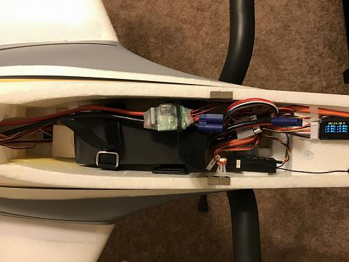

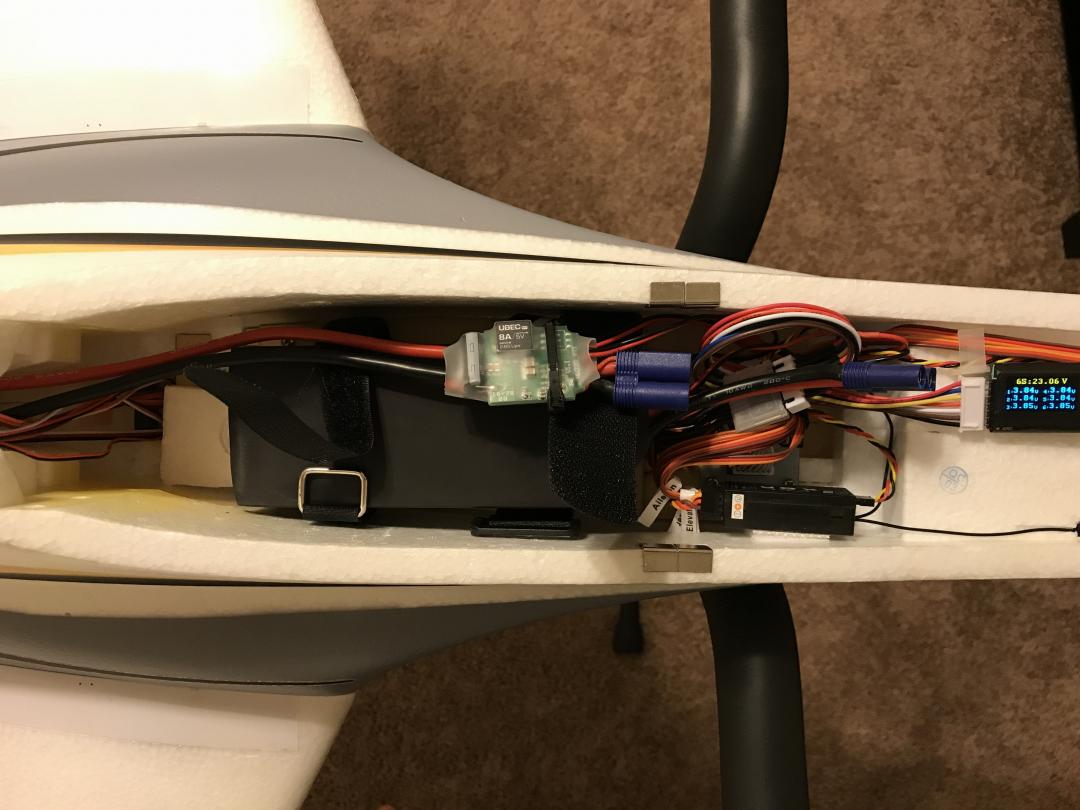

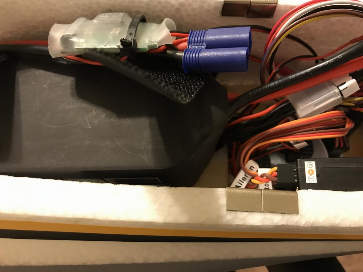

For reference, I am flying mine with a very heavy 900g 6S 5000mah battery and with the extra weight of the aftermarket power system, I basically needed a battery that heavy to balance well as I only have a little more room the move forward. I also have the small weight of the AB light providing a bit more weight to the rear as well. The plane handed the added weight completely fine, and almost unnoticed.
