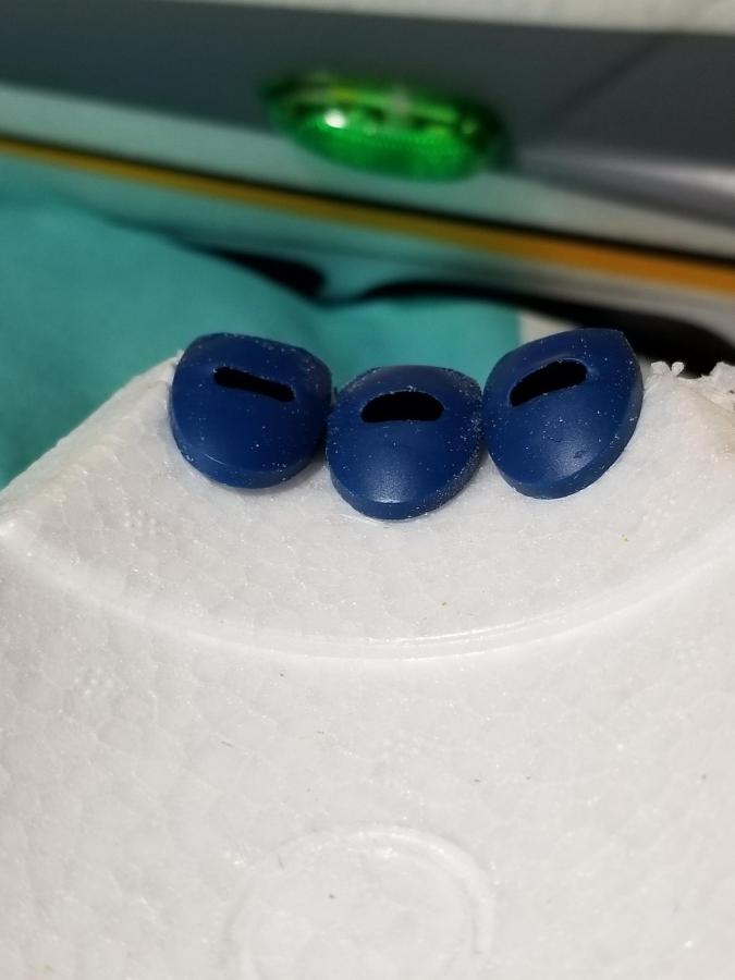

            Any chance of a shot of your whistles installed??? Inquiring minds like to see!
            photo courtesy of urrl posted over on RCG.
            Maybe use two instead of the three?????
              Yes two might be better. In fact I'm experimenting by taping over each whistle to see which gives the most pleasing sound to me. I might end up with only one.

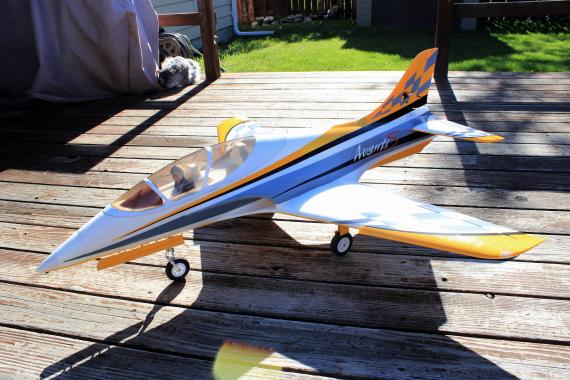

                #1067

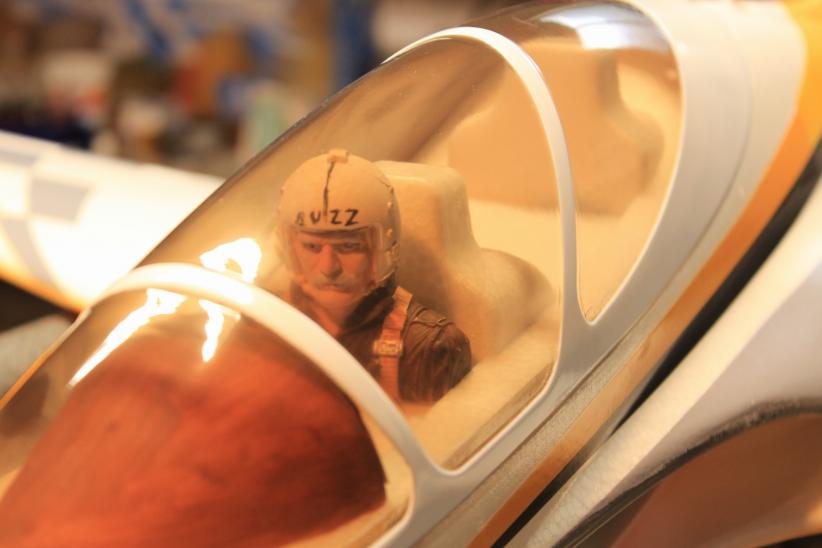

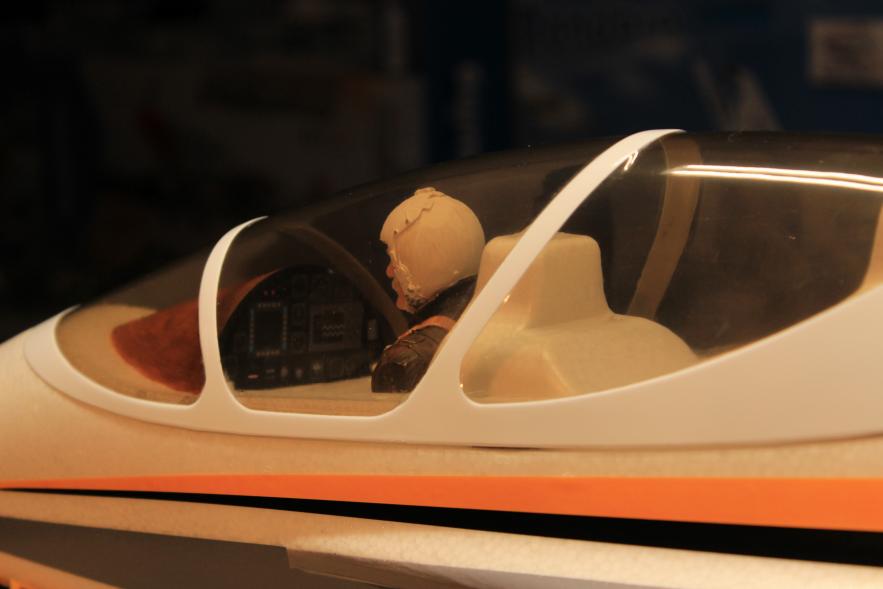

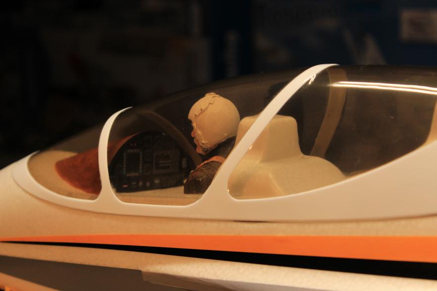

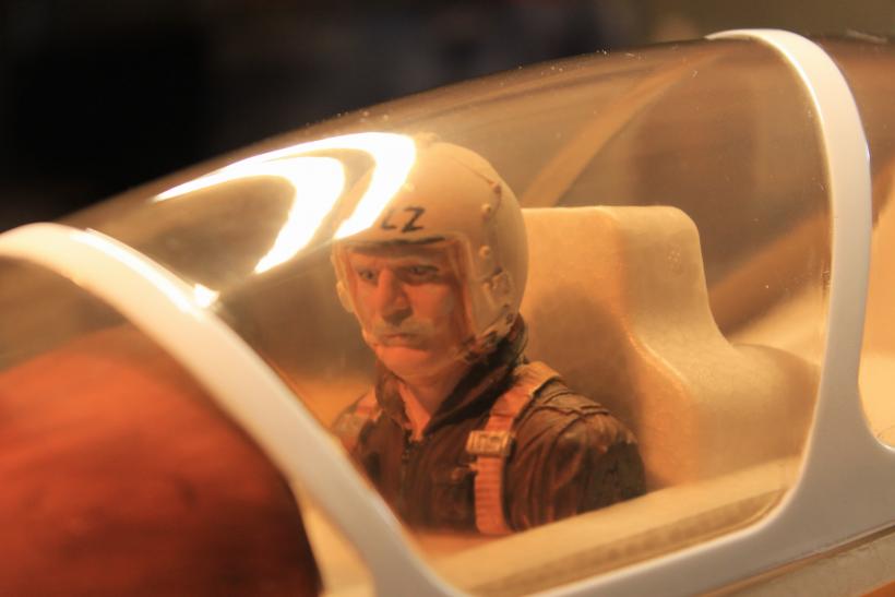

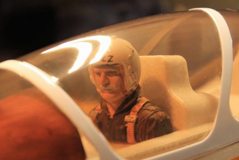

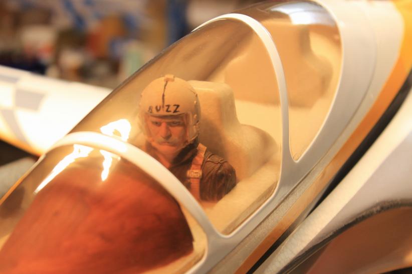

                Finally got mine together and have 'Buzz' the pilot in her. Painted my dashboard a light nutmeg brown, just to be able to tell it from all the other Avantis that will be at Nefi !
                HH, it looks like it needs just a touch of red, and I mean a touch as red is a very overpowering color ! Try it on some paper first before the airplane. You should be able to match it that way.
                Here's Buzz, and ex Airforce pilot in the cockpit of his new Avanti...

                Great job!

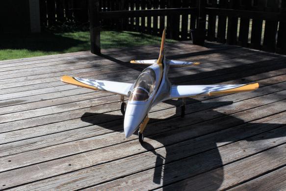

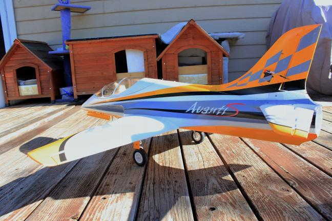

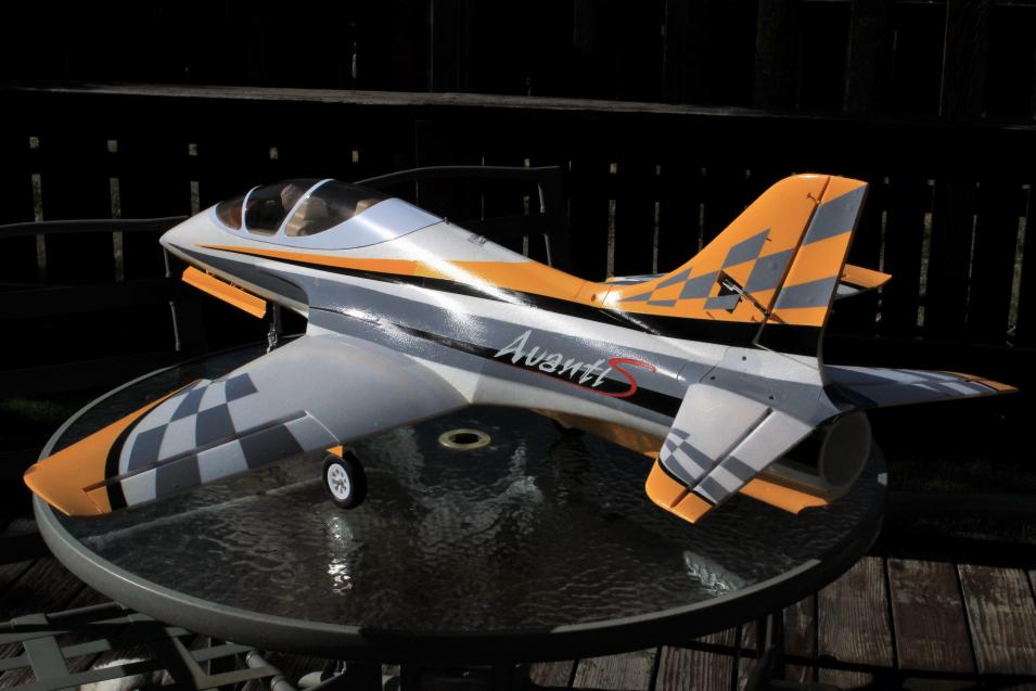

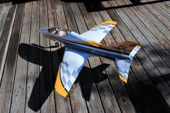

                        #1071

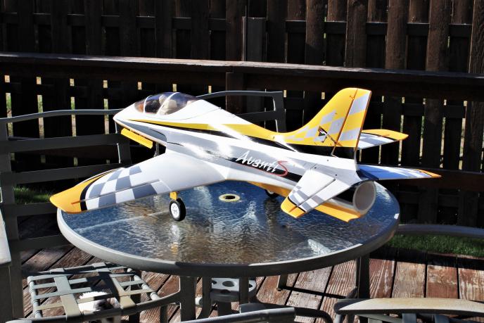

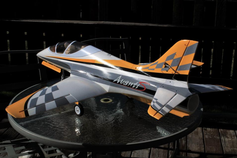

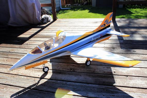

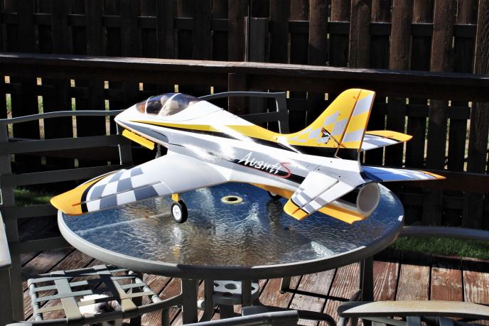

                        The only thing I've run across prior to a maiden, is one of the main gears wouldn't retract all the way, the tire would hit on the front edge of the wheel well and remain out in the wind. Had to finally trim away some of the wheel well to get it to retract fully:Angry:
                        Wasn't impressed with that and I wasn't about to rip into all the decals around the gear to see if it needed adjusting. It's in there solid. It looked more like the spring tension was too much and there isn't a way to adjust that.

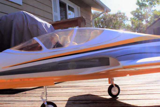

                        Meanwhile, I have three coats of Varathane in her and she's ready to rip. Anyone have flight times on a 4000s battery? I'm going with three on the first couple of flights to zero in on it, meanwhile, I ordered a telemetry module from HH (I'm sorry:(:()
                        So I can monitor the flight battery in real time.
                        So here she is.......

                        Grossman56 Click image for larger version

                          #1072

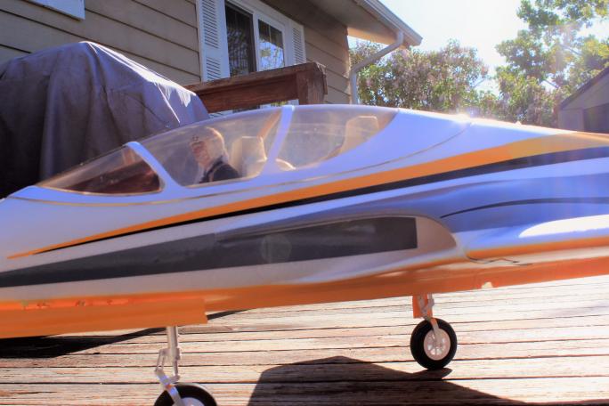

                          Nice variation Grossman56... 4000mah gets me 3 mins hard flying with around 3.75V per cell on landing.. No such thing as cruising for me..:).. If you're easy on the sticks you may wring 31/2 mins ..Good luck on your maiden though the Avanti is such an awesome Jet you'll settle into it after the 1st turn..;)
                            Click image for larger version  Name:	IMG_9788.JPG Views:	1 Size:	64.1 KB ID:	77811Click image for larger version  Name:	IMG_9790.JPG Views:	1 Size:	60.1 KB ID:	77812Click image for larger version  Name:	IMG_9794.JPG Views:	1 Size:	45.8 KB ID:	77813Click image for larger version  Name:	IMG_9795.JPG Views:	1 Size:	49.3 KB ID:	77814Click image for larger version  Name:	IMG_9796.JPG Views:	1 Size:	48.4 KB ID:	77815Click image for larger version  Name:	IMG_9797.JPG Views:	1 Size:	48.3 KB ID:	77816
                            Grossman56 Click image for larger version  Name:	IMG_9798.JPG Views:	1 Size:	55.2 KB ID:	77817
                            Looks awesome man! Good luck.
                            Yep, I have the same issue with one wheel hitting the wheel well by a good amount and it won't retract since the retract motor eventually stops it to keep from burning out. I'll have to look into it and see if I want to either trim the wheel well (which I don't want to do), or see if I can cut a coil off the trailing link spring and reconnect so it's a tad tighter and is slightly compressed rearward to clear the well.
                            Thats a suggestion for the factory upon assembly, test the functionality and fitment beforeeeeeeeeee it gets the QC stamp and packed. LOL

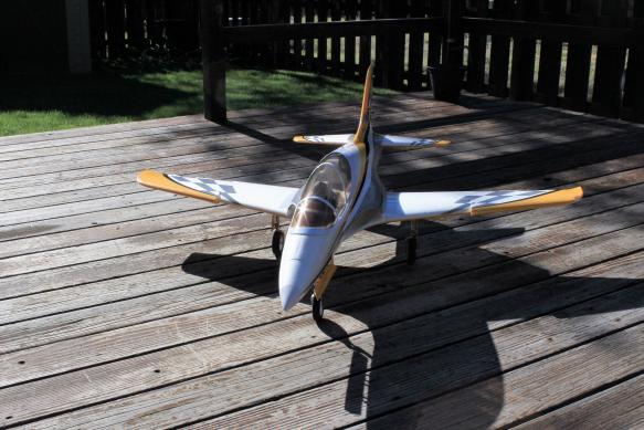

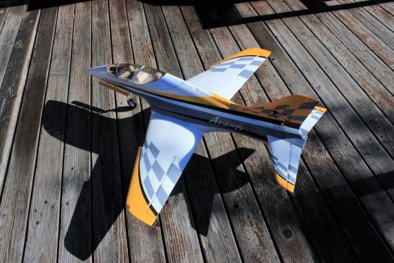

                                        • HellHathNoFury
                                          • 247
                                          #1080
                                          Hey Aros..Where's that Black canopy?? Your letting the Black canopy brigade down..;):)
