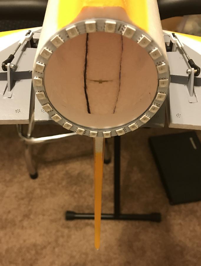

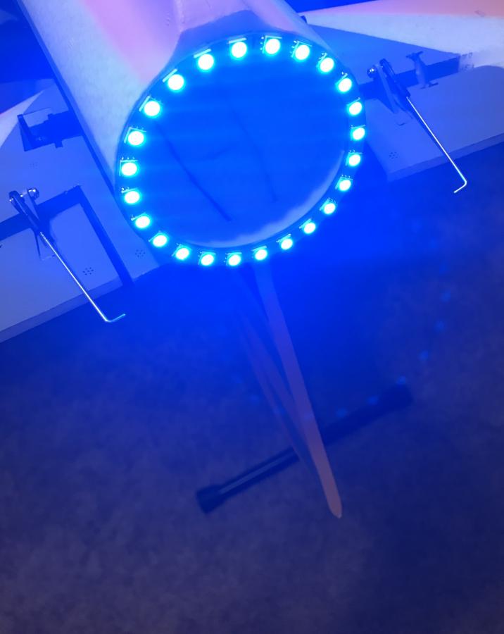

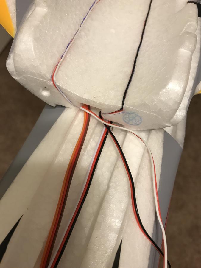

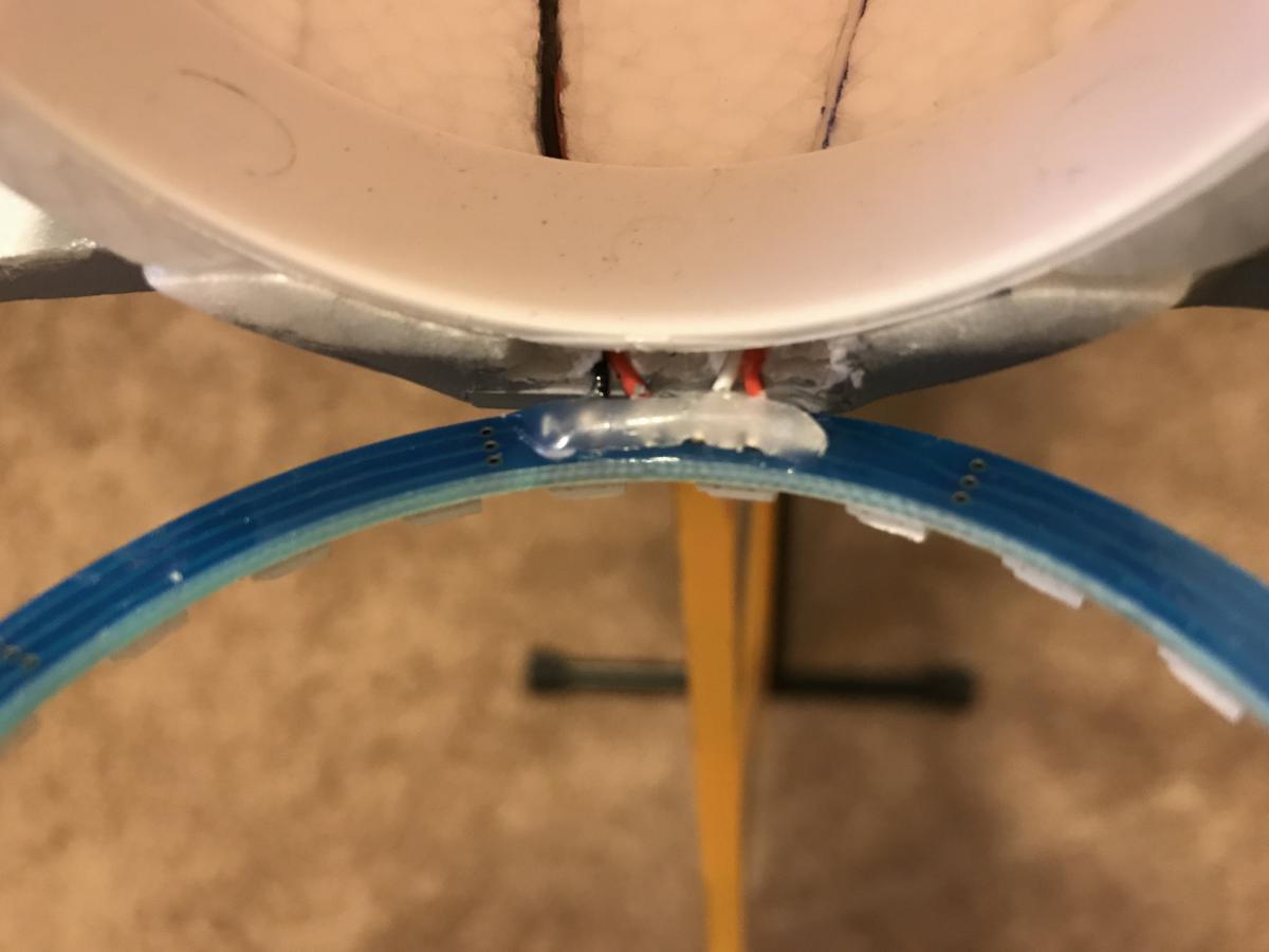

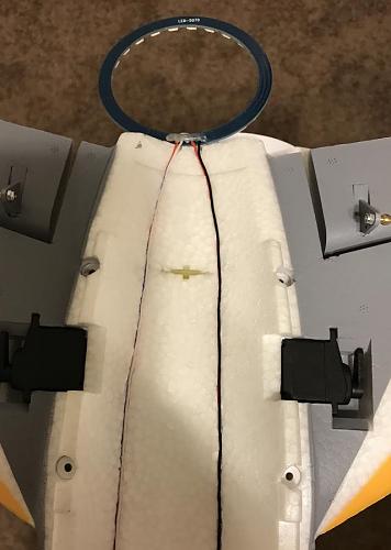

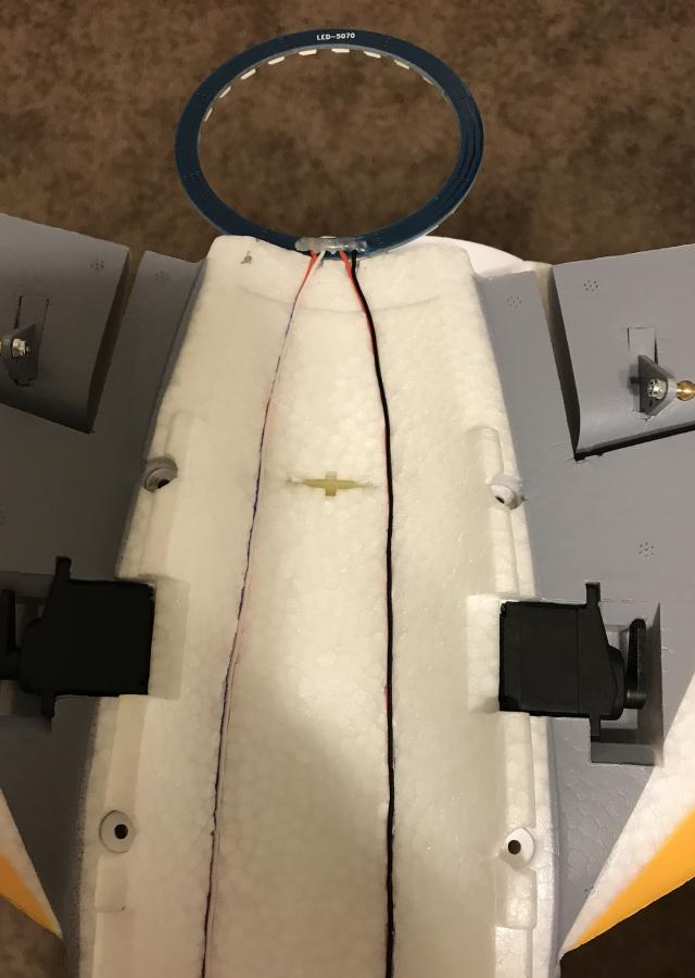

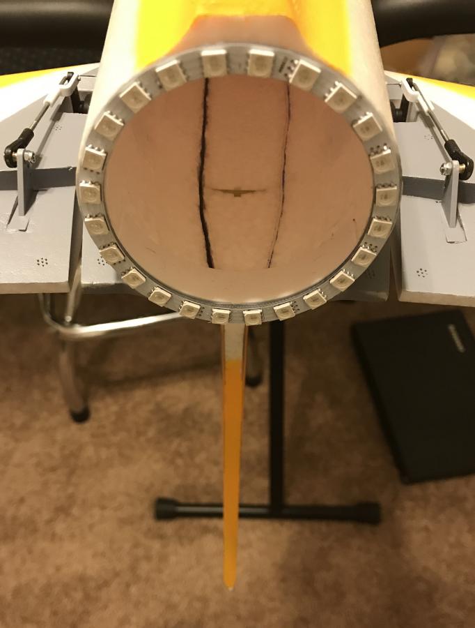

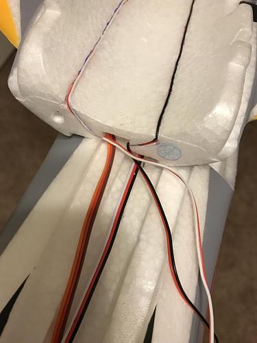

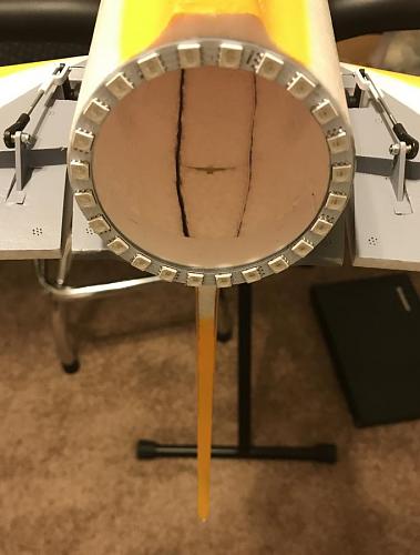

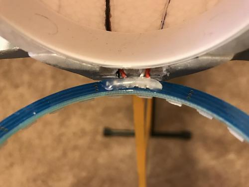

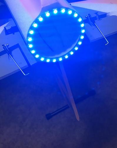

                I also got some more flights in along with the plethora of Avanti owners on this awesome thread and at the field. I'm now at 15 total flights this weekend, and looking forward to more.
                This plane is a blast to fly and really enjoying the small mods I made to it. The blue canopy continues to look better and better to me, the new power system is full beast mode in this jet (Jetfan that is still on 6S, which I prefer on a sport jet of this size), the landing gear is fantastic with these nice trailing links, it handled 15mph winds today fine with higher gusts, tracks like an arrow, glides incredibly well power off with those nice big wings, the lights look great and can be seen in daylight, and the RCLander three color 70mm Afterburner ring I installed shows up great in daylight and is a PERFECT fit for this tailpipe diameter.
                In the pics below, you can see the channel the size of the wiring that I cutout below with a hobby knife (plane is inverted in the picture so the wires look to be on the bottom but they are actually on top since that's where the horizontal stabilizer attaches), and the rest of the wiring can run through the already made large channel where the vertical stabilizer attaches. I glued the wires in the channel of the horizontal stabilizer, but you can also use tape to cover them, or lightweight spackle, etc. to smooth out the airflow. Also, I cut out a small little relief hole for where the wires on the AB ring are soldered and glued to it. After the relief is cut, it's pretty flush with the tail, and then the ring is secured with Foam Tac glue. Easy peezy install. The wires are long, so I was able to run the rest under the battery tray and put the AB controller board under the tray as well. Be VERY careful when plugging in each dedicated connector to the AB board, as one is labelled for the Red and White wires, and the other is for the Black and Red wire, so be sure those are plugged in their respective slots, not accidentally switched.
                For a cheap and awesome mod, you can't go wrong. People at the field were commenting on it today and how great they looked, and they thought it came with the PNP jet, ha-ha.

                  Nicely done!

                      Nicely done!
                      Thanks! It's inexpensive, works well (so far), and makes a fun visual impact. I can't ask for more than that. This plane is already amazing for lots of reasons, so these little things were a bit of the icing on the cake.

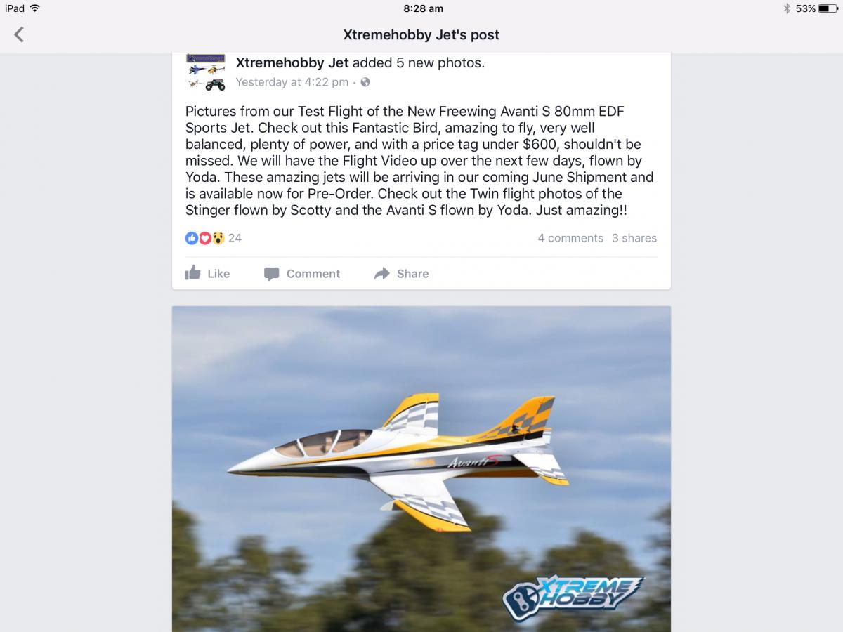

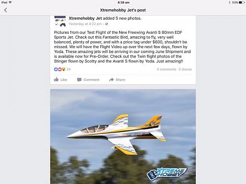

                          check out numbnuts post on the avanti - $600!!! PLUS at least $100 freight. (Jesus this bloke sure knows how to add a profit margin...) anyone still wondering why us Aussies have to buy overseas?

                                  what is the light ring system you installed and where can i get it
                                    Below are a few places you can buy the Afterburner lighting system. Some of USA based, while others are not.
                                    https://hobbyking.com/en_us/dr-madth...-70mm-edf.html
                                    http://shop.rc-electric-jets.com/RC-...TCLED-1A70.htm
                                    http://www.rc-castle.com/index.php?r...70mm+afterburn
                                    https://www.turbines-rc.com/en/after...-70mm-edf.html
                                    http://parkrcmodels.com/product_info...oducts_id=1674
                                    Here is a video made by the manufacturer, RCLander:
