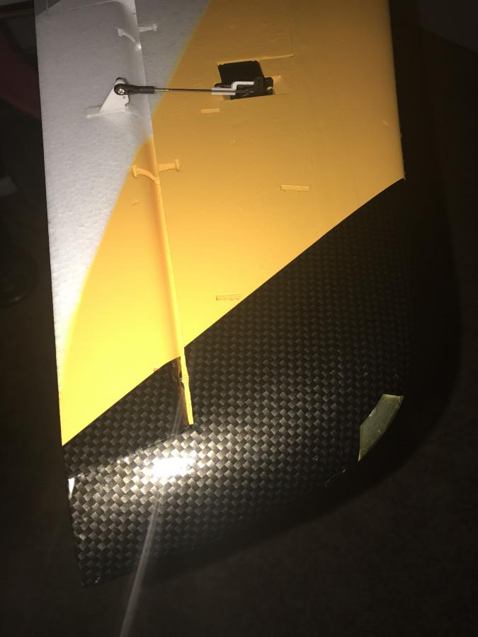

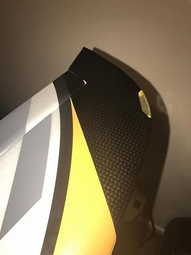

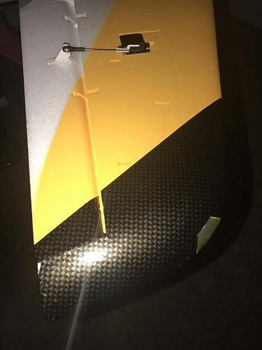

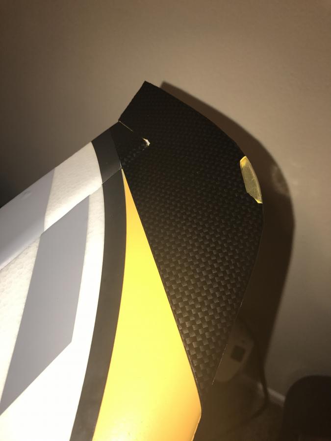

                        I got 10 phenomenal flights in with this aircraft on Saturday, and had a blast. I had so much fun until I was packing up, and I put the plane on the stand quickly to put the gear up for transportation home. As I put the retracts up, I had a club member behind me ask for help with a troublesome ESC on his scratch built plane (who is used to non-electric powered aircraft), and as I turn around to take my eye off my plane on the stand a gust of wind picks the plane up and smashes it into the ground several feet away :Scared:. It happened so quickly is was almost comical (but of course totally frustrating to see my plane crunched). So, I had to order a new vertical stabalizer, canopy, and some other parts. The wings are also scrunched, but I covered them in vinyl on the ends to take away the ugliness. So, the plane will be ready to take the skies with some new parts. Lesson learned, do exactly as I normally do and never take my eye off the plane on the stand, and pack everything up in the car, THEN go back and help :Cool:. That wind got the best of me, and is very "sneaky-sneaky".
                        Here is what I covered the wing tips with to hide the grossness worth of damage (still need to trim and smooth some more, but close) :
                        Click image for larger version  Name:	IMG_1146.JPG Views:	1 Size:	45.4 KB ID:	79518Click image for larger version  Name:	IMG_1144.JPG Views:	1 Size:	36.2 KB ID:	79517

                          Ah bummer man! Don't you hate when that kind of stuff happens?
                          For a positive, that faux CF vinyl looks sweet! Where did you get that and we should carry it!

                            Thanks! I completely agree that Motion should carry it. I looked for the product first on Motions website, but it wasn't there so I had to look elsewhere. It's made by Hangar-9, and is there Peel and Stick line called UltraTrim (for the carbon fiber roll, it's ITEM #: HANU91000). They come in 3-3/8"x78" small rolls. It's perfect for trim pieces and accenting not only because if it's size, but because it is peel and stick, and therefore requires no heat to activate the adhesive, which is ideal for our foam planes. Hangar-9 has all sorts of colors, and some carbon fiber patterns. Some other vinyl manufacturers carry Peel and Stick versions of their vinyl covering material/products, but some are more like stickers and don't conform well to edges and rounded surfaces. The UltraTrim is very thin (and comforms a bit better than all the others I've tried). Being extra thin helps with weight and conformity, but the downside is it doesn't hide imperfections underneath nearly as well and the other thicker materials. However, it's still much better and worthwhile over the other covering products I've tried. Just my opinion though, and that's worth....maybe nothing. LOL
                            http://www.hangar-9.com/Products/Def...odID=HANU91000

                                Thanks Grossman! It thankfully adds a bit of a unique look, and helps hide the visible damage that was an eyesore. Once I get the new canopy on, and vertical stabilizer, it will be looking almost as good as new.

                                  Sorry to hear it mate. But nice fix, looks good. A mate of mine did the same to his hsd turbine viper that caught fire, you'd hardly notice it was burnt with the carbon-look covering. I'm constantly reminding people in my pits to put their planes on the ground after tinkering, seen way to many get blown off tables etc. we get a lot of windwillies as well as gusty winds, so gotta keep a close eye on them when they are on the tables. Grossman I'm using a zippy compact 5000's, I have mine lined up with the rear of the tray. I haven't tried the graphenes yet, but I'm assuming with the extra 110 grams of the graphenes I'll need to put it a bit over the back of the tray.

                                      That's for sure. It happens in the blink of an eye. What a pain! Thankfully it does cover the damage rather well, and the people at the field that would notice it would just think I did a bad job covering it since the wrinkles in the foam are still visible through the film, just not as apparent. It's good enough though, and not worth buying new wings for.
