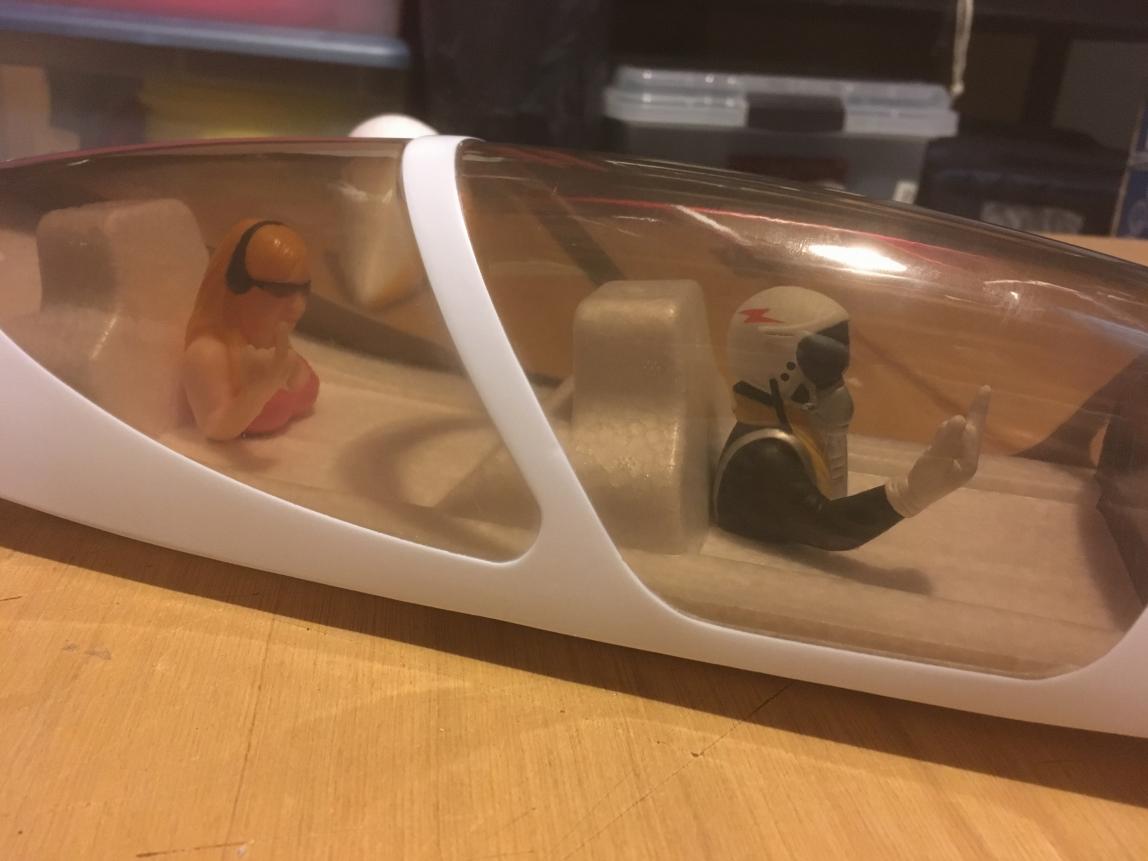

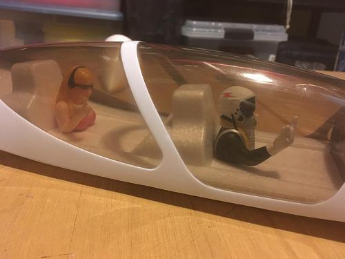

        I'm sure these guys are unique ...................................

          Lol, I like his style though. Who doesn't want a hot blonde in the back seat??? ;)

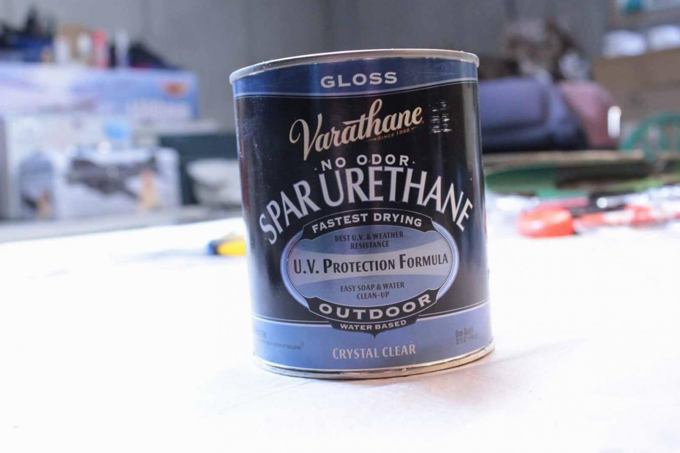

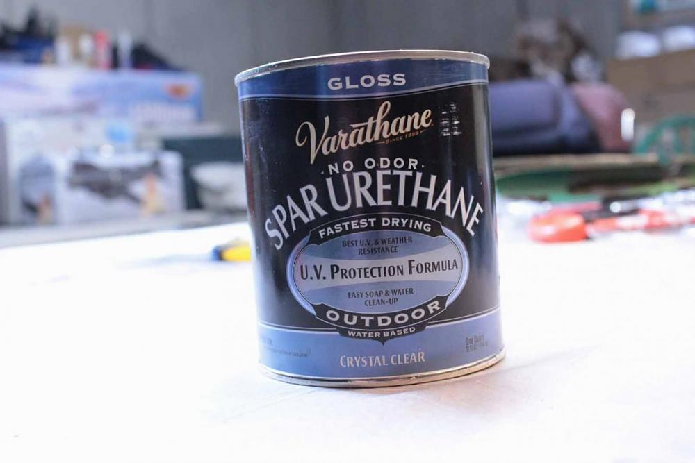

                                      I have three coats of Varathane on mine and several other planes.
                                      As stated numerous times,
                                      Click image for larger version  Name:	IMG_6863.jpg Views:	4 Size:	82.7 KB ID:	78963
                                      This is what I've been using, basically because it has Some UV protectant in it and I prefer it over Minwax, I've used both btw and both work very well. I've heard of guys saying that the Minwax will yellow over time, but I have a couple of planes that are three years old and show no signs yet.
                                      Just don't leave them in the sun and you should be fine, especially if they're a dark colored plane.

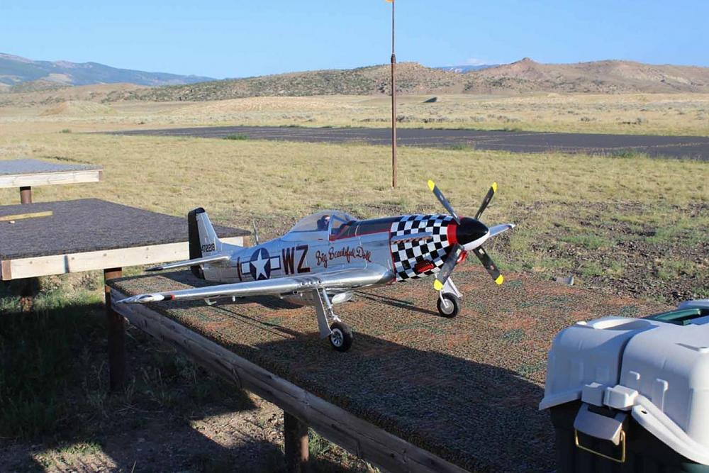

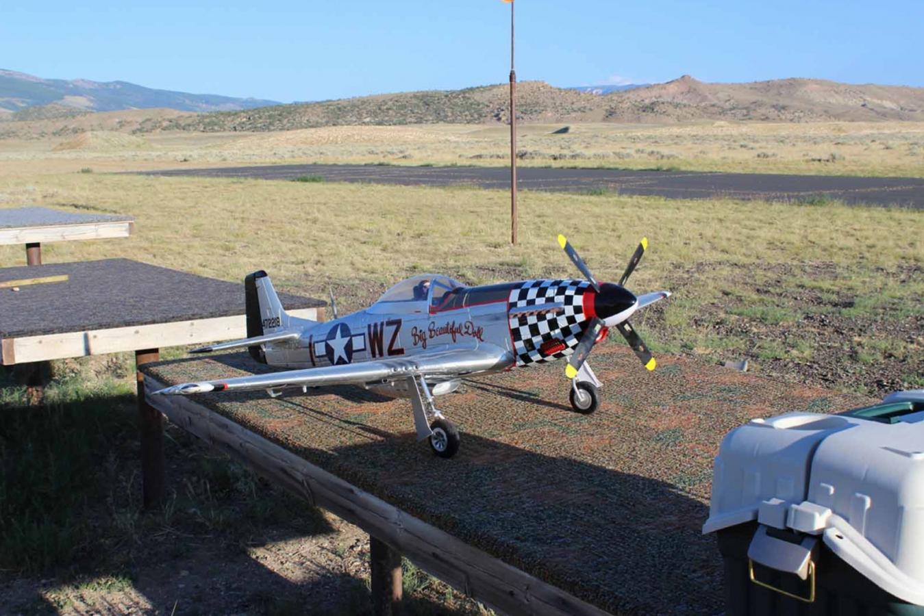

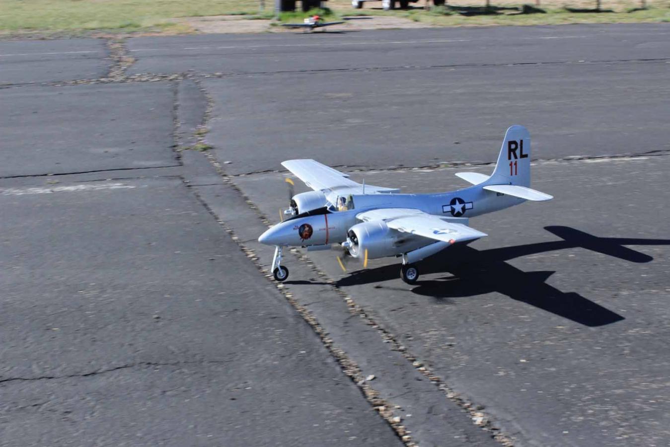

                                      Click image for larger version  Name:	IMG_4116.jpg Views:	1 Size:	167.9 KB ID:	78964
                                      Minwax after two years

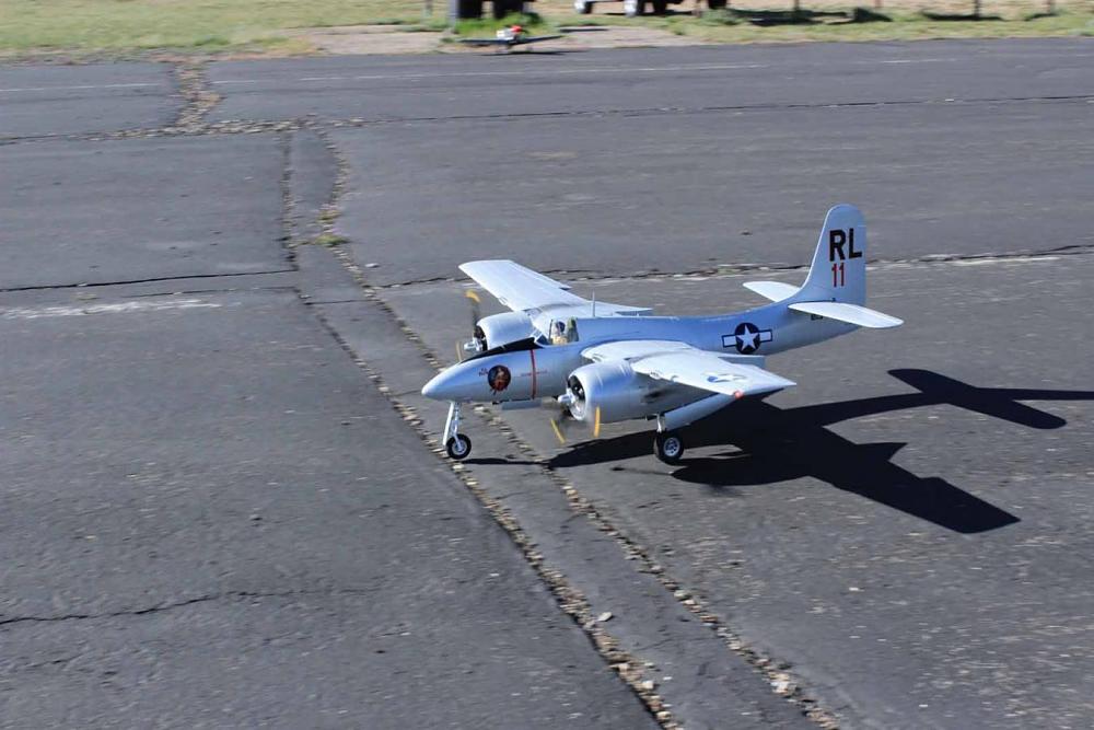

                                      Click image for larger version  Name:	IMG_9779.JPG Views:	3 Size:	120.3 KB ID:	78965
                                      Brand new with Varathane.
                                      Up to you.

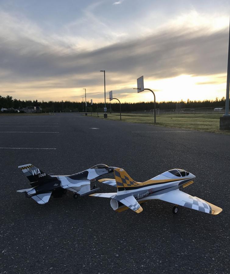

                                          Just got back from some nice sunset sorties. This bird and my FW 70mm V2 F-16 are my two favorite jet girls...But the advantage goes to the Avanti just for being so dang sweet and smoooooooth!
