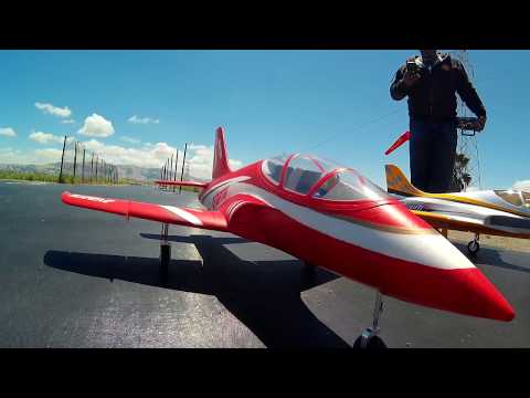

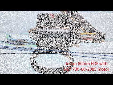

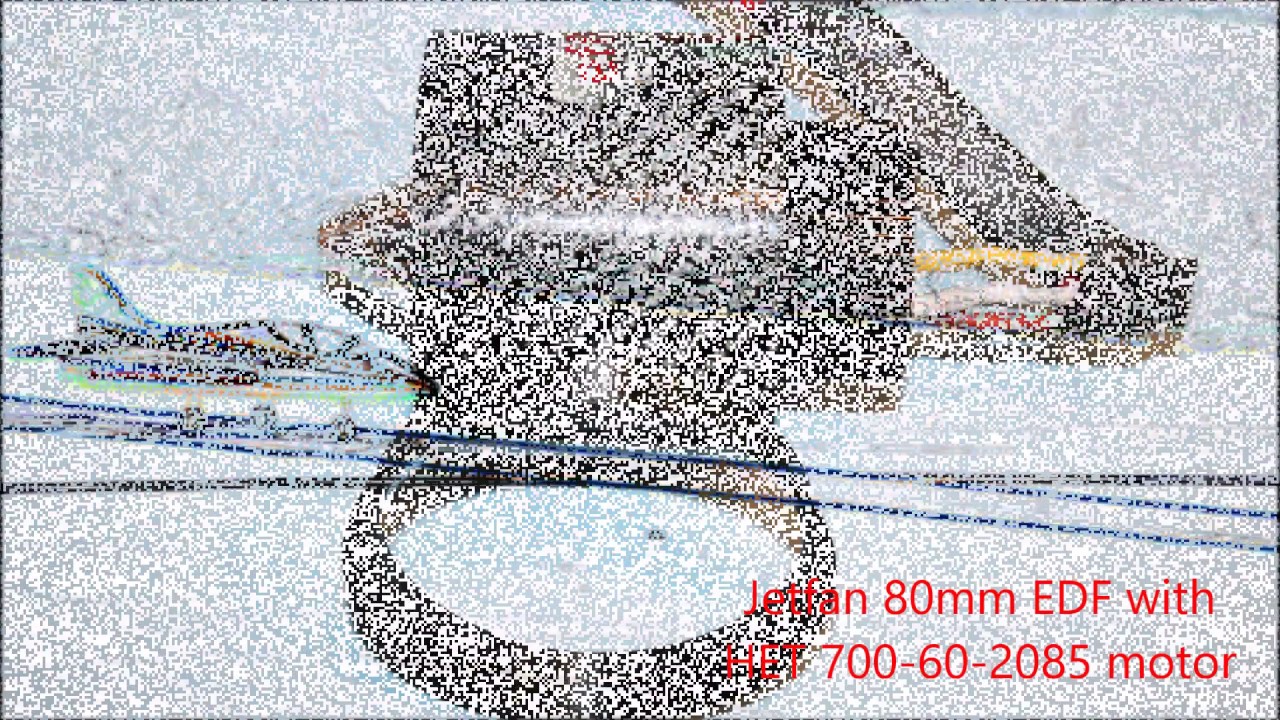

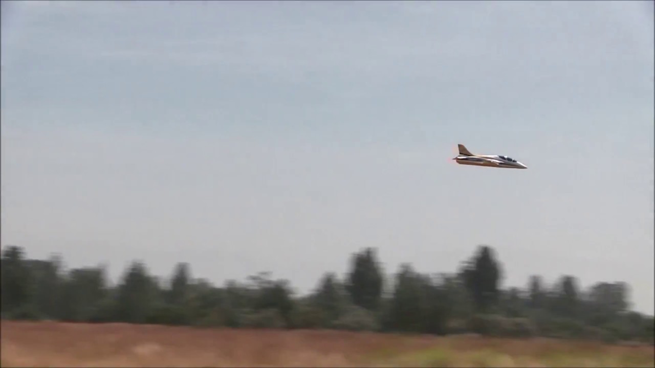

My #1 Avanti (there will be two) has the HET 700-60-2085 motor. After the 3 1/2 min maiden flight, the Revolectric, 60C, 4400's came down with 47% remaining. During some speed runs with T-cat's Avanti (700-68-2100 motor) we recorded 110mph averaged upwind / downwind speed. This is about 10-15 mph faster than reports 95-100 of the stock setup. I will radar the stock set up myself, when I have the opportunity.
The videos are T-CAT giving mine a good workout, and his, doing the RADAR runs, (Radar gun is a calibrated Prospeed CR-1K). For those who want a super efficient set up. With about the same power as stock, but with an even longer flight time, I'd suggest the very light lower kv, 650-58-1970 motor. This would the best (IMO) for great aerobatics and the longest flight time. Aerobatics are the forte of the Avanti air frames.It won't compare to a Habu 32 composite, but for those who have the need for speed, I suggest the HET 700-60-1738 motor on 8s, or the "hot" (high amp) HET 700-60-1865. Speeds should be close to 140mph. My #2 Avanti will most likely have that setup. There are already some 1738 and 1865 set up in the works by customer's and theirs will probably be flying before mine.
Please shoot me an email for additional information. effluxrc@gmail.com
This is a great flying jet! Sorry for the noise in one of the videos. It was a busy day at the basin.
thx, Gary

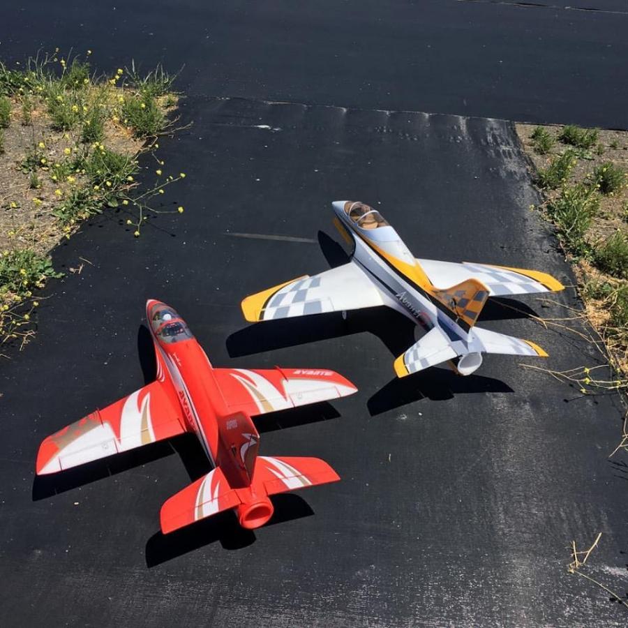

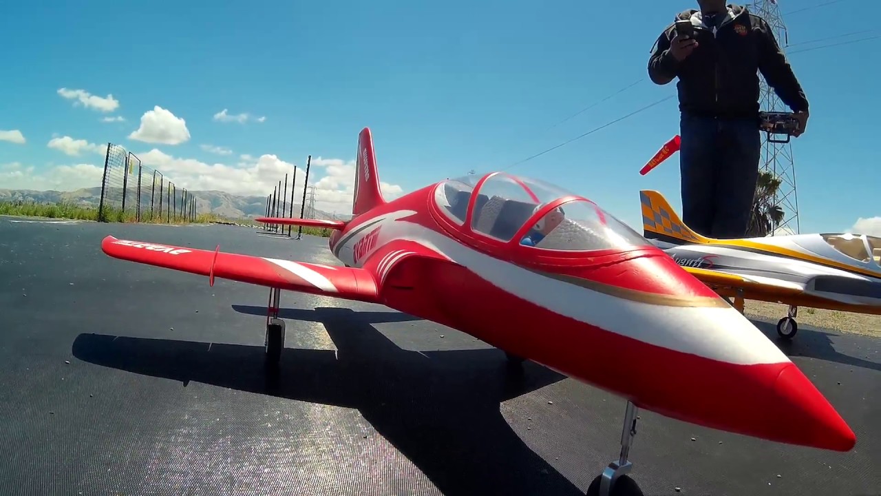

I wish we could have done more aerobatics instead of general flying with yours. We still had some room, but more people kept taking to the skies and some of the large 3D gassers were up at times doing hovering near the runway centerline. We had to constantly watch extra carefully to ensure enough separation. We'll eventually find a more open day at the field. It was a zoo that day. LOL. The gasser noise ruined the fun EDF sound we love. Bummerrrrrr. Thanks again for letting me fly your jet. It was great seeing you and everybody at the field.
It's a great flying jet and the Jetfan on 6S does a nice job adding some thrust and speed, while still remaining relatively light and agile. The power system is a bit heavier, so that allows a bit more capacity battery to be used and still CG with no issues. I did add another battery strap to the front though for extra assurance.Comment

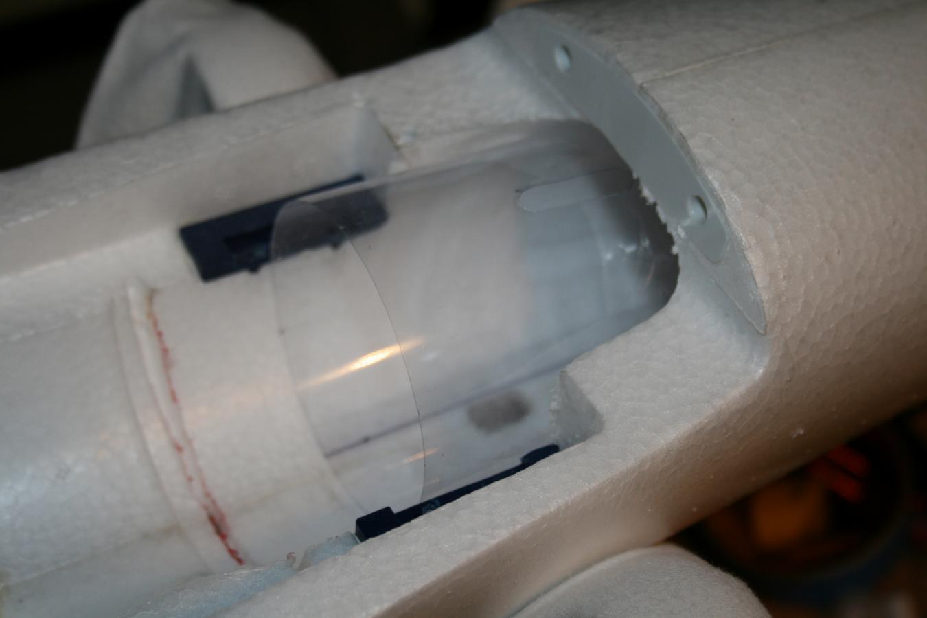

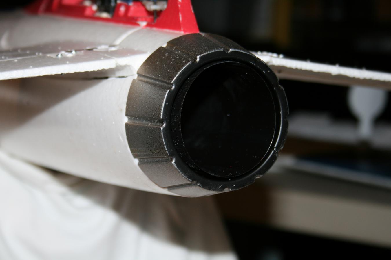

For my 8s version, I have some old Revo 4s, 60C, 5000's, that were for my 8s Jetfan powered Freewing F-16. Those (at 4.20V) will be plenty enough power for the 8s, 1865 set up. It's going to be pretty hot with custom trust tube in it. Keep in mind the we are flying these setups with an outlet dia designed for the 12 blade freewing fan. The Avanti S outlet is 2.76" !! That's way bigger than the outlet of a stock HAbu 32. and is WAAAY more than 100%FSA of the Jetfan 80. I built, flew and videod miy 6s set up with the stock outlet, since most guys don't want to hassle making and fitting a custom thrust tube with reduced FSA.
My 8s version will have a custom tube. Squeeze that puppy (with a Jetfan EDF) down to 80-85%, and get some efflux velocity. :-)Comment
Bingo. If I were going for all out speed, a thrust tube is a must. The stock outlet diameter does great for the stock fan unit, but the Jetfan needs much less. The thrust tube install looks like it would take some shaving of foam around the rear area of the EDF shroud to provide enough clearance for the tube. I'm looking forward to seeing your install.
