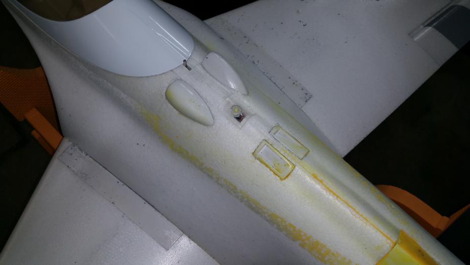

        Mine is going to some modifications in a repaint so it'll be awhile before I can get it in the air Click image for larger version

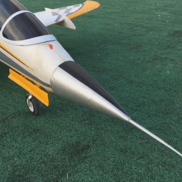

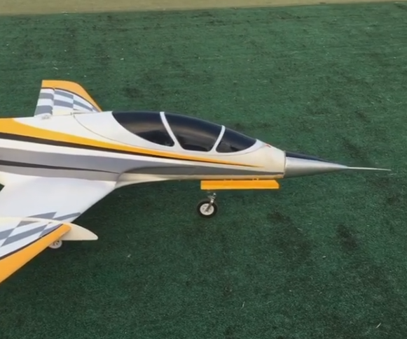

                    ok guys here is something really funny....When you leave the nose for your Freewing Avanti at home and have a good friend give you his spare 90mm F-104 nose.... this happens...
                      https://www.instagram.com/p/BWY--cOh...n-by=gooniac33
                      So, all the slots and magnets are the same? Amazing. Painted up, you would think it was born with it.
                          not quite. We put a couple dabs of hot glue to keep it in place. but the magnets could easily be changed! it can also be sanded or molded to fit the plane as well...

                            #1473
                            Too bad. Was hoping it was a direct fit with same shape where it connects. Looks really good from a distance.
