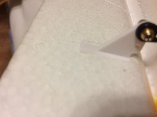

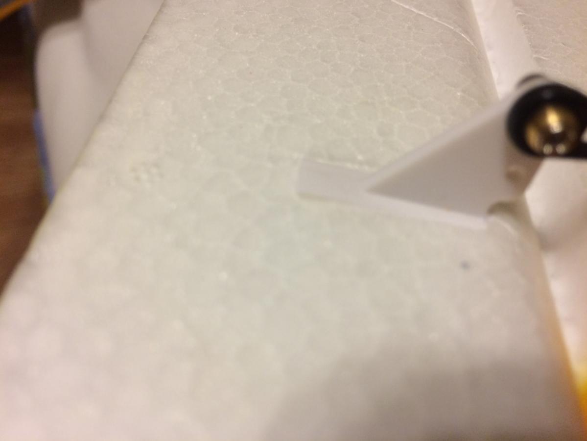

                                  After reading these recent posts, I thought I should take a close look at the aileron horns on my Avanti. I found one aileron horn has started to pull forward digging into the foam toward the leading edge and showing some play. It looks a lot like the photo of Tom's post crash aileron horn, although not yet to the point of failure. Coincidentally it is also the left wing. The photo doesn't show it well, but it looks like the foam is compressing under load and causing the rear tab of the horn to pull loose. i believe I need to remove the horn, fill in the dent and remount it level in a more secure way. By the way, I have not done snap rolls or extreme maneuvers with the Avanti. This should not be failing after 15 flights.
                                  John

                                  • When I received my plane, I gradually worked all my control horns out of their foam pockets, which can ruin the pocket a bit though, and reglued them back in with plentiful amounts. I'm not particularly easy on this jet and need it to withstand that, and so far so good. However, I'm always worried about it, so I check them every five flights or so with a little tug.
                                    • Originally posted by T-CAT View Post
                                      And there it is ;).........way too many pilots(myself included) get complacent about pre/post flight checks.
                                      These models require constant maintenance and mechanical integrity vigilance in a similar aspect as full size.
