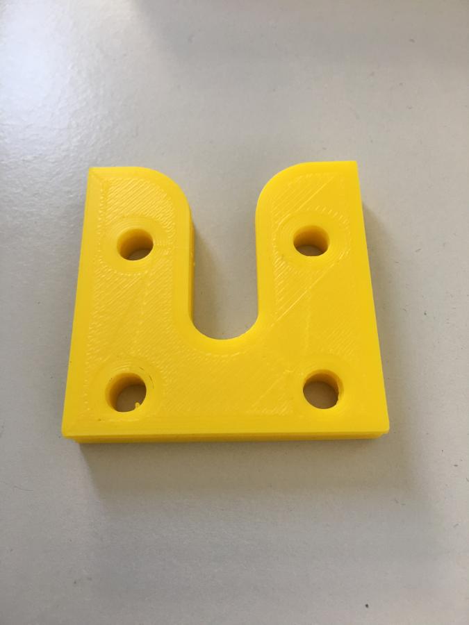

              Here is the .STL for the Nose gear brace/support for Freewing AvantiS :
              This is a part for the Nose gear brace/support for the Freewing AvantiS in ABS or PLA,30% filling, 0.2mm resolution, 5 layers everywhereIf your plane never flew yet print the +1mm,i used the -1mm because i had a crash and i bent the front gear,i could not repaired it as a new one.-1mm = 13mm from the gear to the back of the plate0mm = 14mm+1mm= 15mm+2mm= 16mmhttps://www.youtube.com/watch?v=I0F_y3McXKQ

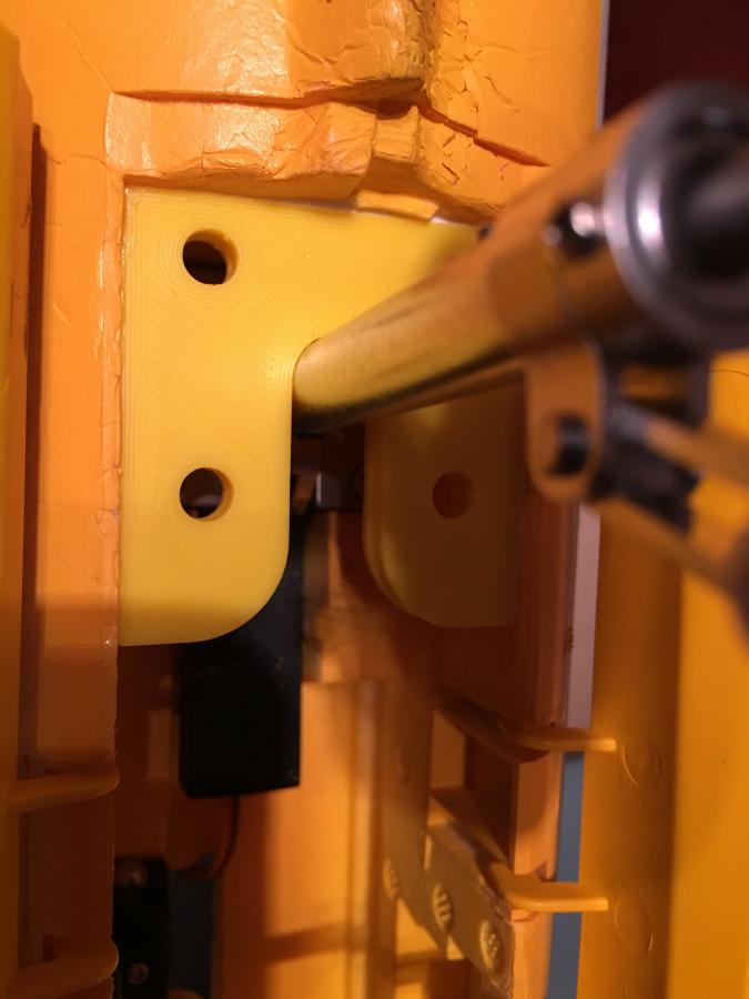

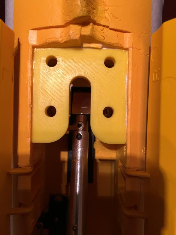

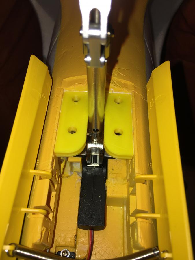

                            here are some pictures of my 3D part on the plane, I glued it with the glue that I used for the canopy ...
                            thanks to the people who think about this part before me, it was very helpful...
