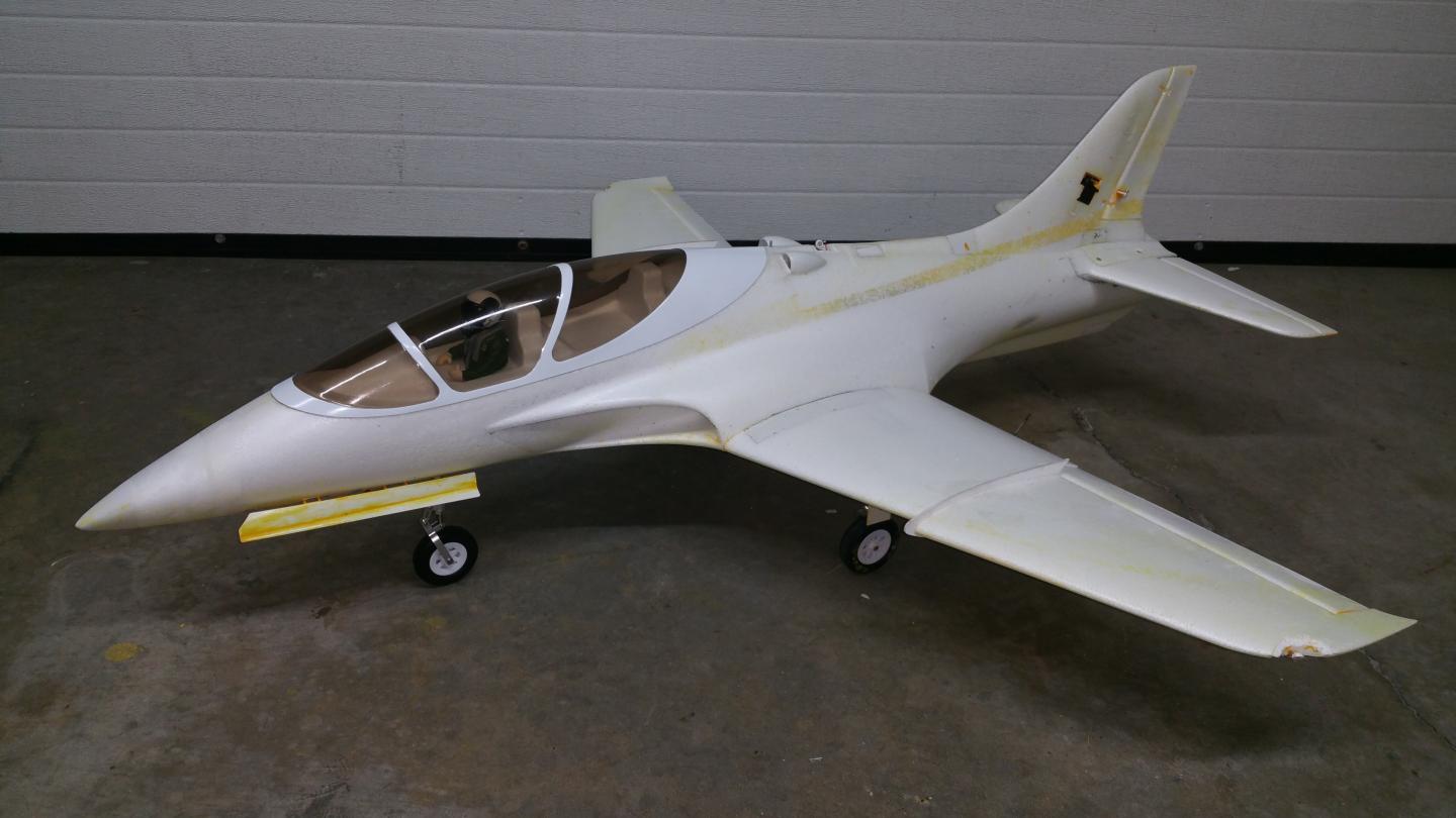

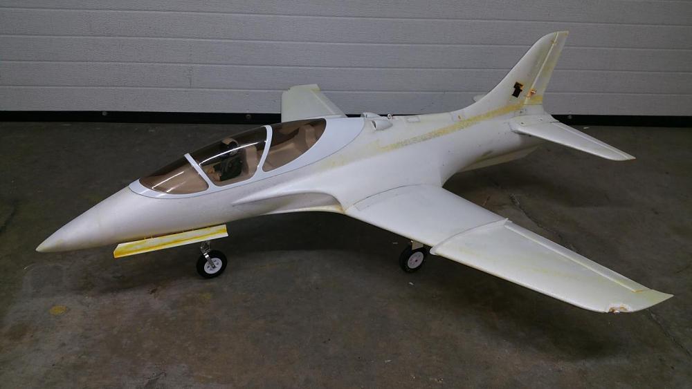

                              #1514
                              Now comes the sanding and painting. .... Click image for larger version
ID:	90434Click image for larger version
