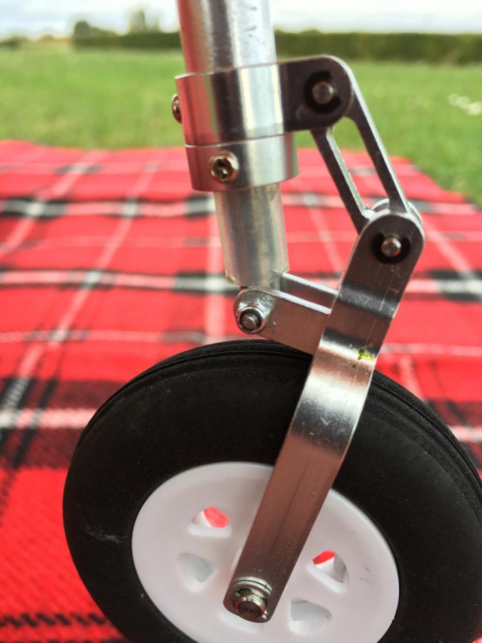

        Here is my last change on the front gear, I added a small piece of silicone tube, 6mm diameter on the axe, better if you are on grass ...

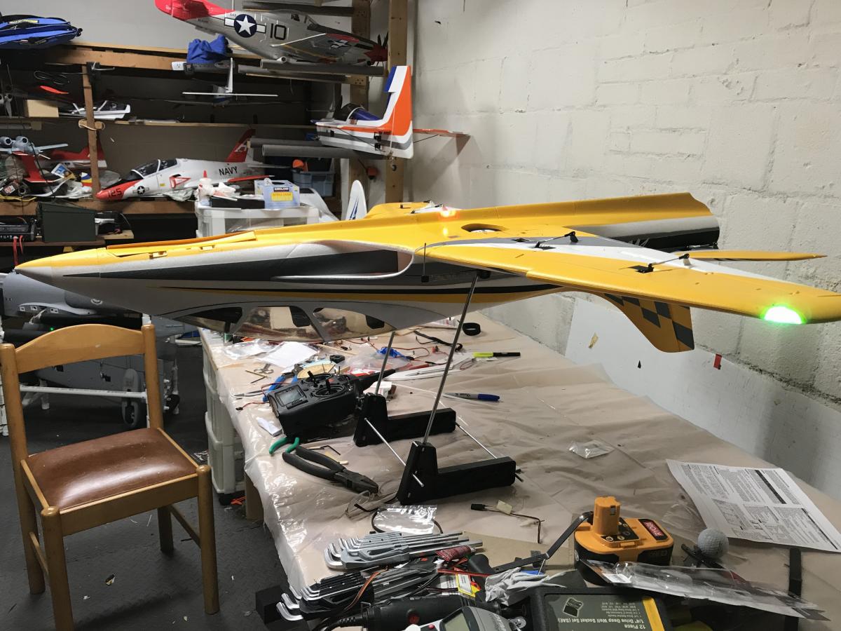

                          OK, finally should be able to fly this weekend. Long story, but no radio. I balanced my Avanti at about 106mm with the gear up. With the gear down of course, I get tail heavy. I was wondering what was most of the people here experience with changing CG and gear deployment? I have a few EDFs T-45 and A-10 and the small UMX A-10 so EDFs are not a problem. Plus I have a lot of experience with others

                            At 106mm, it will be quite nose heavy. Most of us are setting CG at 115-116mm with the gear down. That seems to be the sweet spot. At that point, gear position has almost no noticable effect. If you haven't done it already, be sure to tame the ailerons way down. Based on your current EDF line-up, this bird will feel comfortable very quickly. A real pleasure to fly. Good Luck on the maiden.

                              I will check it at about 115-116 with the gear down tomorrow night. But here it is at 106 with a ThunderPower 5000 6s in it and the wheels retracted. Pretty dead on. But with the gear extended, tail heavy. Will see what I get with 115 and gear down with the battery at the same location

                                OK, I don't like MotionRC anymore! They are going to make me spend more money on EDFs. I got two flights on my brand new AvantiS this morning before the wind game and I flew others that I brought. Let's just say one word.....WOW! This plane was incredible. Grass ops were a breeze. My T-45 sometime doesn't like the grass and the small front gear is a pain in the butt. But the Avanti was FAN-tastic. First flight was a short rollout of about 150 before she was airborne. I went to full throttle and before I knew it, I was easing back in the stick and she was up. About 5 clicks of right and 2 of up she was trimmed. CG is about 110 and she flew great. Only issue was stupidity on my part. On downwind leg I dropped flaps and she ballooned because I forgot to add in Elevator compensation and of course didn't try this at about 200 feet for the Oh-S#*T factor. Picked up my flaps and continued with my landing sequence. Turned to base then final and smooth landing. Floated a little bit but stable. Added 5% more expo on the second flight and it tamed her down a bit more.
                                Best plane I have seen in this class on grass. Grass ops wasn't an issue. She took off without issue. Used ThunderPower 70c 5000s in her. Will try a 45 and my Admiral 50c 5K next time. Overall, great looking plane and great flyer.
