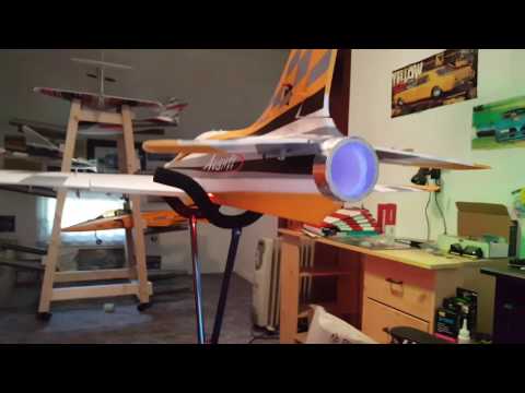

                            fabricated a led afterburner... :-)

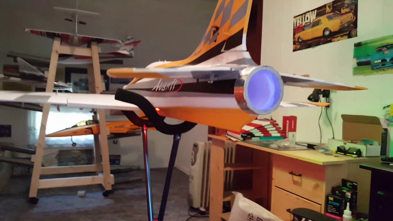

                                While we are showing our burners off, here are a few pictures of my burner mod.
                                Enjoy!
                                Cheers!!! and Blue skies to ya..........

                                  #1536
                                  Enjoy!
                                  nice! :Cool: what tail cone did you use?
                                  I cut a Viper 90mm cone in half, but it is just a hair to wide.

                                    #1537
                                    Enjoy!
                                    TopGun, which tailcone did you use for your mod?

                                      #1538
                                      Hey guys, Topgun here,
                                      The nozzle I used for my mod was the Freewing F-16C 90mm tail nozzle. It is on MotionRc site and it was $2.49. The SKU# is FJ306110917
                                      This is a large nozzle, but I took my time and cut it down till the LEDs on my afterburner ring just fit in the inside edge. Once I got it to fit
                                      flush with the back plate of the afterburner, I then tacked it down with hot glue. I position the afterburner on the jet with the wires in the
                                      12 o'clock position made a hole just big enough to feed them into the channel under the rudder. Rudder needs to be removed to do this.
                                      From there the wires were run up to the front of the battery compartment and connected to the afterburner controller. Replace the rudder and
                                      hot glued the afterburner in place after testing that all was working. I think it turned out pretty good.
                                      Hope this helps...
                                      Cheers!!! and Blue Skies to ya.........

                                        #1539
                                        Hey Topgun- nice job on your afterburner! Which afterburner did you use?

                                          #1540
                                          Hey fairplane,
                                          The afterburner that I am using came from eBay. Search this heading "RC Lander 3 Colour Led AfterBurn System For 70mm EDF Jet" and it will bring it to you.
                                          This burner comes from Hong Kong and I received it pretty quick. Shipping from HongKong is fast, I can NOT say that for orders from China. I don't buy anything
                                          from China because it takes way to long to get your order.
                                          This is a 70mm afterburner, the whole on the Avanti is 70mm, so this afterburner causes no restrictions of air flow (thrust) which is a big plus.
                                          I paid $24.75 and the shipping was free.
                                          Hope this helps..
