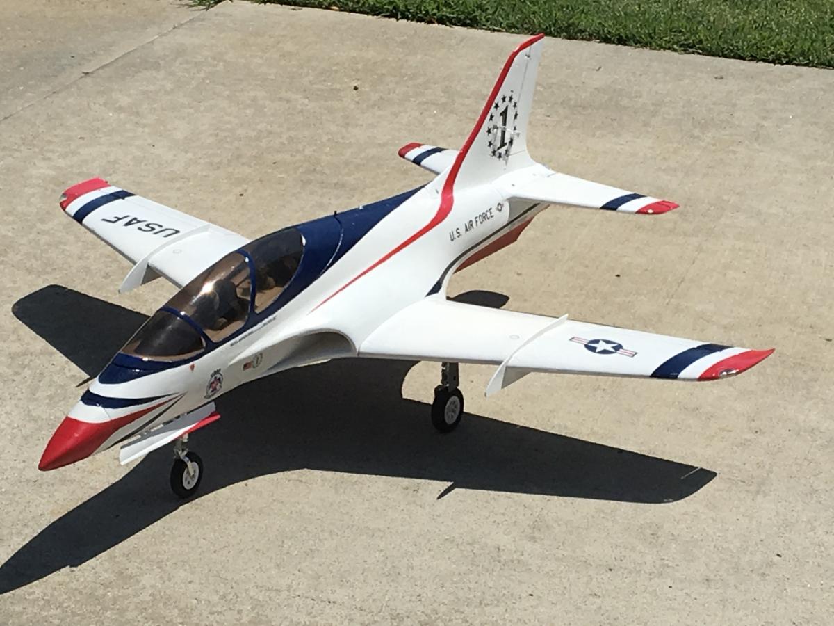

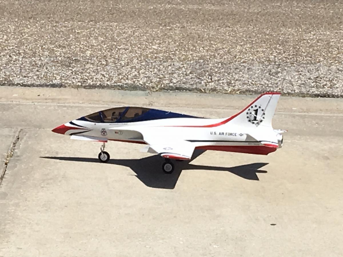

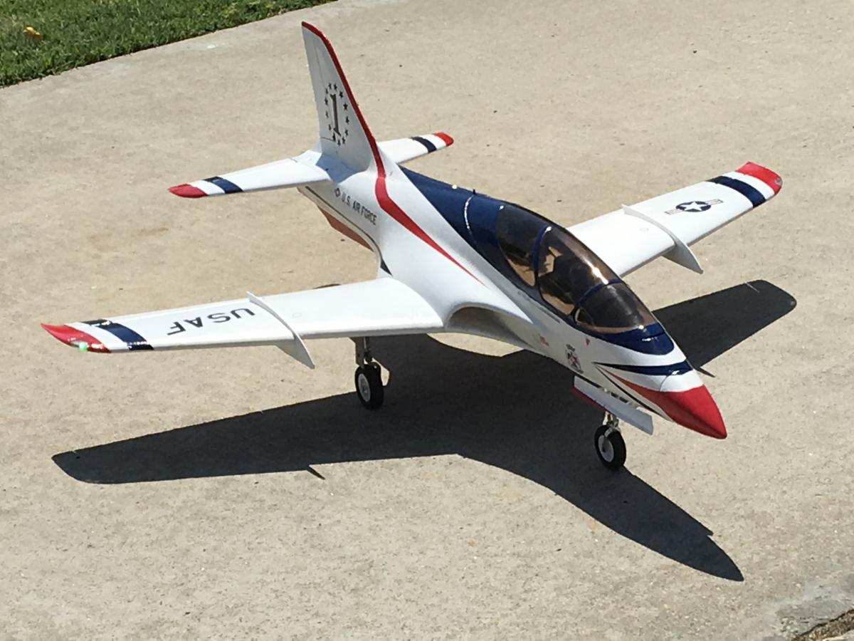

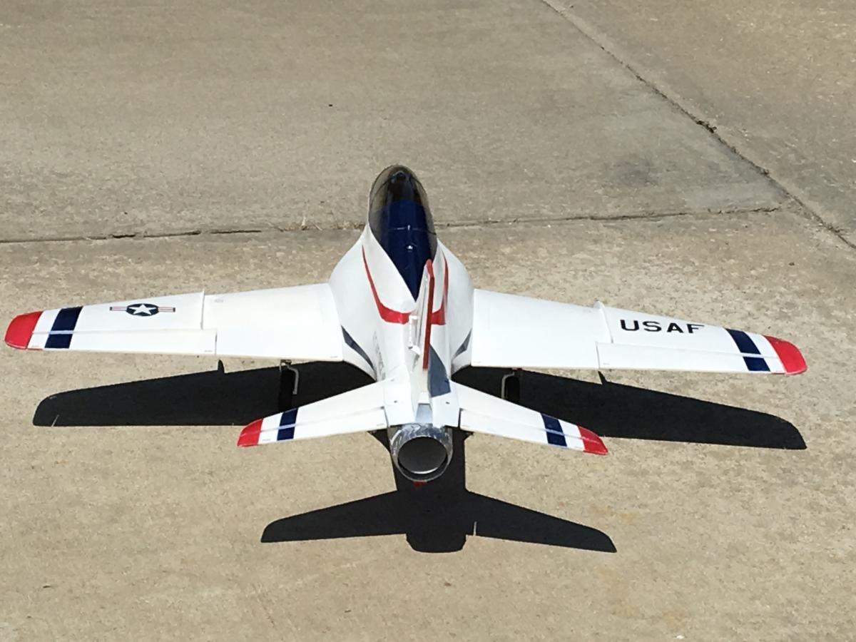

OUTSTANDING !Originally posted by Dapreacherman43 View PostJetman... I saw your video last weekend... it inspired this.
That is an awesome paint job, which will be a great color to see in the air. Very nicely done sir.
Good job and good luck with her.BVM Bandit, EFlite Carbon Z T-28, EFlite Carbon Z Cub, EFlite Promethus, FW Avanti S, FW A-10 ThunderBolt, FW P-51 Mustang, EFlite Convergance, EFlite Carbon Z Cessna 150, EFlite Habu, EFlite Styker Q-F27, HSD Navy Super Viper
