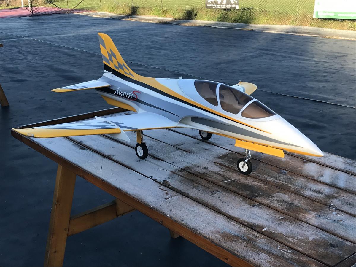

      Yikes there was frost on the tables at the field today. What an amazing plane to fly. The jet looked great in the clear blue sky.

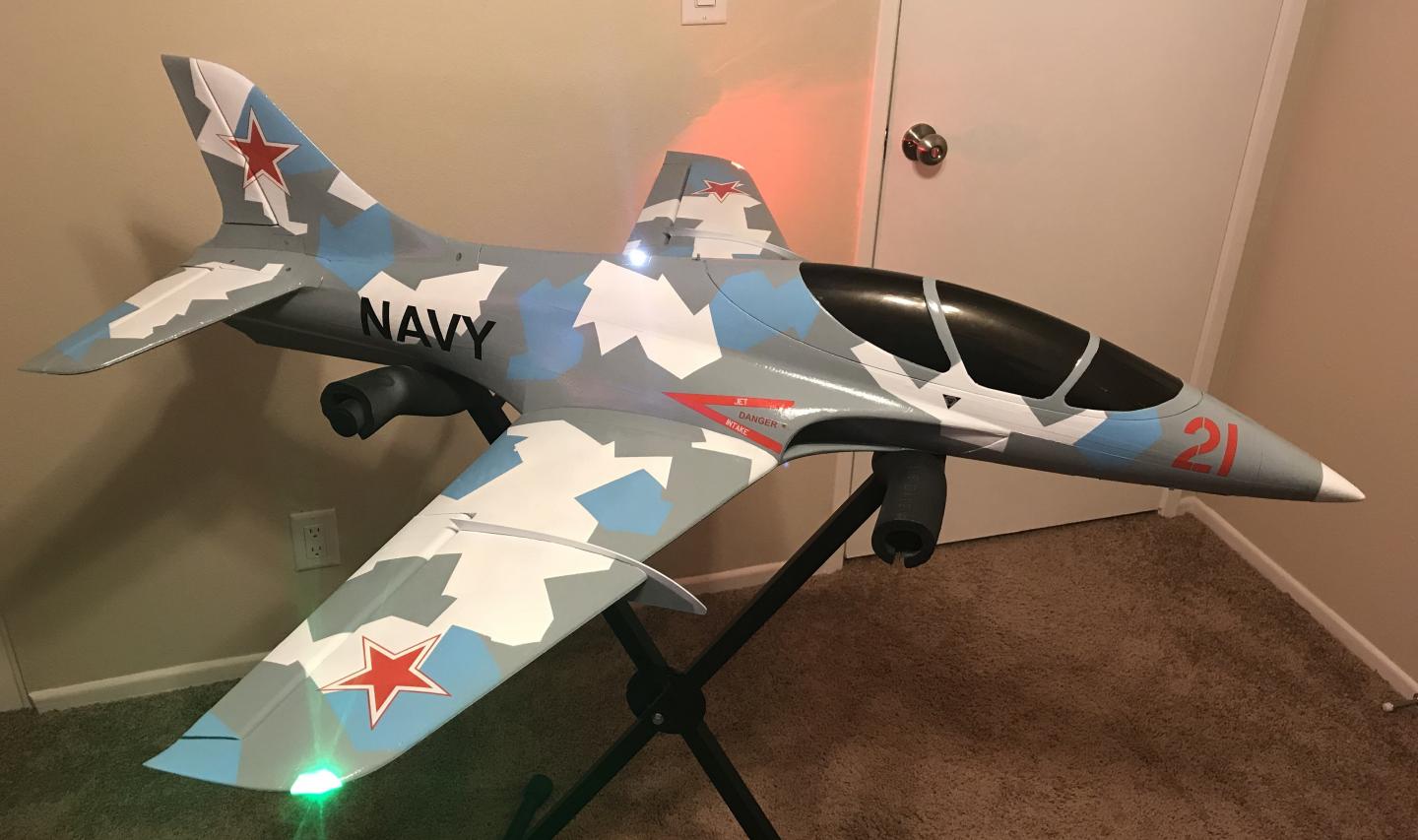

                                    I figured I’d give the Avanti a fresh look, even though I like the yellow paint scheme they chose. This plane is still one of my all time favorite “fly it how you want to” type of jets from Freewing. With decal sheets on hand from a bunch of different planes, I decided to go with a Top Gun Aggressor paint scheme in a Splinter type camo, but one that won’t be affected too badly by the sun and the “popcorn” effect. It was an overall quick paint job with no extensive prep. work, no sanding, and no decal removal, but it came out pretty decent and should show up nicely in the air.

                                      Very cool Tcat.
                                      So far I have only managed to glue my canopy, blendern tape my hinge lines and insert 2 minion pilot- ish figures. Gotta love free toys from MickeyD’s. I failed to take a pic but will this week when I’m done at work.

                                        LOL the Minion pilot idea is fantastic! Definitely take a picture of that :Cool:. That’s the fun part of sport jets when they don’t resemble a full sized aircraft, just put whatever you want in it and make it yours without any thought about “scale”. That’s a ton of fun.

                                          T-Cat I love your Avanti, well done!
